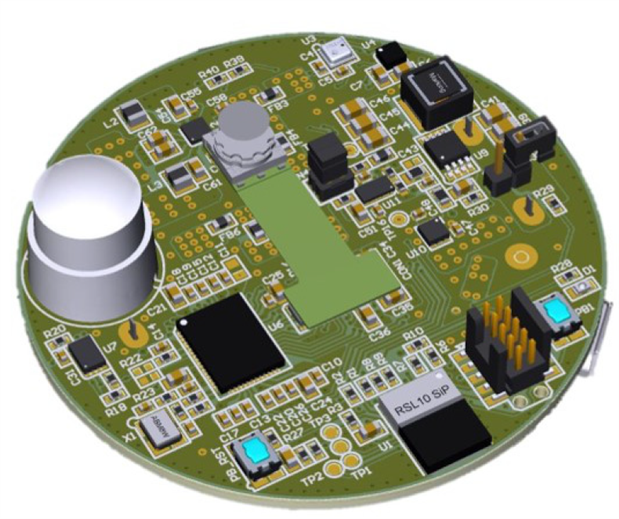

image source: RSL10 Smart Shot Color Camera user's manual

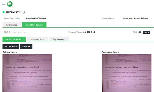

image: gui after I requested an image
image: data arriving

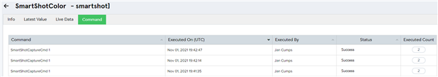

image: the command sent from cloud to gateway
