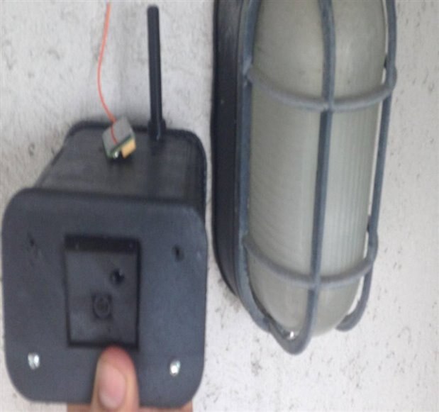

  • Pi Zero and Pi Noir Camera 2 to build a security camera, with Motion installed for intruder detection (" basically to catch the raccoons overturning Garbage bins image)

Spoke 1 - Security Camera
(in the image above you see the EnOcean temperature sensor attached which is used send the outside temperature to the Hub aka home assistant on Pi 3 via MQTT)
As part of this spoke a Raspberry Pi Zero with a camera connector was used with a Pi Noir camera V2 was used and we setup motion for intruder detection.

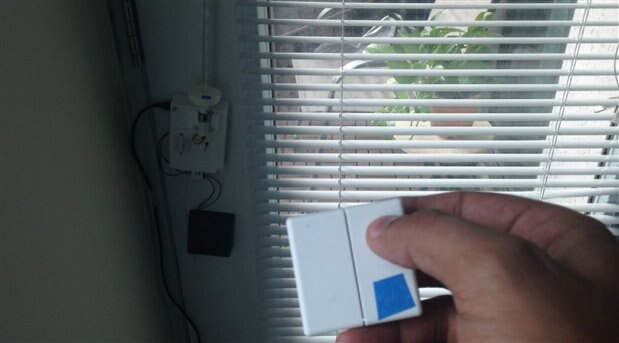

Spoke 2 -  Blinds Automation
This was the most interesting and challenging spoke that was put together, considering this was the first time I was using the EnOcean Sensor kit and module, which meant I ran some basic test using FHEM and tried blink a few LEDs when the EnOcean push button was pressed + Temperature module detected temperature + Magnetic contact was Open/Closed , which were all connected to Raspberry Pi B+ via the EnOcean module.
Pi Control Hub:Spoke 2:Blinds Automation-- Setting up EnOcean Sensor and Blinking LEDs
To open and close the blinds the plan was to use a gear motor which was driven by the Sparkfun motor driver , when a EnOcean push button was clicked
Pi Control Hub:Spoke2:Blinds Automation(continued)--Driving Motor with EnOcean PushButton

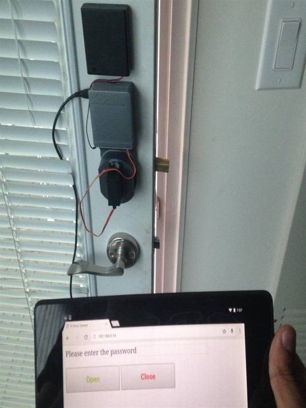

Spoke 3 -  Key-Less Door Entry
As part of this spoke a Pi A+ was used with a servo motor. In addition, a python-flask application was written which was hosted on the Pi A+ connect to my home Wifi. This App will be used to unlock the back door using a secret password which was setup in the code.
Pi Control Hub:Spoke3: Key-less Door entry-testing the Servo
The challenge with this spoke was to design the files to 3D print to find the door knob and the servo mount, if you plan to replicate this you can find the STL files at
Pi Control Hub:Spoke3: Keyless Door entry STLs
Key-less Door Entry using the Raspberry Pi

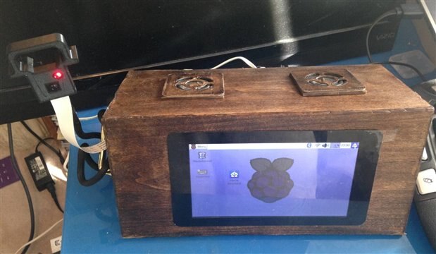

Now to develop the case to fit all electronic components, a mix of 3D printing and basic wood working with a Dremel was used and we also installed Chromium on raspbian-jessie
Pi Control Hub: The HUB

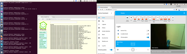

And as part of the final blog we integrated the EnOcean Temperature Sensor and the Magnetic contact sensor which mimics the door opening and closing in Home-Assistant , by installing mosquitto MQTT broker on the Pi 3 and installed MQTT client  on the Pi B+ which is connected with the EnOcean module.
Pi Control Hub : Getting EnOcean Sensor data to Hub via MQTT
(n the screen shot above , the left hand side is the terminal running the program to get the EnOcean Temperature and Magnetic Contact sensor values on Pi B+ connected to the EnOcean module + FHEM event monitor in the browser. And the right,  is Home Assistant dashboard showing the two sensors EnOcean Temperature in circle in the middle and the Door represent the magnetic contact sensor, which is the last circle on the right,  installed on Pi 3, aka the Hub.)
