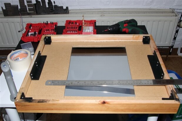

Making the Magic Mirror
It is not the first time I build a magic mirror (the last was the Scary Mirror for the past Element14 presents Halloween) but in this case, some complications arose and I had to face to unexpected issues.
The Base Design
The principle to create a "magic" mirror is relatively easy; if it is well designed the impact on the visitors, especially those who have no idea of what will happen, is really nice. I started revisiting my first Magic Mirror project – a Magic Mirror development platform to experiment with the Raspberry PI – to which I have applied some structural changes. In principle, a Magic Mirror is a screen behind a semi-transparent mirror; this makes possible to generate incredibly and surprisingly effects.
The semi-transparent mirror front side is firmly kept in place by a big MDF frame; the remaining visible rectangle hosts laser-cut plywood with a square hole for the Pi Camera lens and the 7" Raspberry PI LCD touch screen (in this case the touch features of the screen are not used). For more details on the structure, look at the Magic Mirror project mentioned above.

To close the back of the mirror frame I have 3D printed a series of spacers to fix the back leaving internal air circulation.
Then, after gluing ten spacers on the border of the frame I have closed the mirror with a sheet of MDF 3 mm thick
In the below images: the magic mirror installed and "visible" by SevenOfNine
