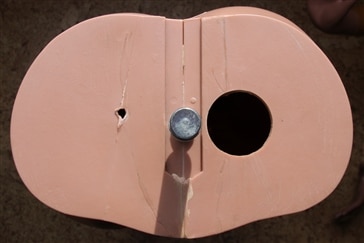

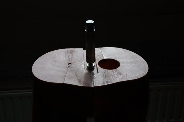

The two images below show the legs upper surface by the plant. I will start from this point to design the parts that must fit inside this space.

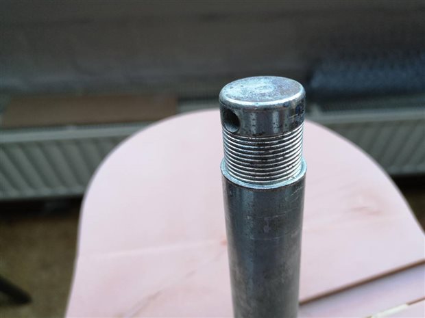

I have reviewed in detail the possible solutions to move the torso. The initial idea - very similar to those suggested by beacon_dave (Dave Ingels_ - sounds attracting but reviewing in depth how the two parts mannequin is joined arise a lot of difficulties, with the risk to be not feasible in a good way. The images below show how the central joint is an essential part of the entire torso support and can't be avoided. the lock nut is part of the system keeping together the two legs, as a matter of fact, the bottom half of the body.
Changing this part means to replace is rebuilding one in a different way and in my opinion it is not the worth as the same result can be reached in an easiest way, apparently more complex but that requires definitely less extra 3D printed parts.

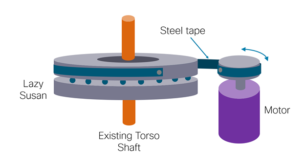

    Regarding the torso, you've got a lot more experience in motion and motors I think, so this idea I'm about to suggest may have issues to rule it out, but just in case it gives any further ideas: I was wondering if a Lasy Susan type device could be fitted (I think this could be identical to what you're considering with the metal ball bearings if I understand correctly), so that the torso can turn freely, and then use a motor and gearbox, to turn thin steel strip (or it could be plastic strip) - just like a reel of measuring tape basically.. The strip is strong enough so that it would push the lazy susan, but flexible enough so that it can go in a curve. One end of the strip is secured to the motor, and the other end of the strip is secured to the top half of the lazy susan.
    The benefit of the strip could be that there is no need for accuracy like with gears. I've never tried this though, so in practice it might not work. I think it may also need some 3D-printed curve around the lazy susan, so that the tape is forced to follow that curved path, when the motor is turning counter-clockwise.
