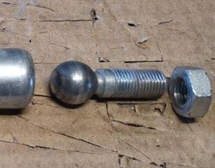

I have reviewed in detail the possible solutions to move the torso. The initial idea - very similar to those suggested by beacon_dave (Dave Ingels_ - sounds attracting but reviewing in depth how the two parts mannequin is joined arise a lot of difficulties, with the risk to be not feasible in a good way. The images below show how the central joint is an essential part of the entire torso support and can't be avoided. the lock nut is part of the system keeping together the two legs, as a matter of fact, the bottom half of the body.
Changing this part means to replace is rebuilding one in a different way and in my opinion it is not the worth as the same result can be reached in an easiest way, apparently more complex but that requires definitely less extra 3D printed parts.

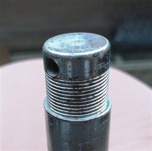

As shown in the above image, the shaft is not just a bar but includes a turnable spring to keep the torso in the desired orientation. This sounds good to fine-tune the upper part when there is the motor with the linear transducer. Following this proof of concept I have drafted a quoted sketch to fix the ideas before proceeding to model the parts that should be 3D printed.
I should make only two parts for the bottom: the stepper support that should be fixed to the plane and the back side support. To make it working without attrite, I will use a free fall bearing, part of the same 3D printing. Note that in the sketch I have designed only the bottom guide for the back of the torso but in reality, there is a counterpart that will be fixed to the bottom of the torso; both together will be thick like the motor. The threaded bar is oriented horizontally to the longitudinal (the longest side) of the torso in correspondence to the mannequin belly to be completely hidden.

    balearicdynamics over 7 years ago in reply to mcb1
    Hi Mark,
    thank you for your contribution. I am happy that this project is creating attention stimulating suggestions and criticism.
    Well, I have checked again the details but this solution is not viable. This is a mannequin of the mid of the '60s: heavy, well done and most of the parts are really well refined by hand. Advantages and disadvantages...
    The legs are two and the bottom part of the body is divided in two parts, joined inside (the hole is just to close the joint nut. The same joint is the support for the shaft bottom M4 screw with the blockage nut. The problem of the spherical support is meaningless as the top regulation of the shaft act to the inside spring and metal cylinder to lock the shaft in the desired position. It is very robust when locked (if should support in the original design, both the torso and the dressing). This is fundamental as the body planes separating the two halves are not perfectly plane, just well refined. The entire shaft length (25 mm diameter) will fit inside the body to keep in position at the right azimuth but it is fundamental that the torso is based on something almost large.
    You mention geared motors (excluded as I should make specific movements so the choice is for a stepper). But probably not evident in the images, this stuff is a 1.80 tall real size person build without material economy in mind. The torso, empty as it is now, is about 5.5 Kg that will probably reach 6.5 with the stuff I will add. So the Nema 17 stepper motor and the reduction of the pulley is the minimum essential to be able to move it without too much effort.
    Mixing the various ideas I have discussed until now the solution I am trying to design for now is Lazy Susan bearing on the peripheral, the motor inside the base of the legs (not exactly in-axis with the shaft), and a reduction pulley of 150 mm diameter. As the rotation angle should be about +30 / -30 Deg, I will try to use a 2 mm tooth belt to join the big pulley (fixed to the dorso bottom) together with the small (20 teeth) pulley on the motor shaft.
