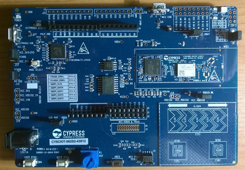

At the beginning I will describe what the Cypress PSoC 62S2 Wi-Fi BT Pioneer kit really is because as the name says it is little bit complicated. The board is often referenced as CY8CKIT-062S2-43012. This is most important name. You will search at all documentation to this specific board under that name and all codes/examples/libraries refer this board using this name. The name of board respects onboard modules, chips and features which it offers. Because there are lot of things that you can do with this board, this resulted into very long name. I will refer whole board as “development board” because their official name is very long. If you search for the schematics of the board you will find them under name “CYW9-BASE-01”. At the first page of schematics is written that board is modification of that generic design. This is probably reason why multiple pioneers kit looks very similar – Cypress made one reference design and then specific pioneers like roadtested CY8CKIT-062S2-43012 derives from it with some modification like exchanging WiFi + BT module with another one. The following picture shows whole development board and later I will show what modules and chips we can found on that board and what are they used for.
Board has soldered another board – module onto it. Following image shows marked module. I will refer this module as “Main module”. Module is named CY8CMOD-062S2-43012. Please note that this name is very similar with name of the board itself. It differs only in exchanged MOD and KIT in the first part of name. I did not found any official webpage for this module and it looks like that there are no possibility to buy them alone for soldering to custom designed board. I consider it as disadvantage because module looks very well designed, it is small when considered his features and how much pins it exposes. Maybe cypress will bring it to the market later.

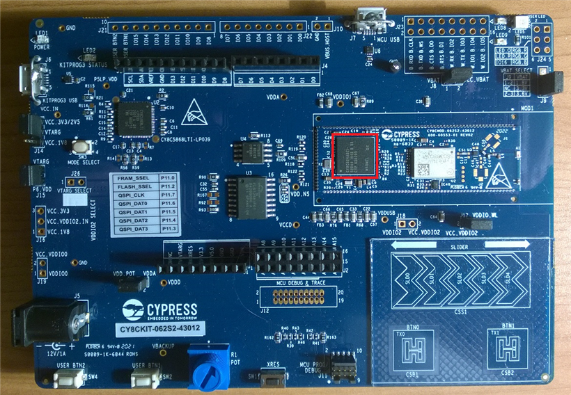

The module contains two “big” ships (and some passive electronics). The black one is PSoC 6 MCU. I will refer it is as “main MCU” and it is Cypress PSoC 6 MCU. It is CY8C624ABZI-S2D44. It is reviewed in detail in chapter “Review of microcontroller”. Following image shows him. Also note that name of this chip is referred in the second part of name of module and board.
The second chip – the white one is Wi-FI and BT module. Following picture shows the module. It is Type 1LV from murata. While this may at the first look implicate that this chip does not came from Cypress, but this is true only partially. The main core of this chip (inside them) is chipset from Cypress, and it is CYW43012. This chip is reviewed in chapter “Review of Wi-FI and BT module”. Name of chipset of this chip makes the third part of board and module name.
Three black chips remain. The rectangular chip placed at left is another PSoC from cypress. It is PSoC 5LP with full name CY8C5868LTI-LP039CY8C5868LTI-LP039. This chip is not programmable form the user side. It is programmer and allows you to program and debug main MCU. This onboard programmer is named KitProg3 and is reviewed in detail in chapter “Review of programmer and debugger”. Following picture shows up KitProg3 programmer MCU.
The bigger of center chip is SPI Flash with full name S25FL512SAIF01. It is from Spansion which is now part of Cypress. Following picture shows them.
And the last one is CY15B104QSN (this name came from datasheet, package of chip itself contains text “CY152B3”). It is FRAM. It is shown on the following picture. Technical details (including details for the previously mentioned FLASH) are in chapter “Project 3 – FRAM”.
Other parts are easily resolvable. There are buttons, LEDs, pin headers for expansion, touch buttons at the right bottom corner, potentiometer, jumpers, power jack, USB connectors and lot of passive electronics. At the bottom there are lot of passive electronics, voltage translators, probably some protecting circuity, soldering jumpers, some pads for unsoldered components, micro SD card slot and rubber stands.
The board itself looks very high quality. Cypress placed lot of useful labels onto it but some of them are from the bottom what you usually don’t see. But they are here and can be helpful at least at beginning phase of development where you are configuring ports. While board is not smallest board available on market it is easy to hold it in hand. All corners are round and edges are not sharp.
