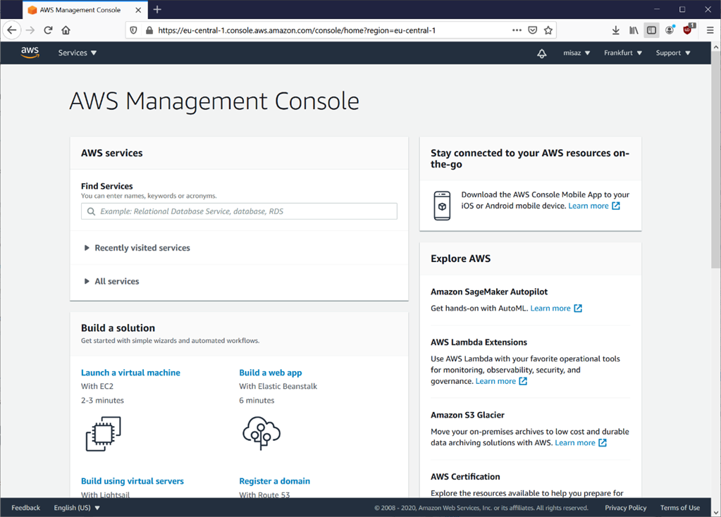

We need to setup AWS to allow device to connect to cloud, register him and generate authentication private key and certificate for it. After you login to the AWS Management console You will see following.

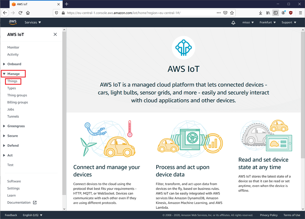

Open Services dropdown and search for IoT Core and open IoT Core administration.

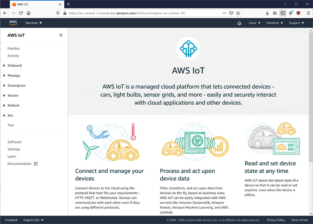

You are navigated to AWS IoT console now. You see following.

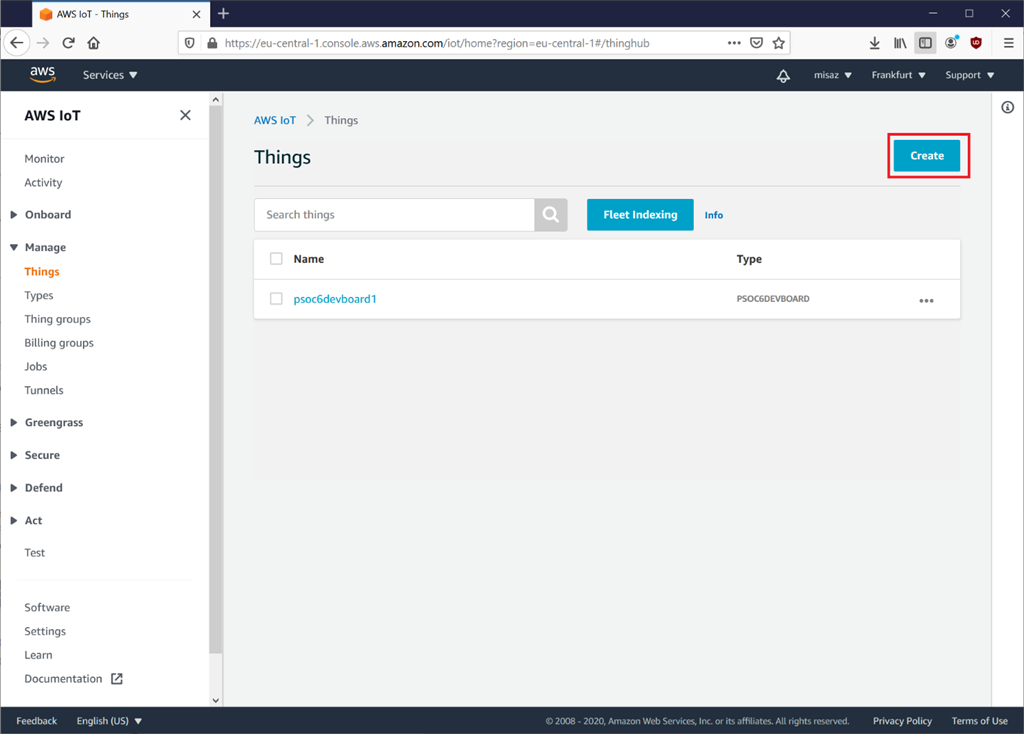

Open the Manage section from menu and then go to Things.

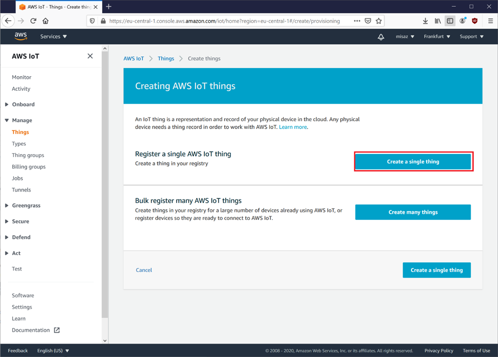

You now see the following page. You probably do not see any thing If you have never used AWS IoT before.
Click Create button.

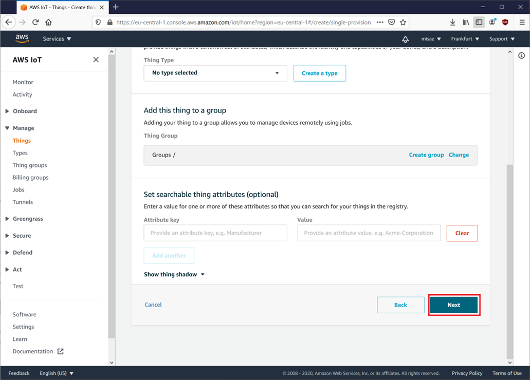

Click Create a single thing.
Enter the device name.
And press next.

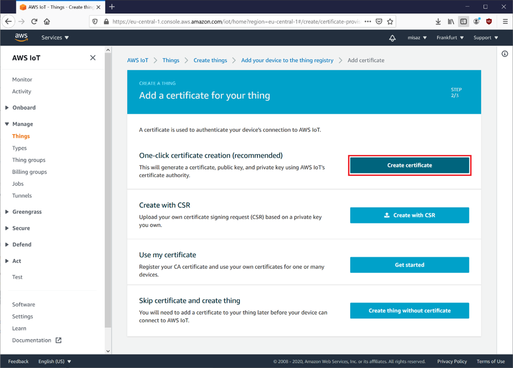

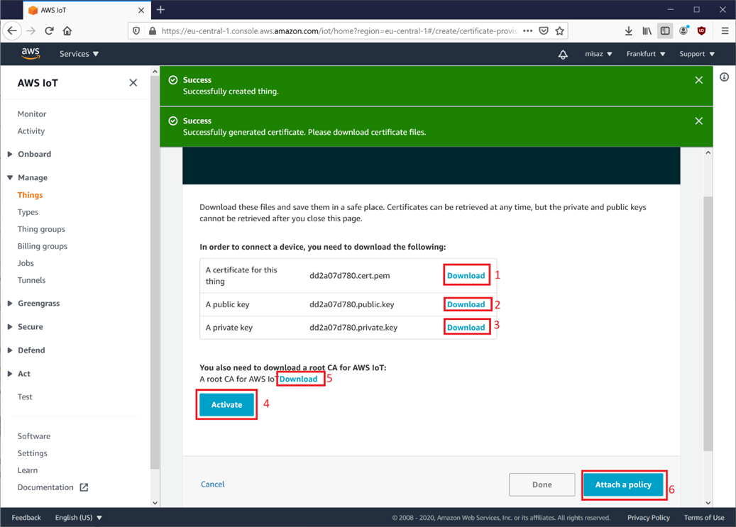

Press Create certificate.
Now download pem, public and private key, click Activate and go to link “Download” next to “A root CA for AWS IoT”.

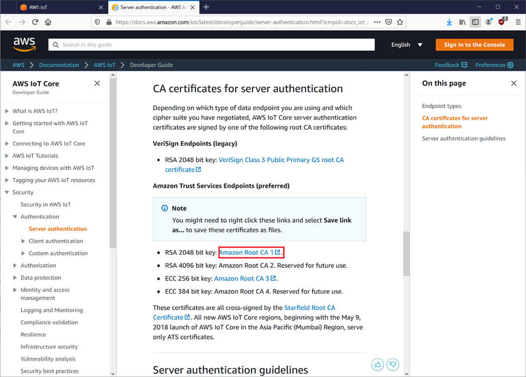

5th step navigates you to documentation page. Download Amazon Root CA 1.
Then go back to administration and confirm and press Attach a policy as stated before.
You probably do not see any policy. Click Register Thing. We will create policy later.

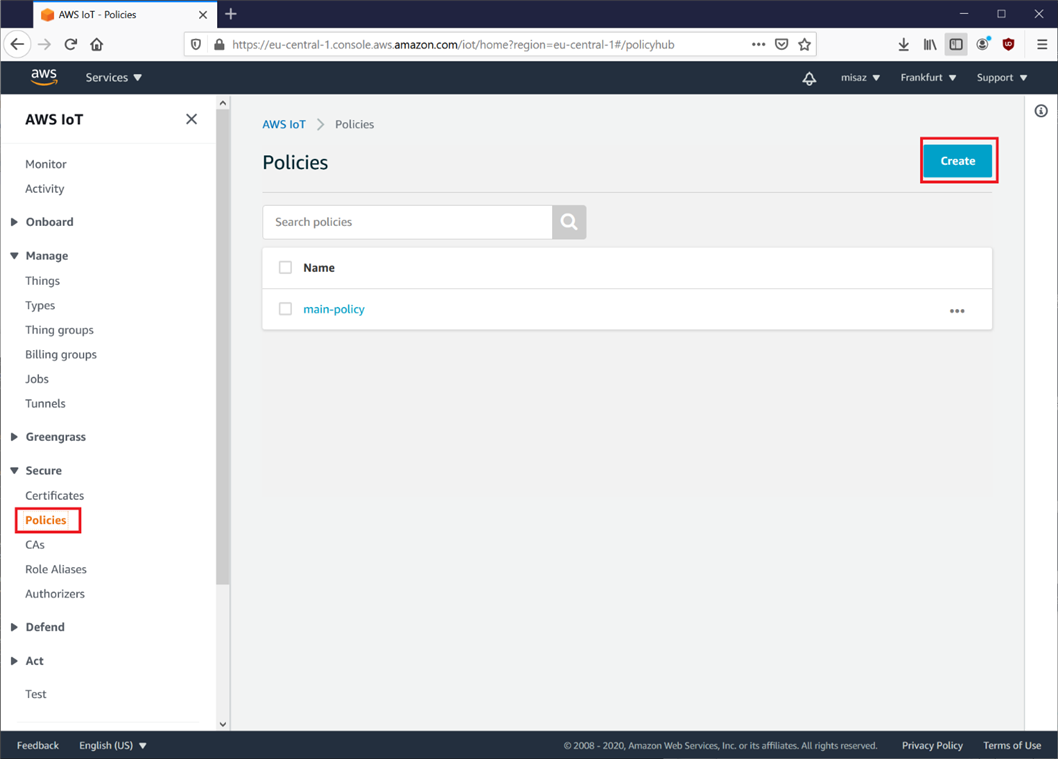

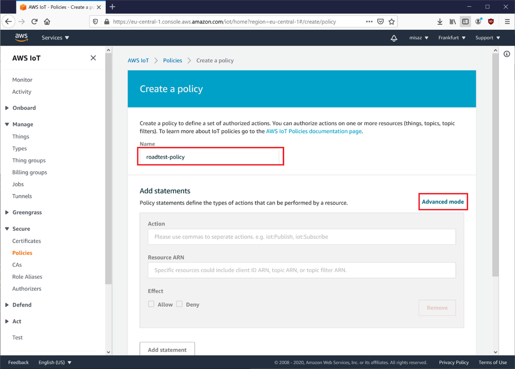

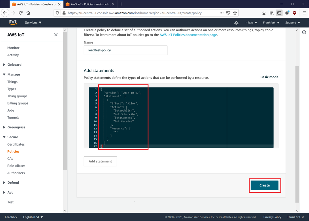

Now go to Policies section in main menu. You probably do not see any policy If you have not used AWS IoT Core before. Click Create.
Enter the policy name and switch to Advanced mode.
Enter the following policy.
 "Version": "2012-10-17",
 "Statement": [
 "Effect": "Allow",
 "Action": [
 "iot:Publish",
 "iot:Subscribe",
 "iot:Connect",
 "iot:Receive"
 "Resource": [
Security notice: This policy is simple, but it is completely insecure. This policy allows any device to access any resource in any way. Never use this policy in production. Always specify as much restrictive policy as possible.
Then confirm by Create button.

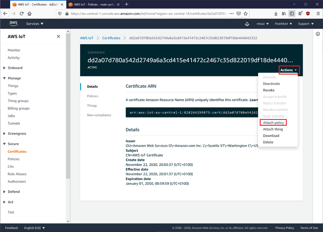

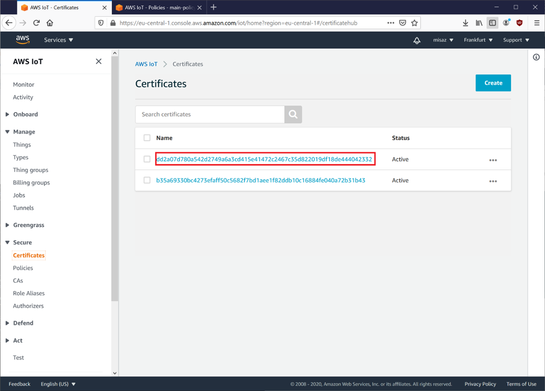

Now go to certificates. You will se single certificate. Open them.
Select Action and then Attach policy.
Select created policy and confirm by Attach button.

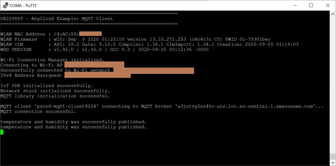

Now If you run application. On the terminal you should see some header which comes from original code example, information’s about WLAN firmware and message that first message was successfully sent to cloud.

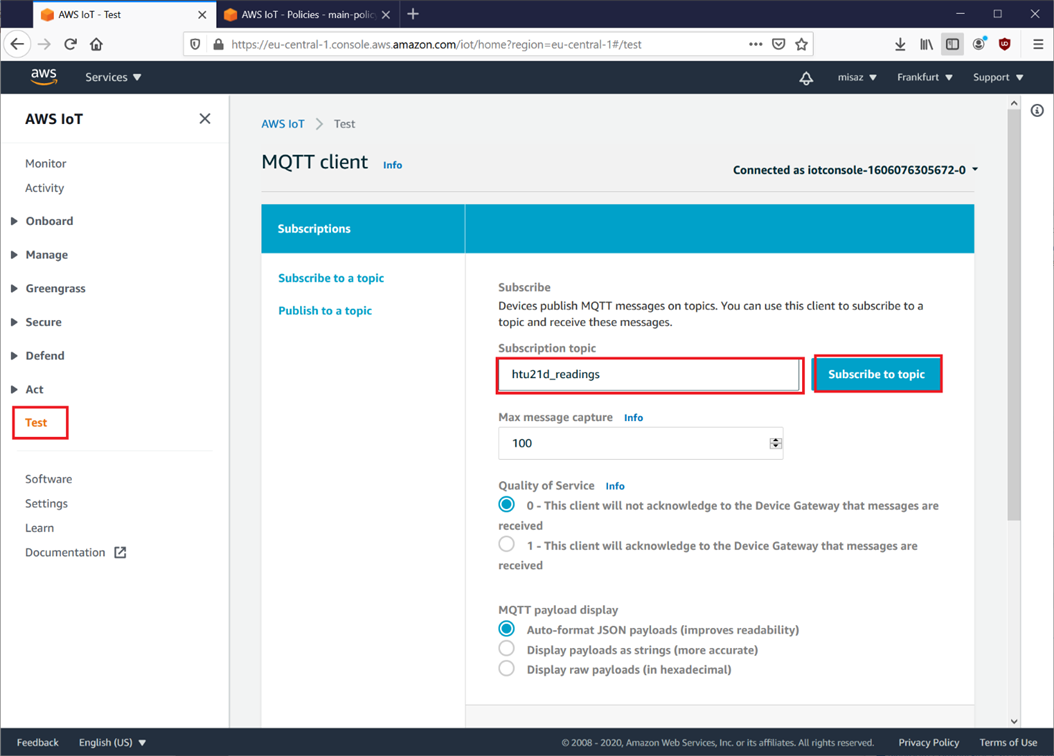

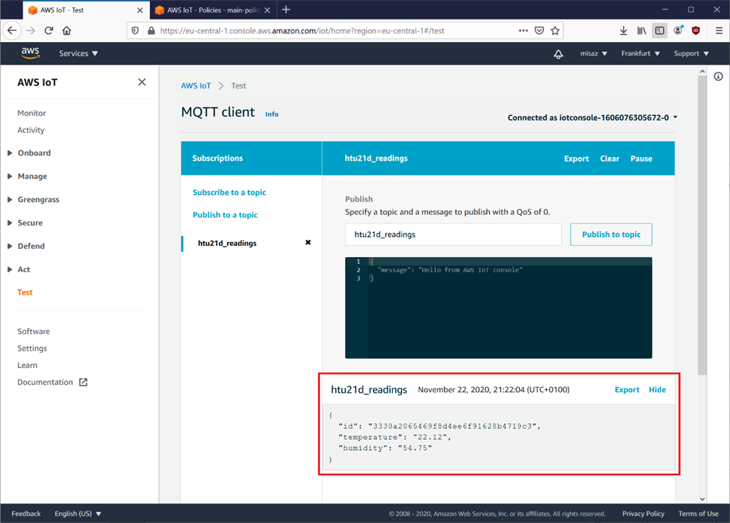

Go back to AWS Management Console and in menu click Run. Then fulfill the topic name to the topic specified in firmware of device and press Subscribe.
After a while you will see that MQTT client running in cloud received message sent from your device with measured values.

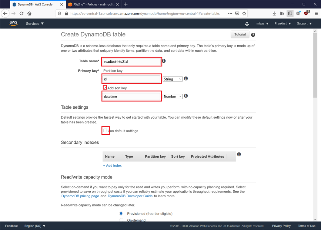

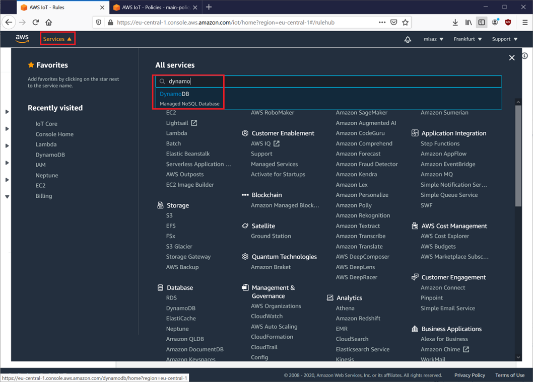

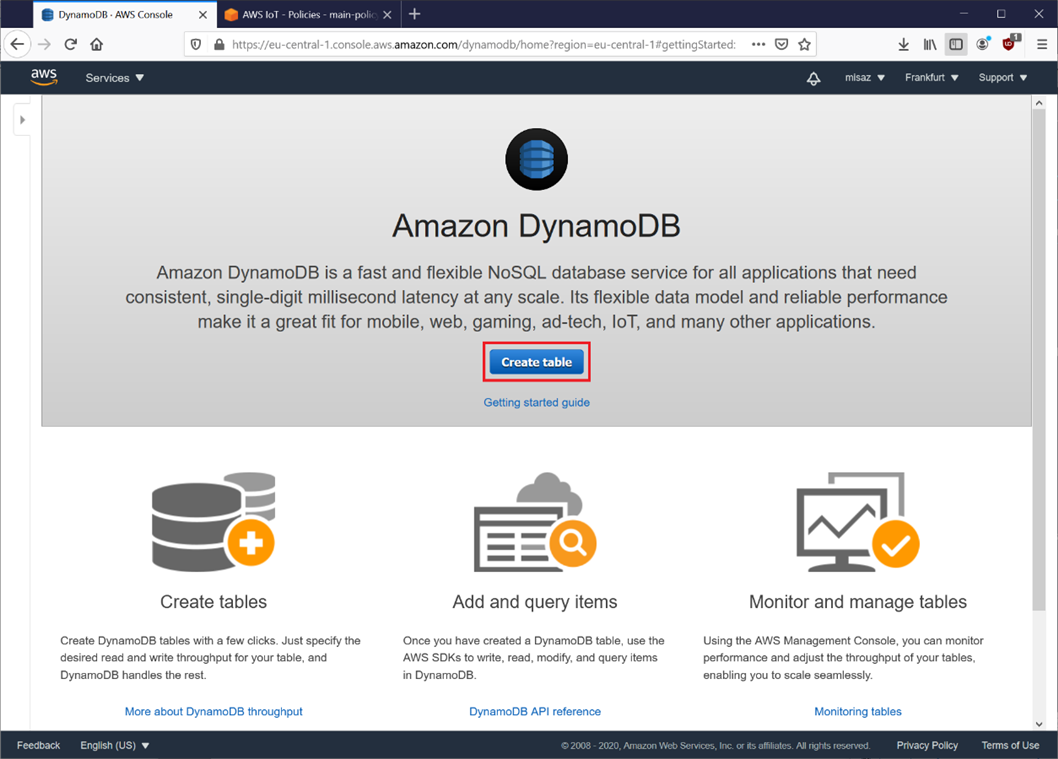

Open Services lookup and search for DynamoDB. Then go to DynamoDB administration.
Click Create table.

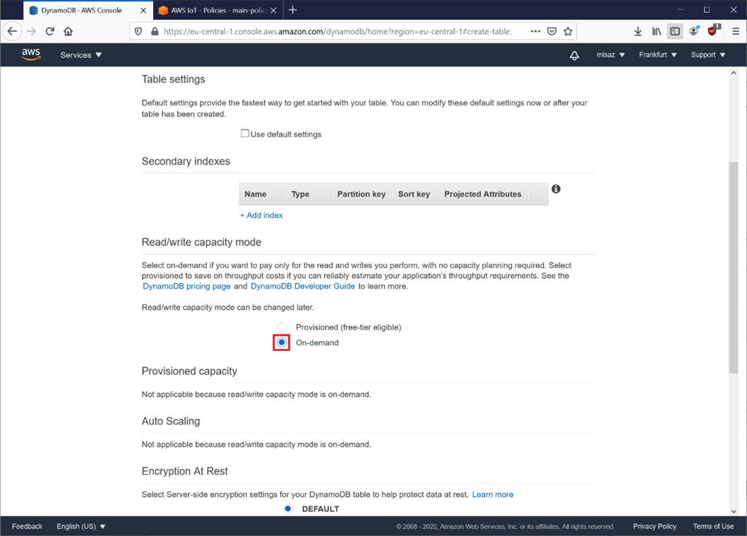

Enter the table name, as a primary key choose id (it is not a good primary key for nosql database, I recommend consulting documentation to make a better key in production). Then select Add sort key and type datetime as sort key. Select type of datetime to Number. Then uncheck Use default settings.
Capacity mode switch to On-demand.
Confirm by Create.

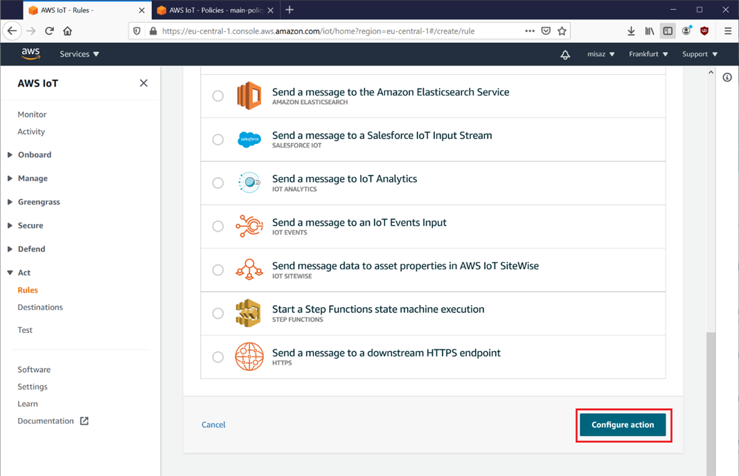

Enter the following SQL command and press Add action.
SELECT id, timestamp() as datetime, temperature, humidity FROM 'htu21d_readings'

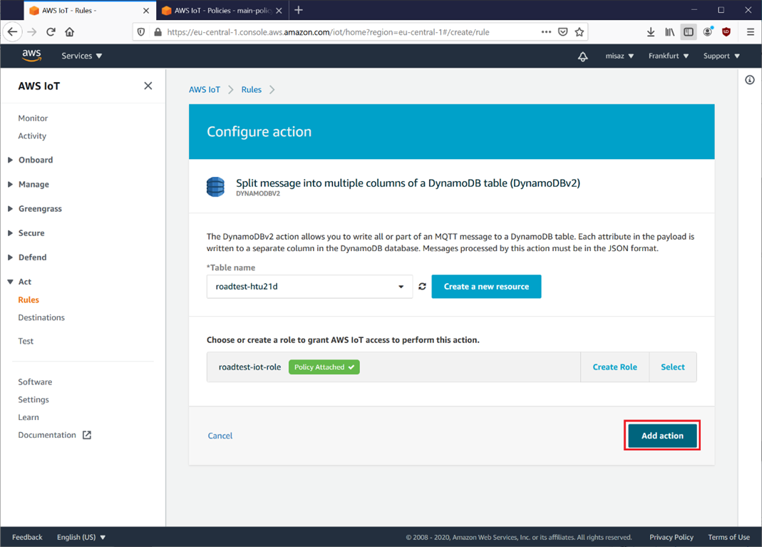

Select Split messages into multiple columns of DynamoDB table (DynamoDBv2).
Then press Configure action.

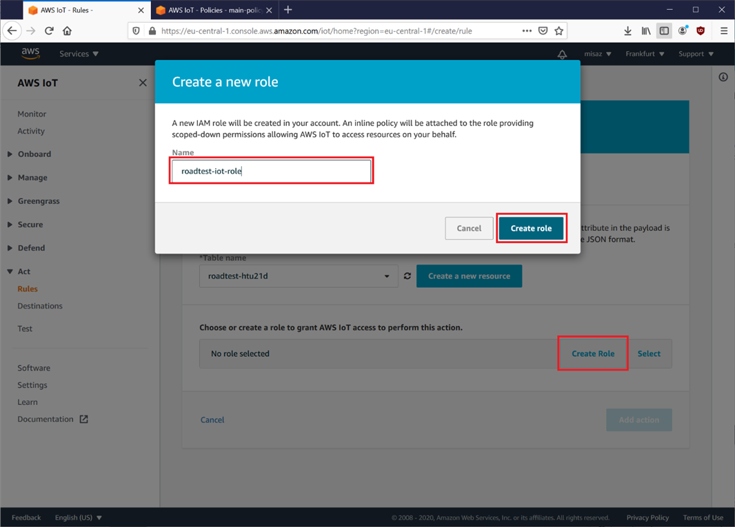

Select a DynamoDB table.c
Create new Role, enter their name and confirm.
Then confirm by Add action.

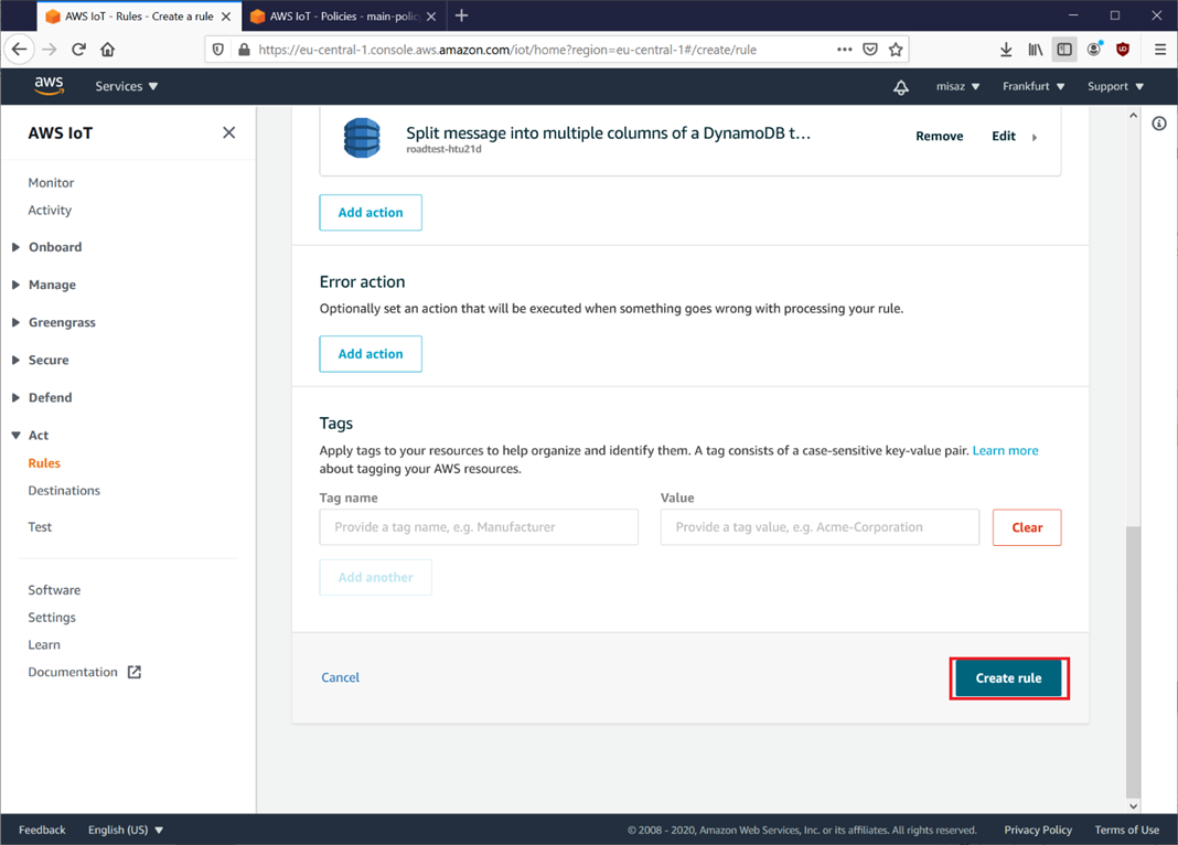

And confirm by Create rule.

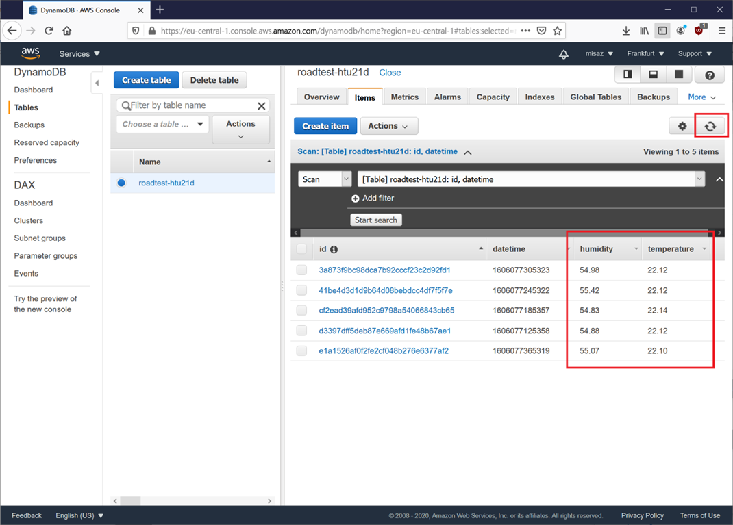

Now you can go back to table, wait until your device publish new measurement and check them in table. Open the table in DynamoDB administration.
And after some time you will see data. You can update view by Refresh button.

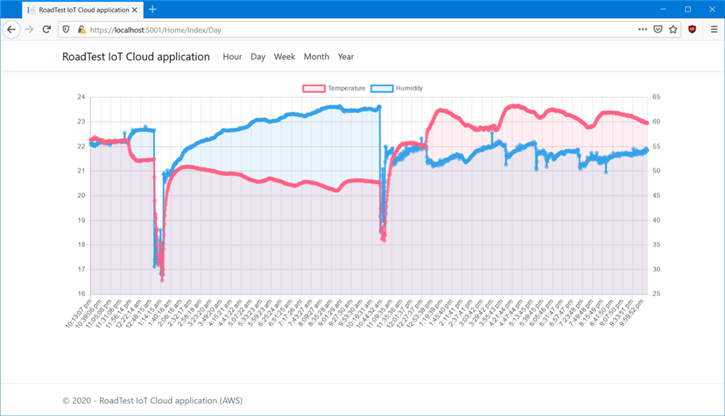

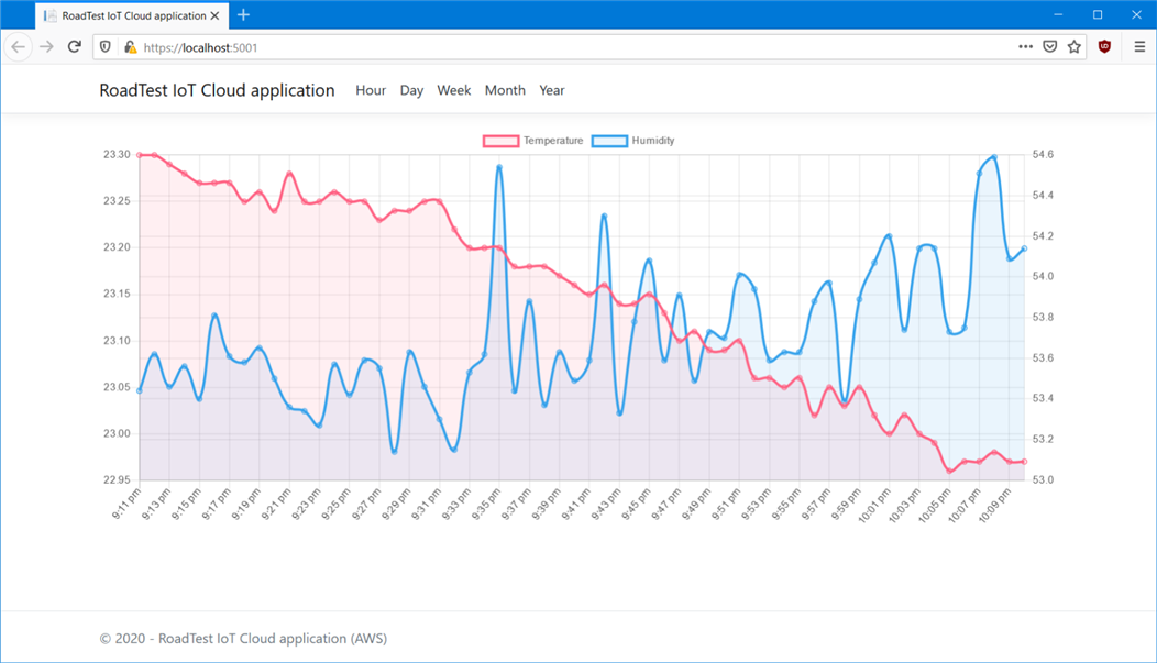

Web interface to cloud data
I have created ASP.NET Core application that connects to DynamoDB and renders chart with measured data. His description is outside of scope of this roadtest review. This application is available to download with source code at the bottom of this article. It is Visual Studio solution. You have to update AWS credentials in appsettings.json file before run.
The most interesting part of code is function downloading data from cloud. It is following.
public async Task<IEnumerable<Measurement>> GetData(long startTime, long endTime) {

As you can see It has two parameters which are unix timestamps and it builds request to AWS for data which has datetime filed set to value between these parameters. After that function process the output to internal structures and then build HTML page with this data. You can run this application in AWS, but it requires full time hosting server, so I am running it only on localhost. At the page you can see combined chart of humidity and temperature. For example, it should look as follows.
You can switch time range from Hour (default) to day for example.
You can analyze behavior of your temperature and humidity. I run this application in my room. The huge drops are times when I opened windows. The temperature slowly drops and grow when heater is enabled which should be easily interpreted from charts.

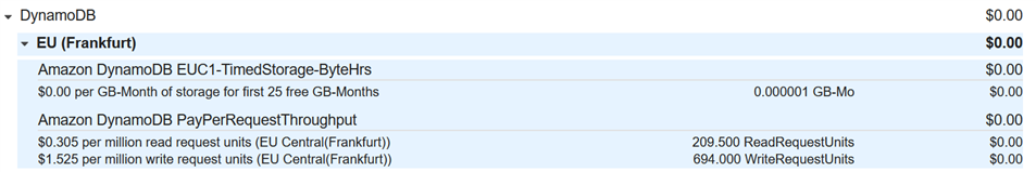

Pricing of cloud services
Disclaimer: The following prices are based one less than one day of running app under specific cost optimized conditions. I am not responsible for any of your high charges which you may incur by doing the same as in this tutorial. Always check all pricing conditions in documentation and be careful. Pricing conditions may have changed since I wrote this article.
Because the app is designed as completely serverless, their hosting (except web interface) is very cheap. After a day of running I have checked billing section. For DynamoDB I paid nothing because the app (both IoT part and my web interface) do not produce enough requests to pay anything. It depends mostly on How often do you check web interface because every load of web interface page makes request to DynamoDB service.
Similarly, when running with one device It also do not use IoT Core service so much to pay any high cost.
This is because it is very simple app running on one development board. You may be incurred higher cost and pricing conditions and prices may change over time.
