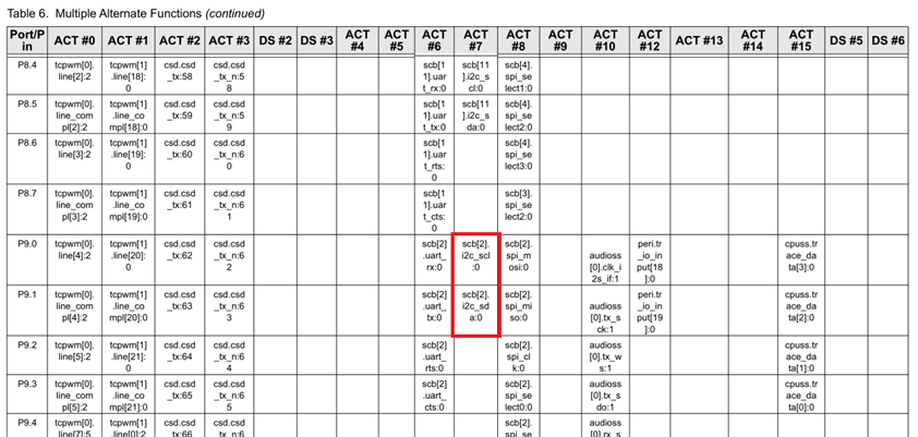

Selecting correct I2C pins
In the project I will use the HTU21DHTU21D which will be attached to the board using expansion port. I will use P9_1 as SDA and P9_0 as SCL. This choice is not random. Selected ports must have support for I2C which means that there must exists at least one Serial Communication Block (SCB) which’s signals can be connected to these ports using High Speed Input Output Matrix (HSIOM). These mappings are described in the datasheet (not a TRM) because they are device specific (partially they are family specific). In this case on the P9_1 and P9_0 is mapped SCB number 2.
I2C Initialization code is following:
result = cyhal_i2c_init(&i2c, P9_1, P9_0, NULL);
if (result != CY_RSLT_SUCCESS) {
    CY_ASSERT(0);
The first parameter of library is address of structure for holding internal state for HAL. Declare it as global variable.
cyhal_i2c_t i2c;
Code is easy with HAL library. Library will auto detect peripheral number and do all initialization stuff including configuration of clock system. If you want custom clocks, you can provide them using 4th parameter of cyhal_i2c_init function but if you want to automatically assign and configure one, you can pass NULL and library will do it for you automatically.
