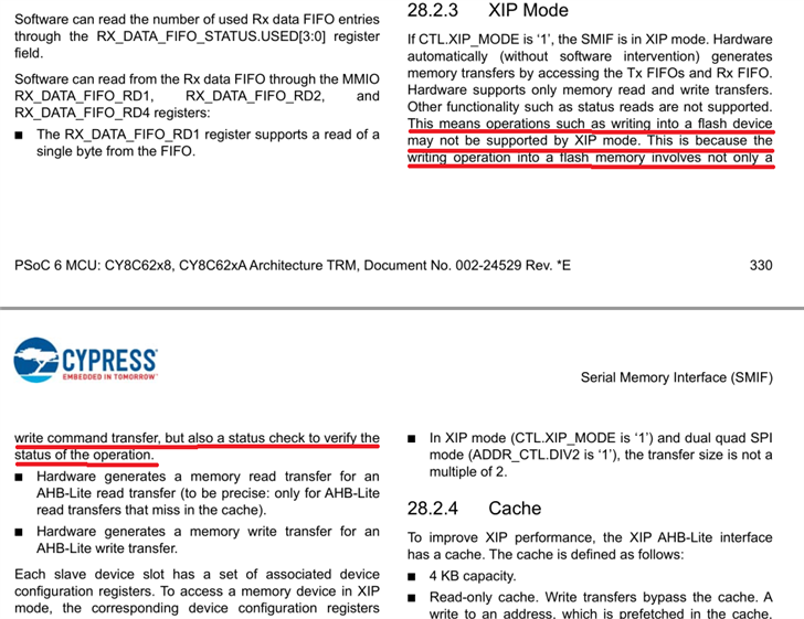

PSoC support XIP mode. It has two meanings. The first meaning is that content of external memory is memory mapped into ARM address space. If you declare pointer with address pointing to that space and attempts to dereference that pointer, processor will internally issue a transaction with configured read command against the external memory and returns the data received from the external memory. You may think that for writes it works in the same way, but this is not true. I have checked what about competitors (I checked some STM32s, NXP KL8x and some SAM from Microchip) and anyone does not support writes to external memory. Cypress have implemented the writes only partially. Write does not cause a bus error in ARM core (as for example STM32 does) and it will issue correct write command to the memory but there is some little detail which make it unusable. Probably all current serial memories (not matter If it is FLASH or FRAM) require issue write enable command before write operation and optionally it is recommended to check status after write to check that all data was successfully written. SMIF cannot issue that write enable command before. Cypress sadly stated that writes are unusable in TRM.
I think Cypress is on the good way to implement it with support for writes because peripheral theoretically supports it now. Their design requires enabling user to define more complex command sequences. Currently you can configure only one command which is issued at read (and it is sufficient for read) and only one command for write operation (it is not sufficient, because you need multiple commands to write data). Other vendors usually designed they peripheral to do not support writes at all. From some perspective of view, it makes sense. If you consider only FLASHes (no FRAMs) the enabling write operation may cause that lot of users destroy their flashes when they do not realize how quicky they overwrite memory and exhaust whole amount of available write cycles. Second good reason to do not implementing support of write is that FLASHes needs to erase memory before write. They cannot erase every single byte but when erase is issued, they erase whole row (or bigger block of memory) so If user needs to overwrite one byte it must backup block of memory, update one target byte, erase whole block and then write block with updated byte. This are reasons why anyone do not support memory mapped write to the external memory – because it does not make sense for flashes. But If you think about FRAM situation is completely different. Fram does not need to erase memory before write, you can overwrite every single byte without affecting sibling bytes, you do not need to check any flag after write because write is immediate, and you do not need to worry about write cycles decreasing lifespan of memory. I am little bit sad that engineers in Cypress did not realized that in time when they were designing SMIF peripheral. I think that for Cypress it completely makes sense support writes in XIP because they also offers FRAMs.
