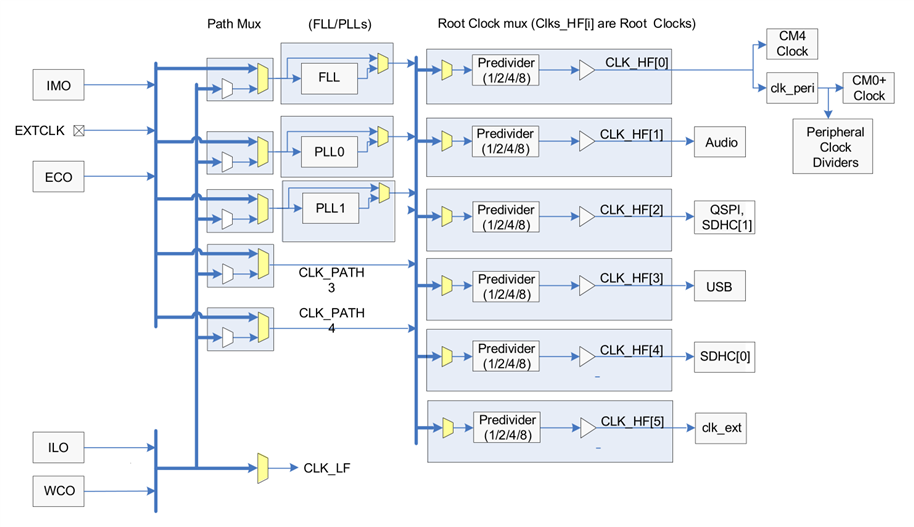

One of the best parts of the PSoC I consider his clock system. Other ARM microcontrollers (like STM32) usually have simple clock system with (usually one) PLL with ability to select one of input from the choice of internal inaccurate oscillator, external accurate crystal, or external clock and sometimes something else. Output of PLL is usually used as source for ARM Core and then it is used as clock for peripherals after basic configurable division. Cypress implemented much more advanced and flexible system in PSoC 6. Clock system is visualized in datasheet by following image.
Important parts are strong blue lines. They separate parts of clock system to three parts. First part is clock inputs, that is same as usual on other MCUs. IMO is Internal (inaccurate; 2% accuracy, some documentation mention 1% accuracy) oscillator. EXTCLK is external clock. ECO is External crystal oscillator. ILO is integrated low speed (32khz) oscillator. WCO is external oscillator (usually 32.768 kHz) for watchdog and some other low speed peripherals. This part of clock subsystem is quite common and there is nothing extra or missing.
Second part of clock subsystem is more interesting. There are two independent PLLs and one FLL. The multiplexers before the blocks enables you select the whatever input you want to that blocks. If you do not want modify input, you can bypass that block. This design enables you to generate multiple base high speed (or even low speed) clocks independently. You can configure one PLL to generate beautifully rounded 150 MHz clock derived from IMO and second PLL to generate accurate clock from ECO for audio peripherals. Second interesting thing is FLL. I have never seen FLL in MCU before. FLL does similar things like PLL but have some restrictions and some benefits. Main benefit is that it consumes less power than PLL. This is very good for low power designs. There are some restrictions to input and ratio of input and output clock frequency. Another advantage is that FLL starts faster than PLL. If you need for some reason to have MCU ready and running at high speeds very early after power-up FLL could be good choice.
Third part of clock subsystem is even better. There are 6 sections. There are 5 special peripherals requiring accurate and specific or high-speed clock. You can route any of clock created in second stage to source clock to that special peripheral. You can also use some division. The more interesting is first row. It shows routing of clock for both ARM Cores and peripherals. Clock to ARM Cores you can divided by any integer between 1 to 256 (there are no restrictions to power of 2). Especially dividing clock for CM0 should be useful in low power design.
Clock distributed to peripherals is also interesting. In STM32 there is APB bus (or multiple APB buses) and you have to choose one divider of main clock for all peripherals connected to that bus. This means that if timer and I2C block shares the same APB they must be clocked from the same clock. In PSoC it is designed differently (and much better). There are 29 clock dividers of 4 types. Except distinguishing 4 divider types the blocks are generic, and you can use them fully independently. There are 8bit dividers which can divide input frequency by any 8-bit integer number (divider is value + 1, because dividing by 0 does not make sense). For example, if you have input clk_peri set to 100MHz and you set divider to 42 (value 41 in register) you get clock of frequency about 2.38 MHz. Similarly, there are 16bit dividers to generate even slower clocks. Next two types of divider are fractional. There are 16bit and 24bit fractional dividers. They can divide frequency by value described by formula A + (B/32), where A is 16 or 24bit number and B is number in range 0 to 31. You have 29 blocks, so you can generate 29 different clocks for peripherals. You can attach any of generated clock to any peripherals or more peripherals. There are no restrictions about that. You can for example configure one 2.5 MHz clock and assign it to SCB running as SPI and Timer at once. At the same time, you can configure another divider to get 921.6 KHz and use it for another SCB running as UART with oversampling 8 (you get baudrate exactly 115200).
In my project 1 in low level variant, you can see how I configured clock subsystem in low-level using registry accesses. While system is complex It is not so hard. For normal use there is GUI utility that you can use to easily configure all clocks with interactive preview and automatic calculation of parameters for PLLs, FLL and dividers.
Clock system is great. I think that it is very useful when you develop low power application. Power consumption is typically expressed as µA/MHz so if you run some component at lower frequency then it consumes less. It is fine to configure every component of system to consume as low as possible and not be fixed for running multiple peripherals on very high frequency because another peripheral on the same bus requires it.

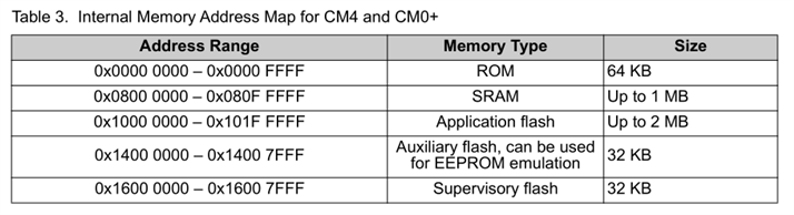

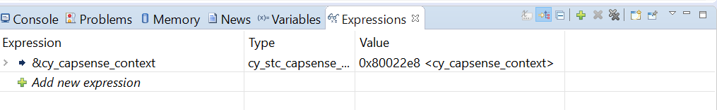

Understanding address space layout is quite complicated on PSoC 62. Usually, MCU vendors choose addresses to make easy determining to which memory address belongs by interpreting first letter of address. For example, on STM32F4 flash addresses begins with 0x20000000, peripherals with 0x40000000 and 0x50000000, ARM peripherals addresses begin at 0xE0000000 and RAM addresses are short because begins with 0. Every time when you look at first letter of address you know where it is. On PSoC all addreses begins with 0, 1, 4 and E. Let’s look at the following screenshot from Modus Toolbox IDE.
It shows address of some variable and it is at address beginning with 8. But, wait. How It should start with 8 when I stated that all addresses start with 0, 1, 4 or E? Reason is that this address does not starts with 8 at first letter but it starts with omitted 0. If you look carefully it does not have 8 hexadecimal digits but only 7. So, the address does not start with 0x8 as presumed but it starts with 0x08. And finally, that address correctly maps to RAM according to following table from datasheet.

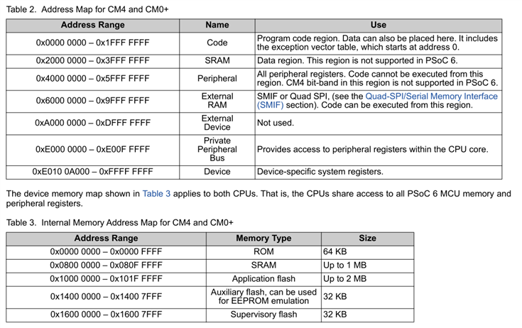

On PSoC memory ranges are little bit complicated and documentation is not clear. Datasheets mention some partitioning, but it contains only misleading and mostly useless information. In datasheet there are following two tables:
As you can see, first table states that SRAM is located at 0x20000000 address but second table states that SRAM is located at 0x08000000 address. If you look carefully to first table, you will see note that region 0x20000000 is not used in PSoC 6. In fact, term SRAM means something different in both tables. SRAM mentioned in second table overlaps with Code region in first table and it is correct but make less sense at the first look. If you read carefully note in first table, it contains information that Code range is memory which can be used for storing data and for executing code, so it matches description of SRAM (and some other memories). Finally, the second table which is more useful is incomplete because it does not contain address spaces between 0x18000000 – 1FFFFFFF which is used for mapping external serial memories (like FLASH and FRAM) to ARM address space. It also misses peripherals region at 0x40000000 and ARM peripherals region at 0xE0000000, but it is still more useful if you search for memories ranges.
Both previous tables come from Datasheet. TRM contains similar tables but little bit less confusing.
Look that there are completely different and correct description for region of 0x60000000 in first table. Second attempt to produce second table from Cypress is much better than attempt in datasheet but it is still wrong. Except typographical error in first row (missing space after dash) there is wrong end address of external memory. Range 0x18000000 – 0x08000000 does not make sense. Correct end address is 0x20000000.
