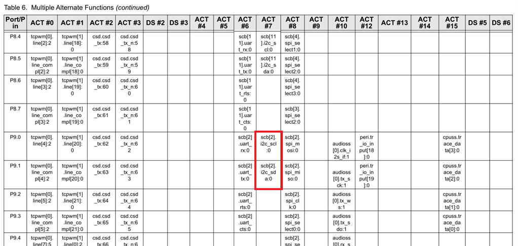

Now connect the HTU21DHTU21D sensor to the board by connecting SDA to P9_1 and SCL to P9_0. This choice is not random. Selected ports must have support for I2C which means that there must exists at least one Serial communication block (SCB) which’s signals can be connected to these ports using High speed input output matrix (HSIOM). These mappings are described in the datasheet (not a TRM) because they are device specific (partially they are family specific). In this case on the P9_1 and P9_0 is mapped SCB number 2.
This choice is also configurable, you can change them in HTU21D_PlatformSpecificPSoC6.h file.

Then P9_1 and P9_0 are configured to be connected to 7th peripheral and do not act as standard GPIO. This mappins is done using High speed input output matrix (HSIOM) peripheral which could be managed by Cy_GPIO_SetHSIOM function.
Cy_GPIO_SetHSIOM(HTU21D_SCL_PORT, HTU21D_SCL_NUM, HTU21D_SCL_ALT);
Cy_GPIO_SetHSIOM(HTU21D_SDA_PORT, HTU21D_SDA_NUM, HTU21D_SDA_ALT);
