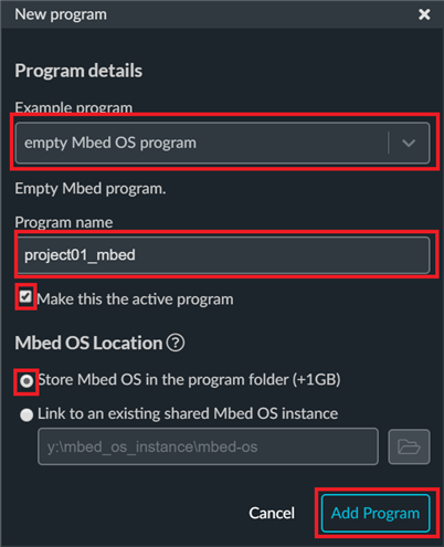

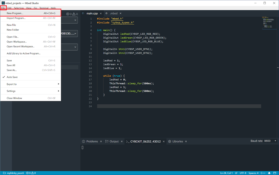

Create project in MBED Studio
Open MBED Studio and select File > New program.
  Then select the “empty Mbed OS program” as a template, enter project name, check that field “Make this the active program” is checked, selected “Store Mbed OS in the program folder (+1GB)” and confirm by Add Program.

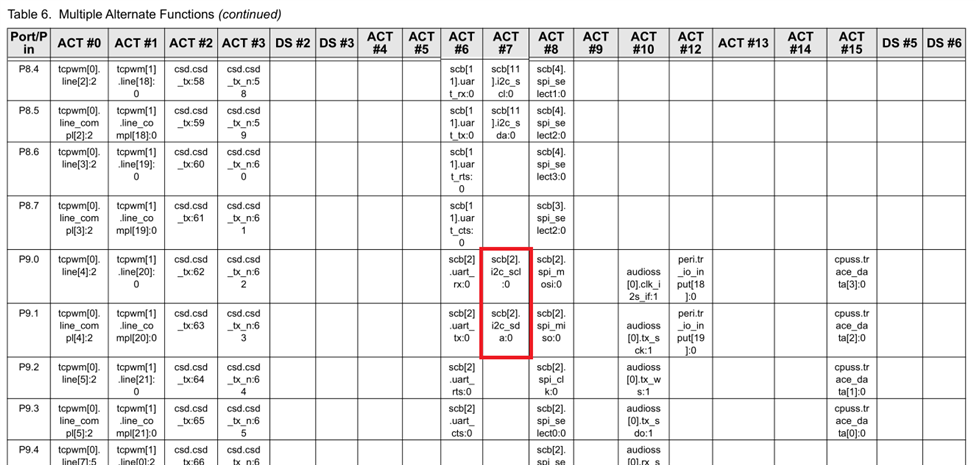

Selecting correct I2C pins
Now, open the main.cpp file and let’s start coding. In the project I will use the HTU21DHTU21D which will be attached to the board using expansion port. I will use P9_1 as SDA and P9_0 as SCL. This choice is not random. Selected ports must have support for I2C which means that there must exists at least one Serial Communication Block (SCB) which’s signals can be connected to these ports using High Speed Input Output Matrix (HSIOM). These mappings are described in the datasheet (not a TRM) because they are device specific (partially they are family specific). In this case on the P9_1 and P9_0 is mapped SCB number 2.
If you select ports that has no I2C support entire MBED OS will crash at runtime. So, lets declare global variable for controlling I2C bus in the following way.
I2C i2c(P9_1, P9_0);

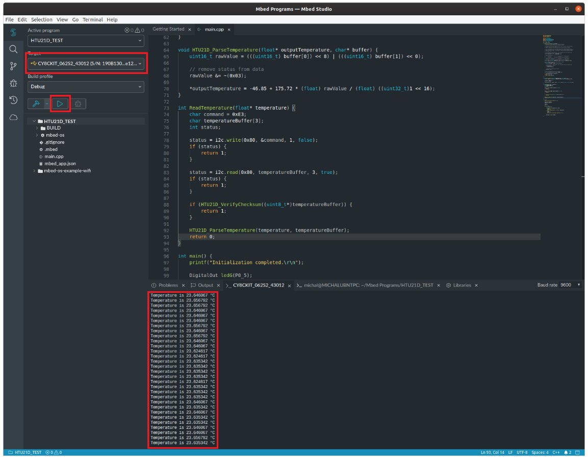

Run project
And that’s all for this example. You can run example using Run button. Before this you must select correct development board. If MBED Studio does not detect any board, check that you switched onboard programmer KitProg3 to DAPLink mode (KitProg3 Status LED must slowly flash) using MODE button. Run button causes that project will build (this will take a plenty of time, at least at the first build) and copies firmware to your board. In my case it does not work on Windows because I was not able to make PyOCD working on Windows. On Linux it works without issue. On the UART (which you can see in the MBED Studio) you can see the output.
