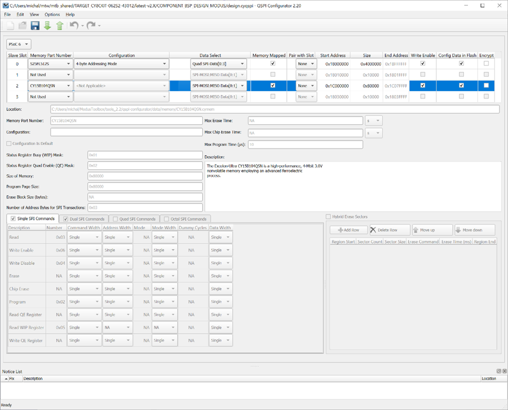

At the beginning create project based on Empty PSoC6 App template and integrate retarget-io and serial-flash libraries. Picture based tutorial you can find in Project 1 – low level variant. At the beginning lets configure memories used on board using QSPI Configurator which is available in Quick Panel window in Tools section. The first memory is preconfigured but we need to configure FRAM which is connected in slot 2 (not 1) and it is CY15B104QSN. The configuration file has no configuration for QPI mode. We can define it yourself or just use less efficient DPI mode instead. Because in this example I do not need ultra high performance I will use DPI mode instead. In Data Select select the wires that contain 0 in name. Enable memory mapped, start address set immediately after range where the Flash is mapped. It is 0x1C000000. Then enable Write Enable and Config Data in Flash. It should look like on the following image.
Then save changes using Save button in toolbar. It will automatically generate source files which include our setting. Now we can simply use memory using serial-flash library.

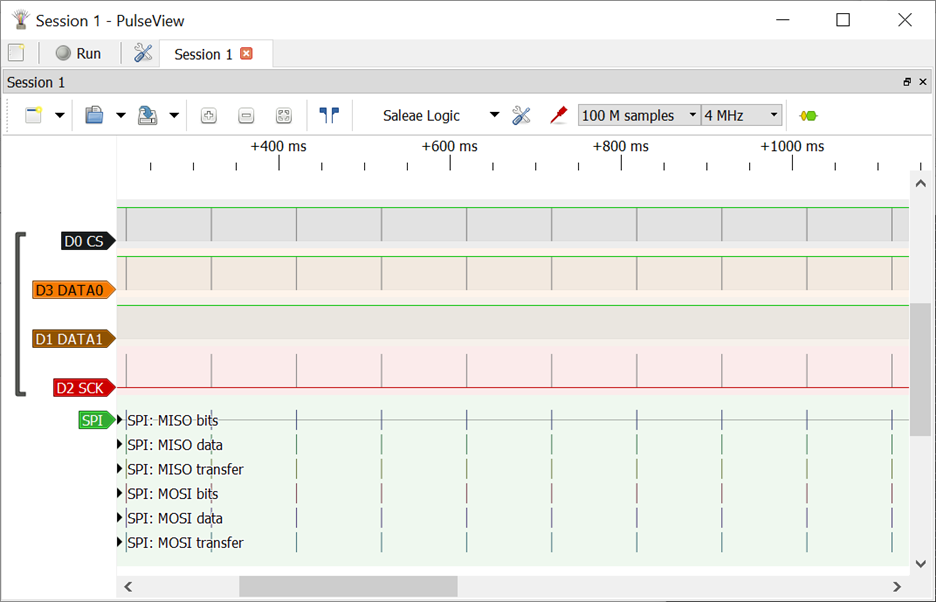

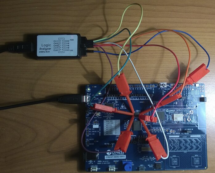

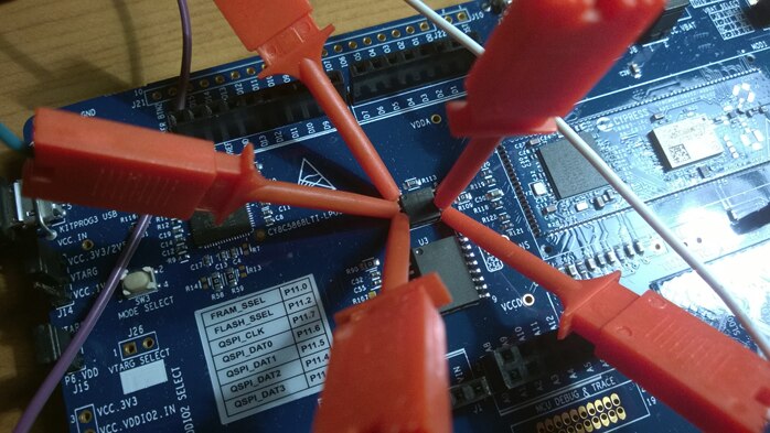

For the experiment I reconfigured application to using SPI mode and lowered frequency from 50 MHz to 1 MHz. Now let’s see what happens on the bus using Logic analyzer. I have connected logic analyzer to memory using following connection.
So now I can see what happened on the bus. If you look for overall view it looks as presented on following image. Every 100ms there are some SPI operation on the bus.

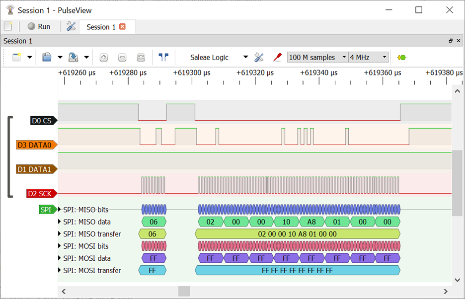

Now let’s look at the detail of one operation (others have the same format and differs only in number stored in data).
There are two operations. The first is command 0x06 which is Write Enable command. The second operations consist of transmitted bytes 0x02 0x00 0x00 0x10 0xA8 0x01 0x00 0x00. The operation code 0x02 means Write operation, then follows 3 bytes of address (0x000010) which is the same address as specified in FRAM_I macro, and then follows four bytes of data (0xA8 0x01 0x00 0x00). Because ARM of PSoC6 is little endian it is uint32_t of value 0x000001A8 (424 in decimal). It is the value of message which was printed at the time when this was sampled.
