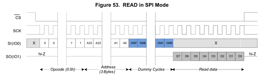

Before I write RFRAM and WFRAM function I need to define how does commands issued against the memory looks like. I need to define read, write and write enable commands. Read command should looks like as follows.
  I am using 0 dummy cycles as mentioned before. As you can see all parts of transfer (command, address and data) is send over only one line so all bus_width properties of definition structure are set to CYHAL_QSPI_CFG_BUS_SINGLE. Instruction is 0x03, address is 24bit wide and the value of address will be updated before every issue of command in RFRAM function. This command does not support XIP (there are more advanced read commands which supports it, but 0x03 do not) so transmission of mode bits is disabled. The definition of cyhal_qspi_command_t should looks as follows.

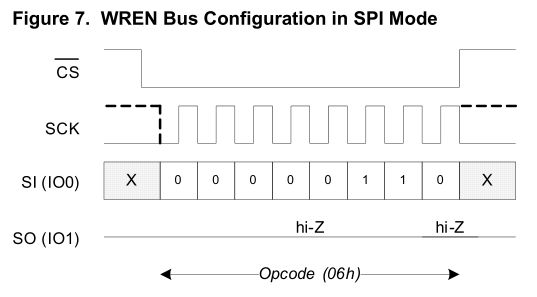

The next command I will define is write enable. It is simple command without any address, mode bits, dummy cycles and data. It looks as follows.
The definition is quite simple because most of features are disabled for this command. I do not need to configure properties of parts that are disabled because they are not used by cyhla_qspi functions internally.

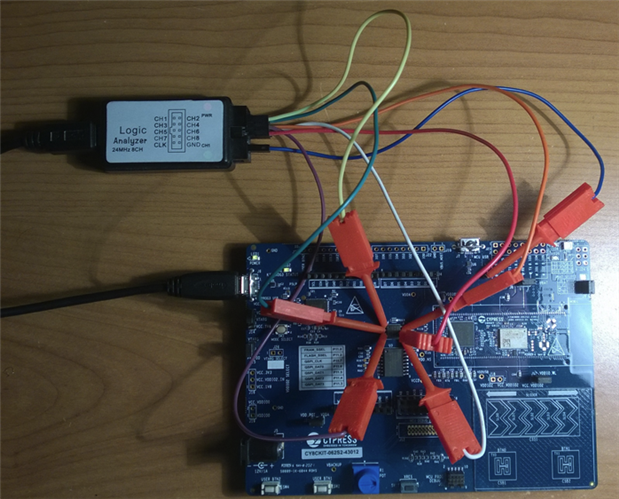

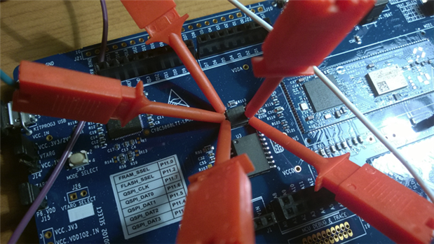

For the experiment I reconfigured application to lower frequency from 50 MHz to 1 MHz. Now let’s see what happens on the bus using Logic analyzer. I have connected logic analyzer to memory using following connection.

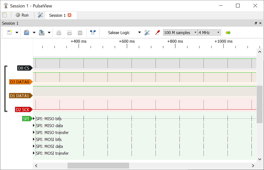

So now I can see what happens on the bus. If you look for overview, It looks as presented on following image. Every 100ms there are some SPI operation on the bus.

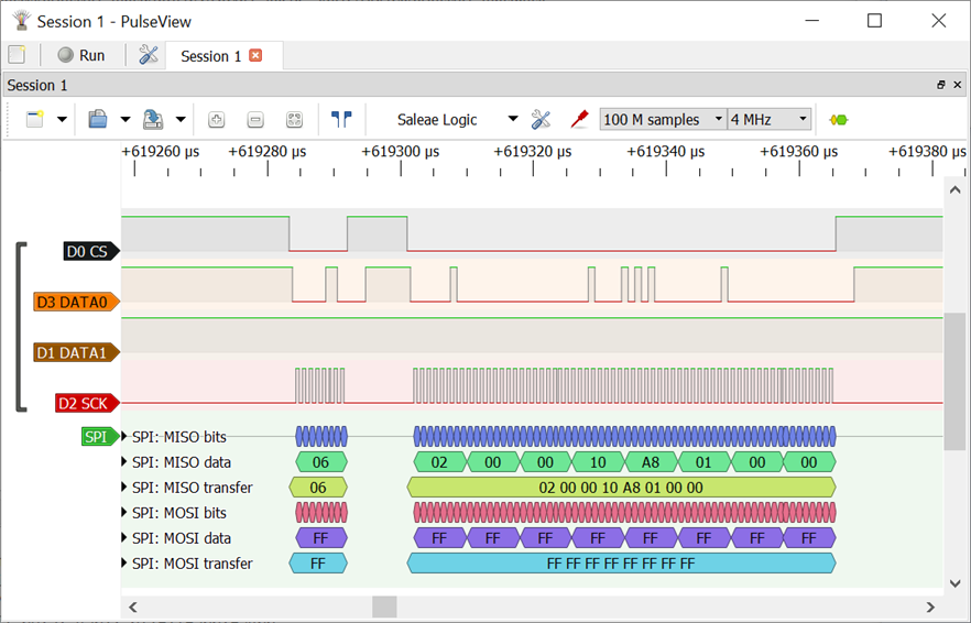

Now let’s look at the detail of one operation (others have the same format and differs only in number stored in data).
There are two operations. The first is command 0x06 which is Write Enable command. The second operations consist of transmitted bytes 0x02 0x00 0x00 0x10 0xA8 0x01 0x00 0x00. The operation code 0x02 means Write operation, then follows 3 bytes of address (0x000010) which is the same address as specified in FRAM_I macro, and then follows four bytes of data (0xA8 0x01 0x00 0x00). Because ARM of PSoC6 is little endian it is uint32_t of value 0x000001A8 (424 in decimal). It is the value of message which was printed at the time when this was sampled.
