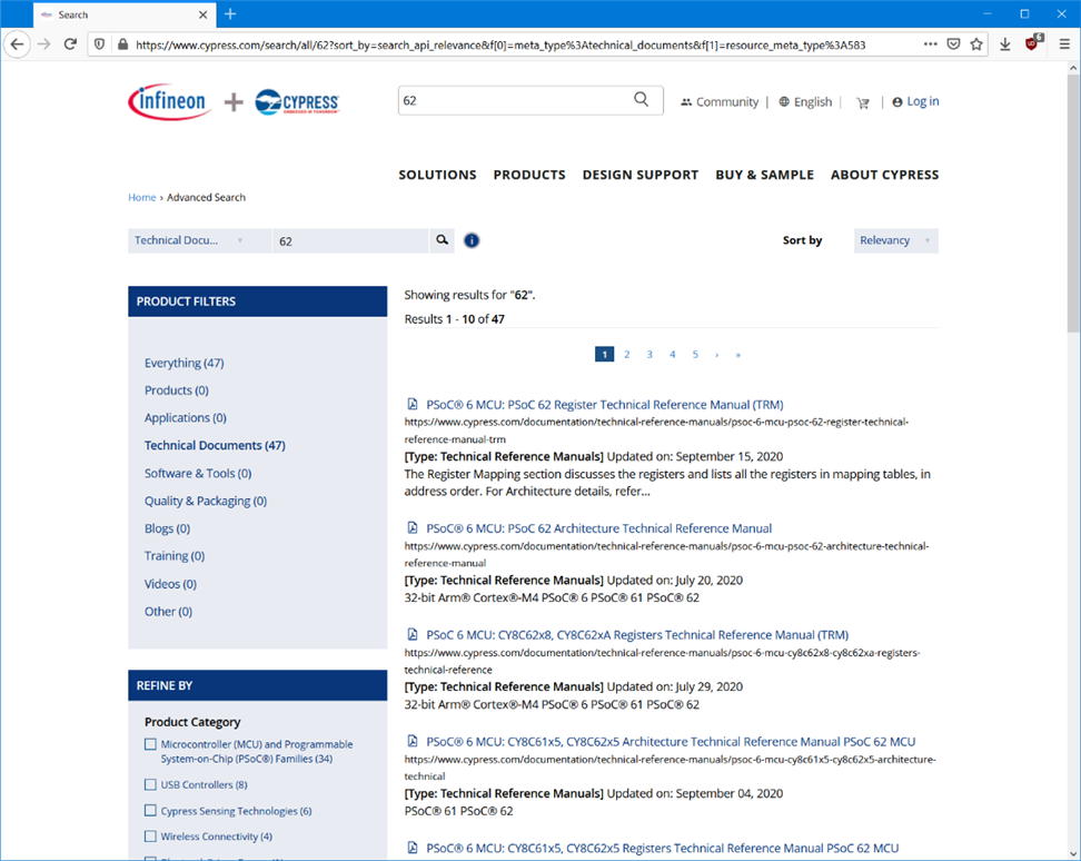

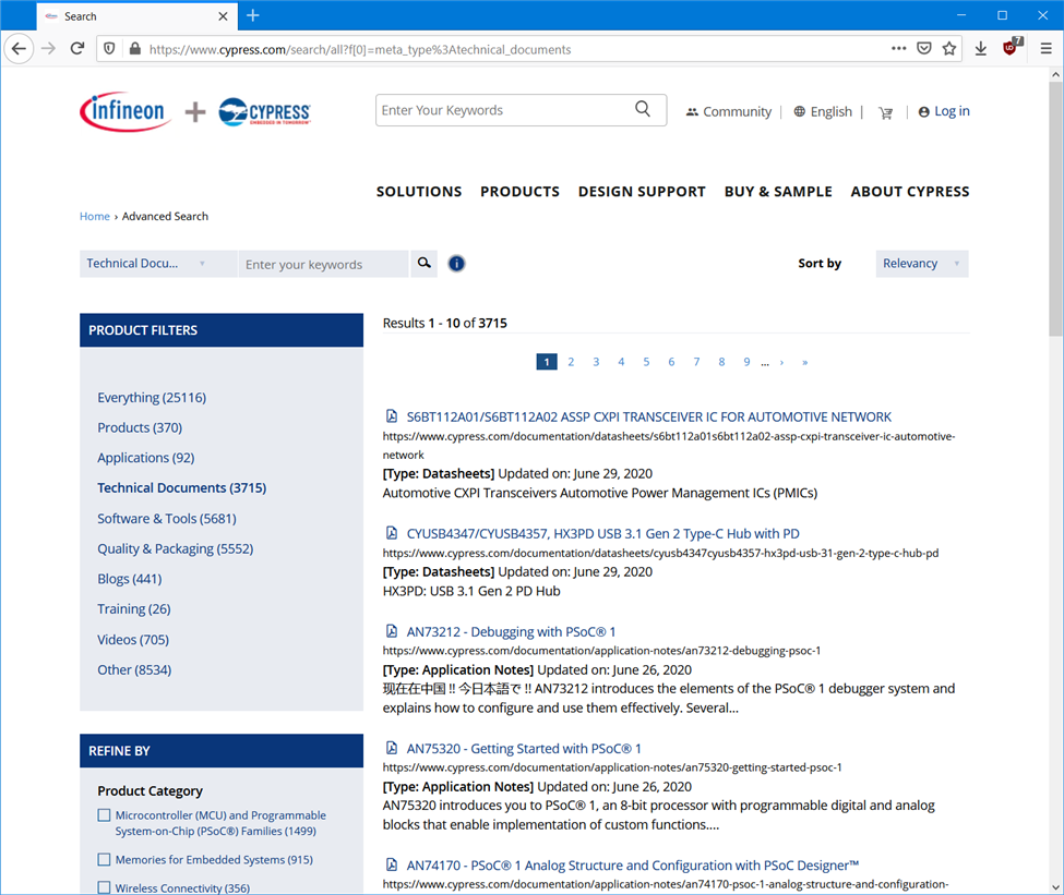

There is tool for searching documentation. It looks as follows.
If you check Resource Type – TRM and then search for “psoc 6” you will get all documents because tool “forgets” that you had selected TRMs filter. If you do that in opposite order (search first, then filter) It will works as expect. If you search for “psoc 6” it will search TRMs for not only 6th family of PSoC. The second issue I had with this tool is not caused by tool itself, but it is caused by nonuniform naming conventions in Cypress. For example, if you search for registry TRM (Cypress has separated TRM to two “books” – Architecture and Registers, I will write about that later) for 62 serie of PSoC you find the following

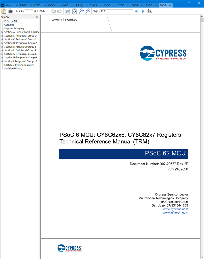

Luckily the first document states that it is Register TRM for PSoC 62 family. But it is not. When you download it and opens that, You will see following document.
As you can see while this TRM is named that target PSoC 62 in fact it targets only subset of that family (models ending with 6 a 7 in main part of name). Onboard MCU is CY8C624A so this document is not the correct one. If you scroll back to picture with search results you can see that the 3rd entry in search is another registers TRM and this matches only models with 8 and A in name. This is correct document, and it has correctly specified his limitation to subfamily in name while the document for other subfamily does not.
I spent a lot of time searching documents using this tool and I think it is very unintuitive. The next problem is that Cypress probably do all documents fully manually and multiple peoples makes them differently. In fact, If they just links correct documents at the main page of every MCU as they have done with application notes this problem disappears naturally.

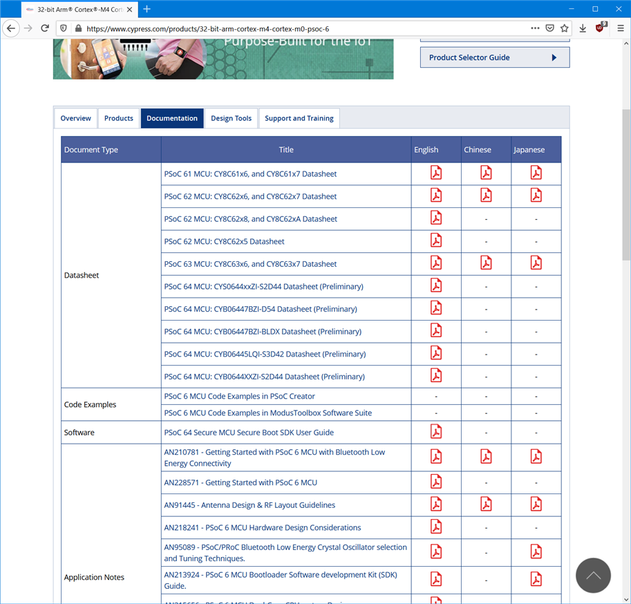

Later I found that at the main page of whole PSoC6 family contains Documentation tab which contains links to all documents with distinguished variants and consistent naming.

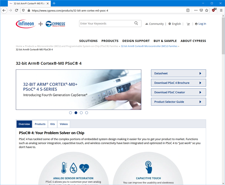

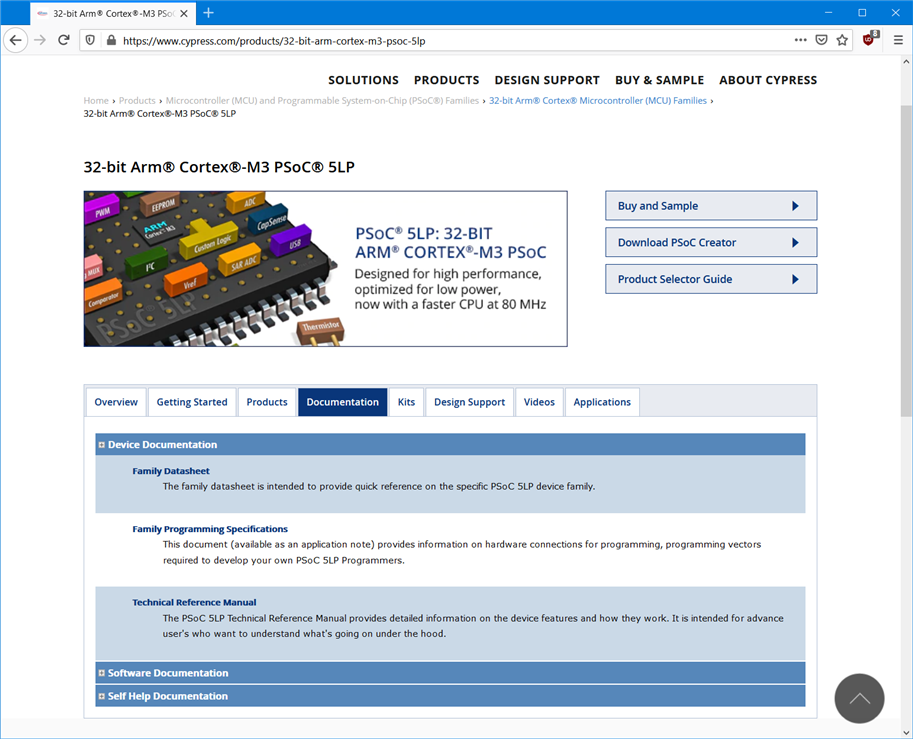

Sadly, as part of review I also looked for other PSoC families but there are the same problems. PSoC 5LP family is probably designed and documented by different team so Documentation tab of the same page looks completely different.
Similarly, I tried PSoC 4. To make searching documentation funny they did not provided any Documentation tab at all.
Lower number families of PSoC like PSoC 1, (PSoC 2 does not exists, but PSoC 1 chips are numbered with 2 in name for some unknown reason) and PSoC 3 are not ARM based so I did not researched them so deep.
To summarize it, I am not satisfied with searching for MCU documentation and they have plenty of ways how to improve that.

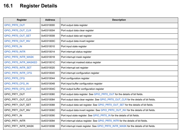

Sometimes I felt that TRMs (Registry and Architecture) are incomplete. TRM should be as most detailed as possible and describe everything without any exception. When developing some applications, I found that library (PDL) mention some registers which are not covered in TRMs. For example, it is CFG_SIO register of GPIO module. If you check PDL definition of registers, you can see that it exists and it is at offset 0x50 from base address of port configuration.

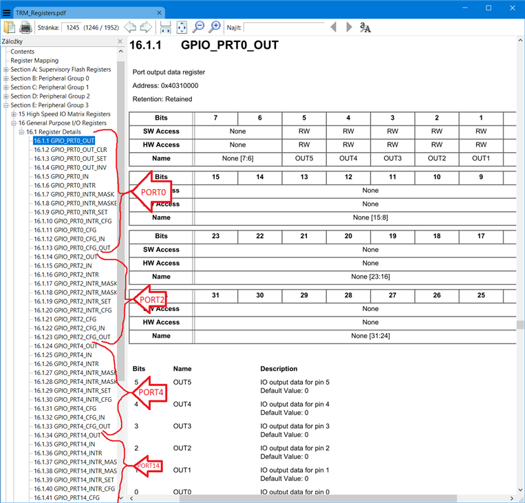

typedef struct {
  __IOM uint32_t OUT; /*!< 0x00000000 Port output data register */
  __IOM uint32_t OUT_CLR; /*!< 0x00000004 Port output data clear register */
  __IOM uint32_t OUT_SET; /*!< 0x00000008 Port output data set register */
  __IOM uint32_t OUT_INV; /*!< 0x0000000C Port output data invert register */
   __IM uint32_t IN; /*!< 0x00000010 Port input state register */
  __IOM uint32_t INTR;                          /*!< 0x00000014 Port interrupt status register */
  __IOM uint32_t INTR_MASK; /*!< 0x00000018 Port interrupt mask register */
   __IM uint32_t INTR_MASKED; /*!< 0x0000001C Port interrupt masked status register */
  __IOM uint32_t INTR_SET; /*!< 0x00000020 Port interrupt set register */
   __IM uint32_t RESERVED[7];
  __IOM uint32_t INTR_CFG; /*!< 0x00000040 Port interrupt configuration register */
  __IOM uint32_t CFG;                           /*!< 0x00000044 Port configuration register */
  __IOM uint32_t CFG_IN; /*!< 0x00000048 Port input buffer configuration register */
  __IOM uint32_t CFG_OUT; /*!< 0x0000004C Port output buffer configuration register */
  __IOM uint32_t CFG_SIO; /*!< 0x00000050 Port SIO configuration register */
   __IM uint32_t RESERVED1;
  __IOM uint32_t CFG_IN_AUTOLVL; /*!< 0x00000058 Port input buffer AUTOLVL configuration register */
   __IM uint32_t RESERVED2[9];
} GPIO_PRT_V2_Type;                             /*!< Size = 128 (0x80) */
Then If you look to the Register TRM, you will see that there is no register at address 0x40310050 described. Last described of PRT1 module is at offset 0x4C.
I asked at Cypress Community (https://community.cypress.com/message/267587) about it. Answer was that reason for it is some reservation for feature use and register do not exists in chip while it is referred in PDL code.
Similarly, there are (probably?) undescribed features in Architecture TRM. For example, USB block has USBFS0_USBDEV_OSCLK_DR0 register with description “Oscillator lock data register 0” but in Architecture TRM there is no description of any oscillator lock feature. I think that Cypress should spend some time to make a lot of features described in more detail.
Unless undescribed features TRM is good document and I like it. It is well structured and written by humans for humans. TRM notices lot of things in very familiar way. For example, I can note recommendation for I2C pullups which are described without long description of rocket science and Cypress’s description makes sense.
Next thing I like in Register TRM is navigation. At beginning of every chapter is table describing all relevant registers. All registers contain absolute address which is good when you are searching for some information in some debug state or when you are reversing firmware. If you have read chapter Review of Microcontroller you know that PSoC is not a just MCU, it is chip containing multiple blocks interconnected in interesting way, but some same blocks differ a little. In navigation menu provided by PDF reader you can simply see determine how blocks differs without directly searching for them. As you can see at following screenshot duplicate registers are not mentioned in menu. You can very simply guess that for example register related to PORT1 matches the same structure as PORT0 just from seeing menu. Similarly, you can guess that register related to GPIO port 2 differs from port 0 (and 1).

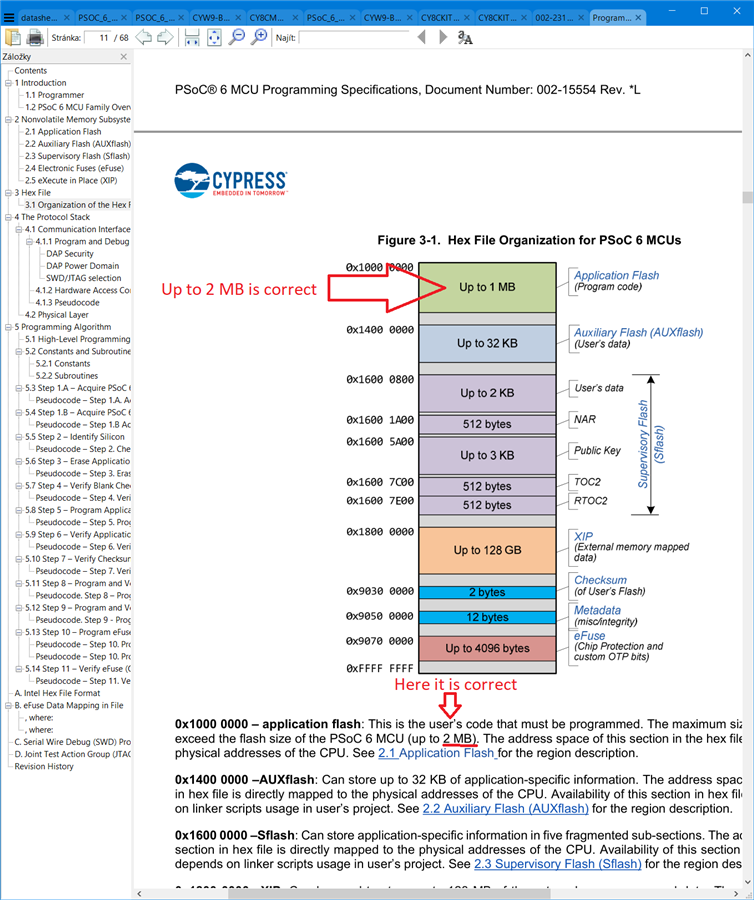

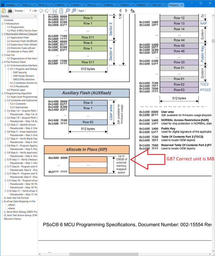

Programming manual Is document with detailed information related to flashing firmware, memory layouts and similar things. It does not contain any description of instruction set. Instruction set you must search at ARM website if you are interested in detail about it. I found some minor mistakes in that document. For example, memory layout mention that you can use 128GB (yes, GB) for XIP technology. This is totally non-sense because whole 32 bit range allows for addressing only 4 GB (GiB to be clear) of data. Author of document mistaken the units. Correct value is 128MB (MiB to be clear).
4 pages later there are mentioned that application is sized up to 1 MB but in fact roadtested unit has 2MiB Flash. In the text below the image, it is correct. They probably forget to update that number when they announced first chip with more than 1 MB of flash.
But except that minor issues that document is good. You probably never want to read him but when needed it is ok.
