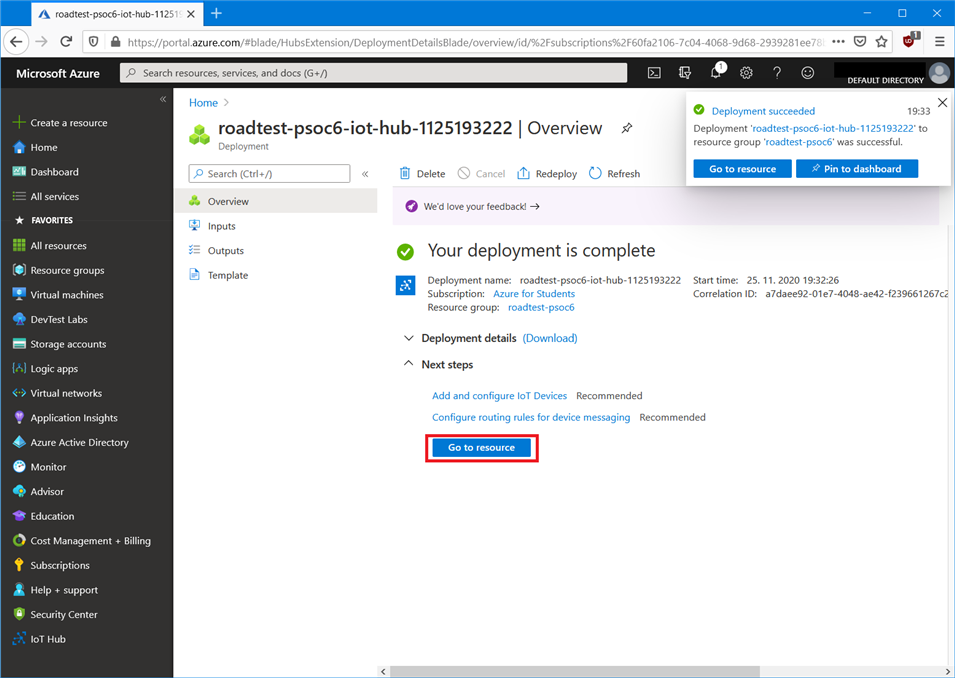

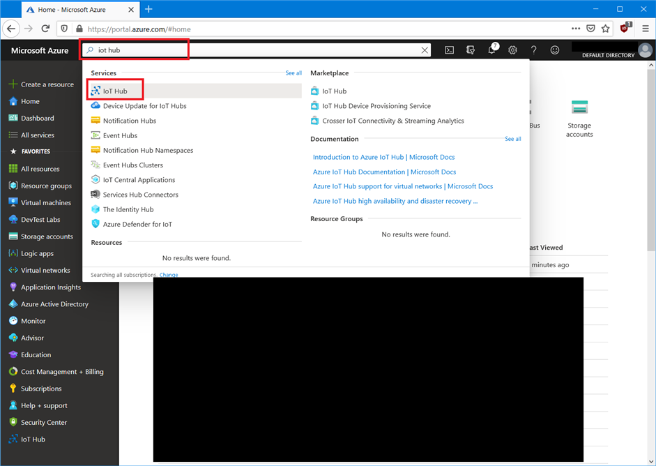

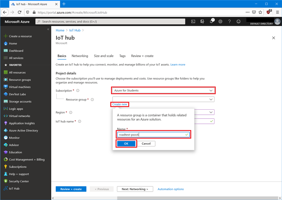

Until there it was the same as for AWS variant of this tutorial. Now login to the Azure portal and search for IoT Hub. Then go to IoT Hub administration.

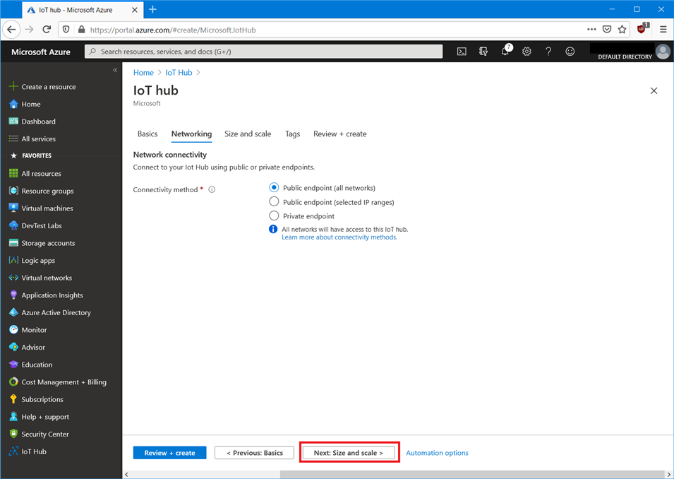

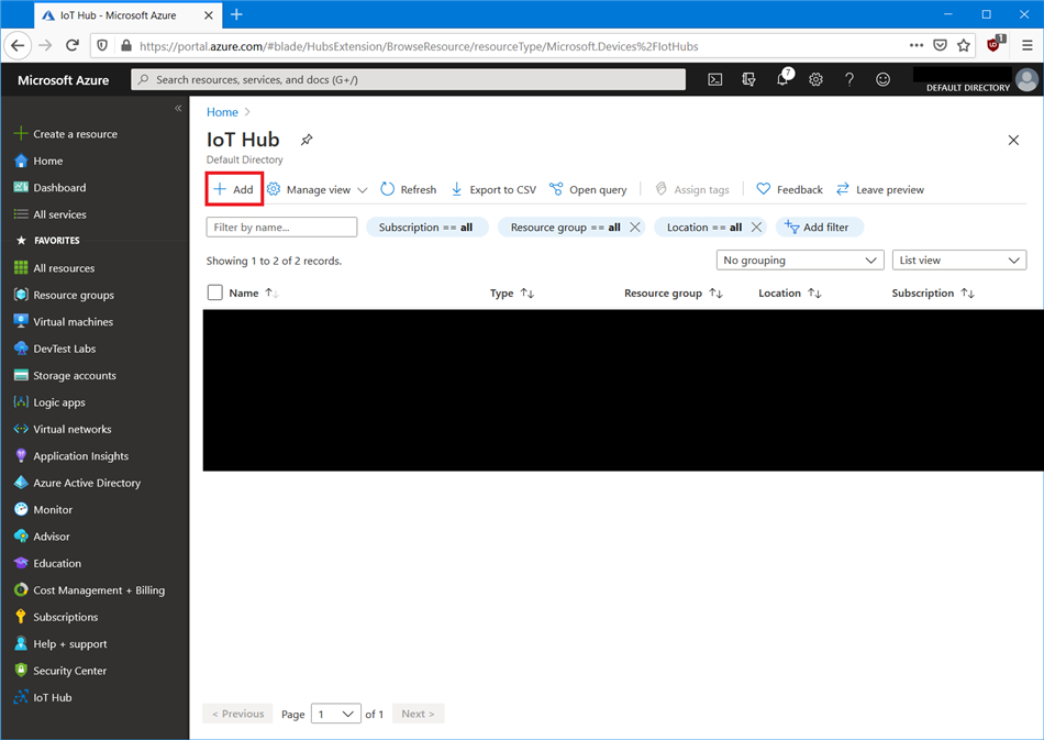

Create new IoT Hub using Add button.
Select the Azure subscription under what you want to run project and create new resource group for all resources created in this tutorial.
Then select nearest Azure region, enter some name for new IoT hub and continue by Next: Networking button.
At this page do not change anything. Continue using Next: Size and Scale button.
Open the Pricing and scale tier selector and select F1: Free tier. Then press Review + create button.
Confirm by Create button.
After a while you will see that Deployment was successful and IoT Hub was created. Press Go to resource.

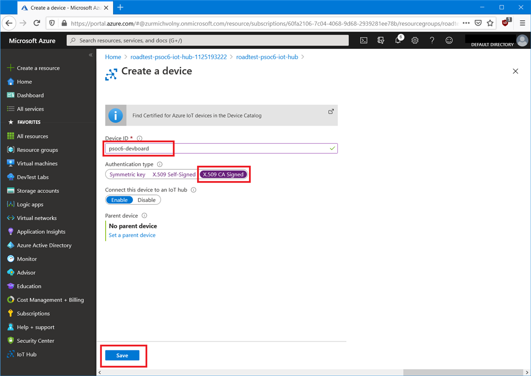

Go to IoT devices and click New.
Specify Device ID as the same name which you have used as CN in device certificate created before. Select Authentication type to X.509 CA Signed and confirm by Save.

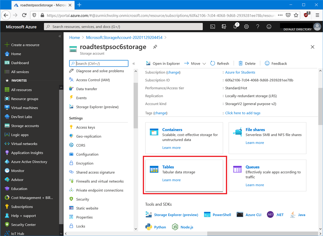

Saving data to Azure Table Storage

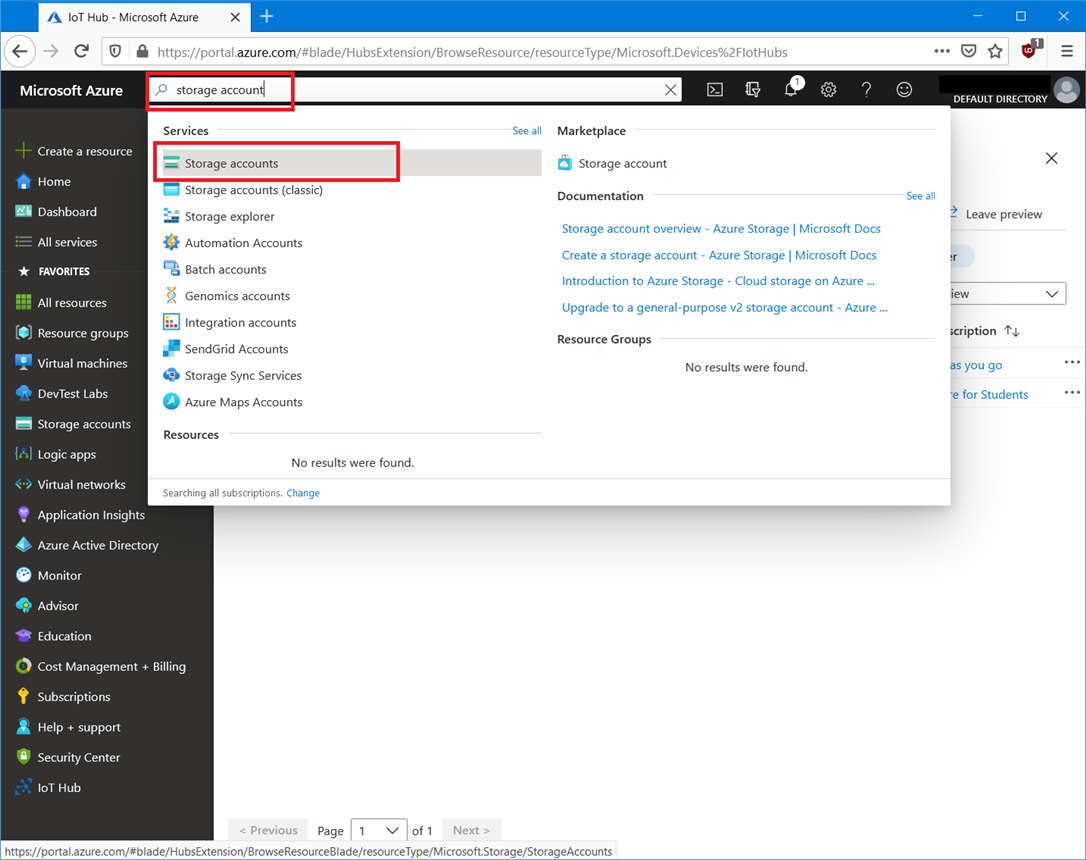

Go to Storage Accounts administration in Azure portal.

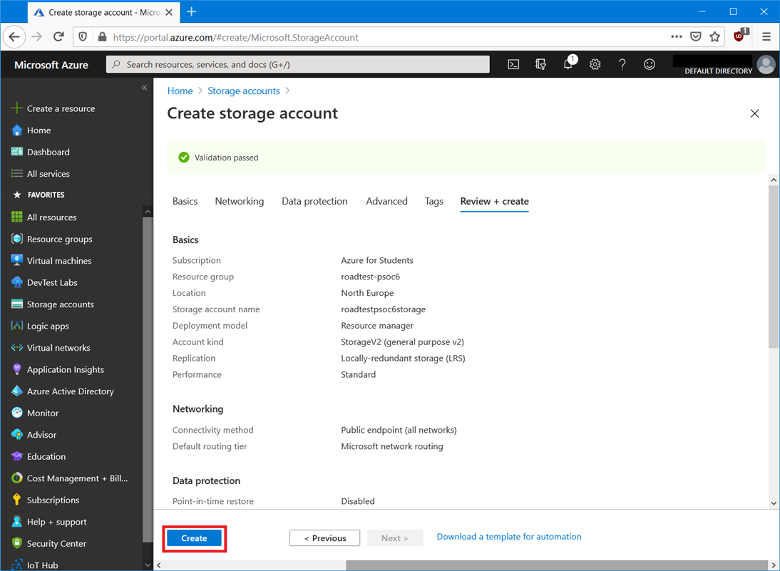

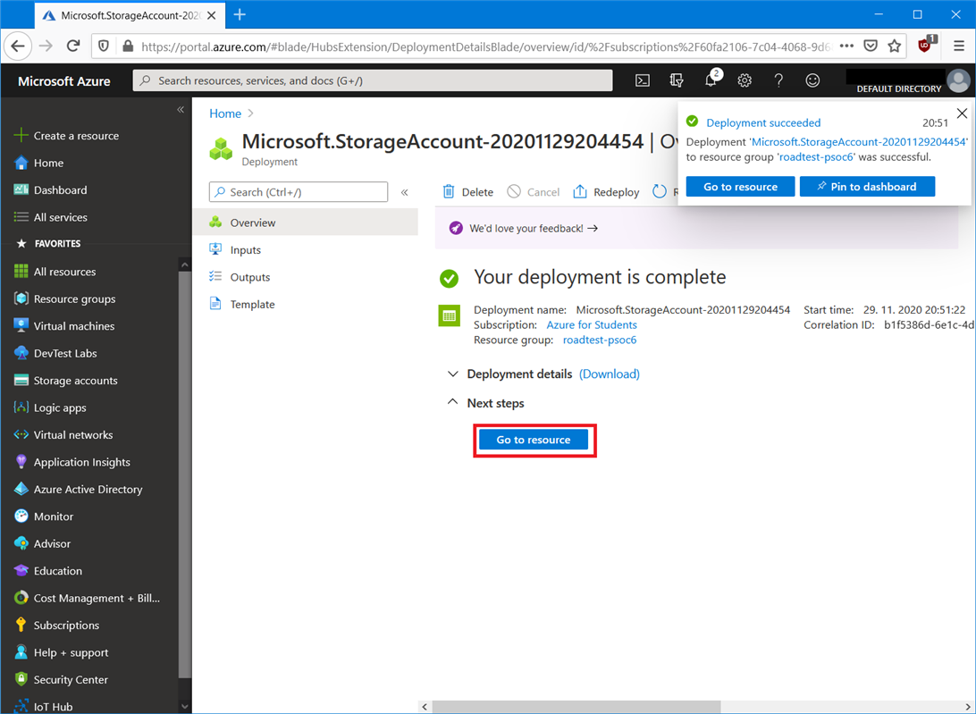

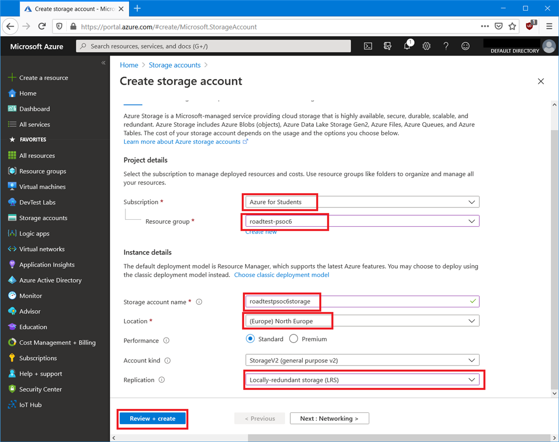

Click add.
Select subscription and resource group. Enter some name for storage account, select data center near to you and switch replication to LRS if you want lower prices. Then continue by Review + Create.
Confirm by Create.
After a while your storage Account become create. Click Go to resource.

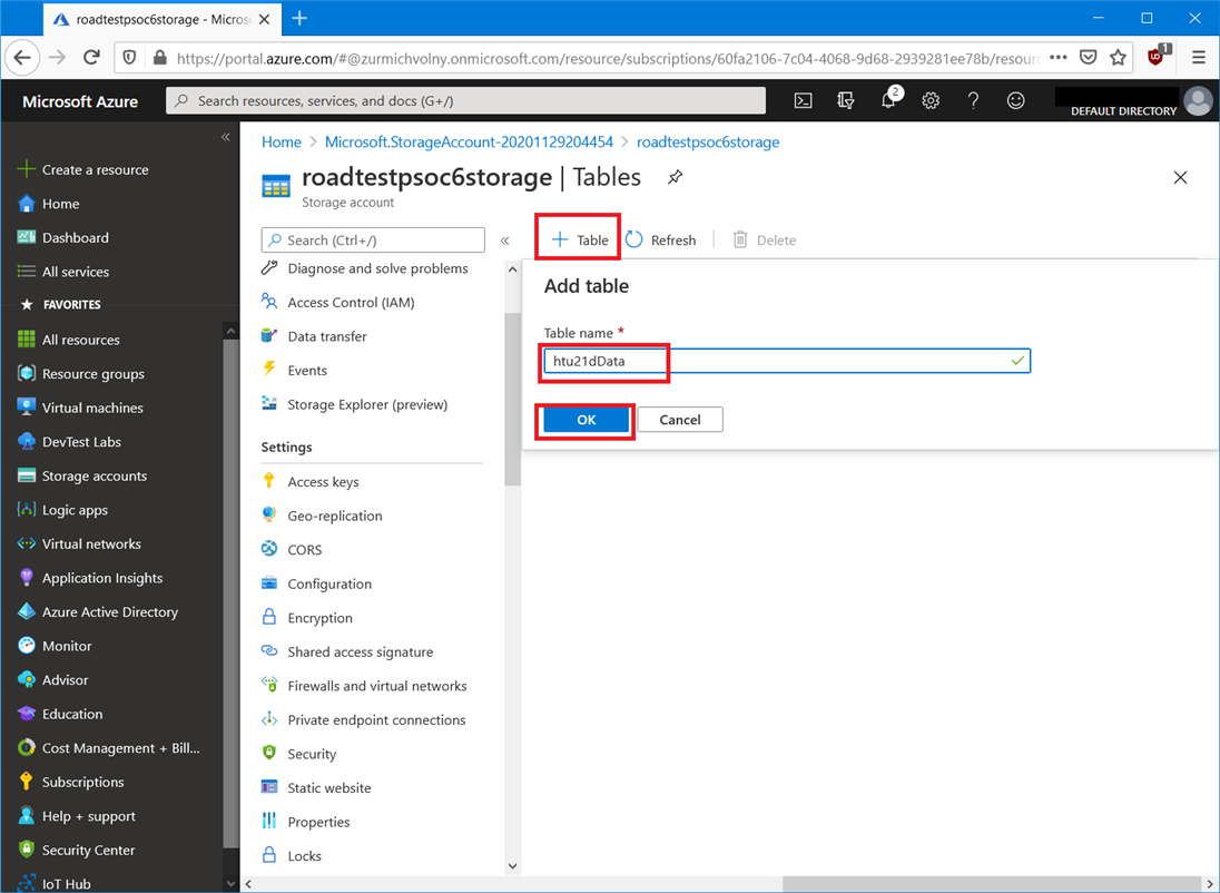

Go to Tables.
Press Add button. Enter some name for table and confirm by OK.
We have successfully created table for humidity and temperature data. Now we need to make some interconnection between IoT Hub (which receives data from device) to the DB. IoT Hub supports forwarding data to multiple kinds of services. We will use service bus to queueing received data and logic app for processing. Let’s create service bus.

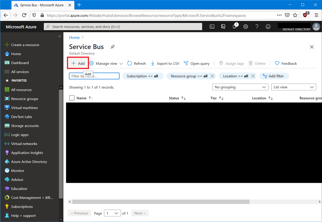

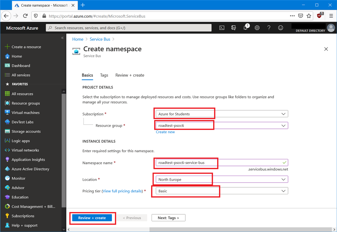

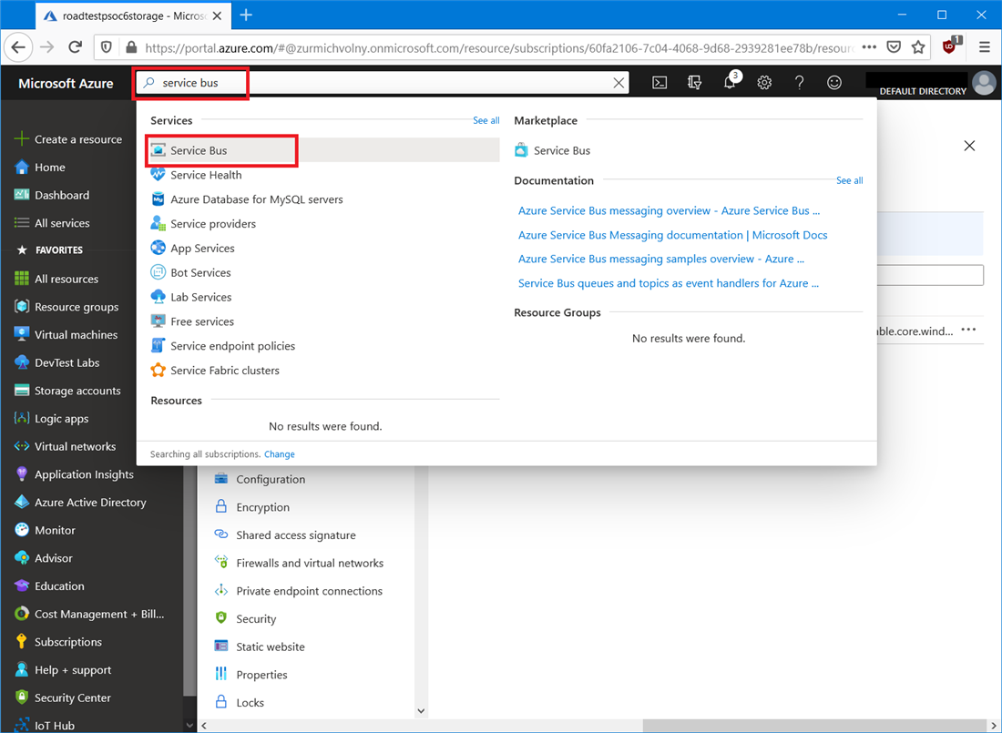

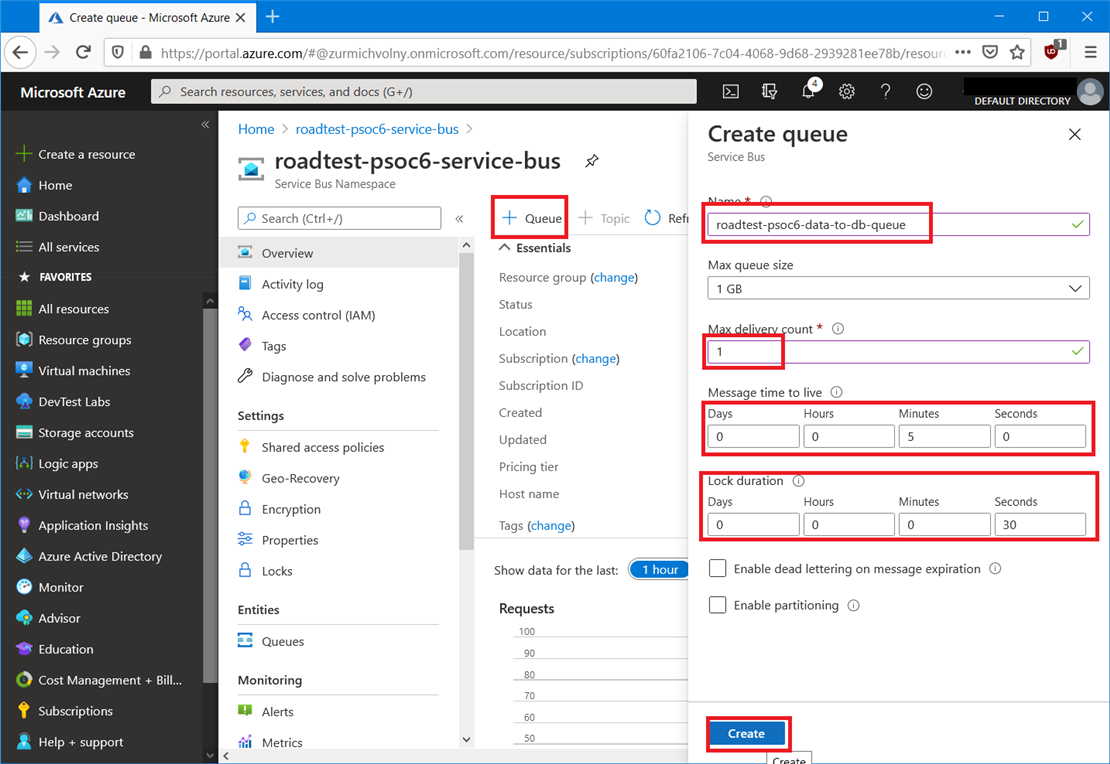

Press Add to create new service bus.
Select subscription and resource group. Enter some name for service bus, choose data center near to you and select Basic pricing tier which is the cheapest. Continue by Review + Create.
  Confirm by Create.
After a while service bus become created for you. Continue by Go to resource.
Click add queue. Enter some name for queue, change Max delivery count to 0, time to live to 5 minutes and lock duration to 30 seconds. Then confirm by Create.

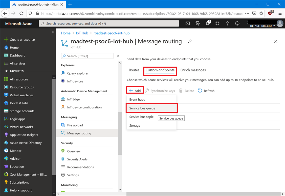

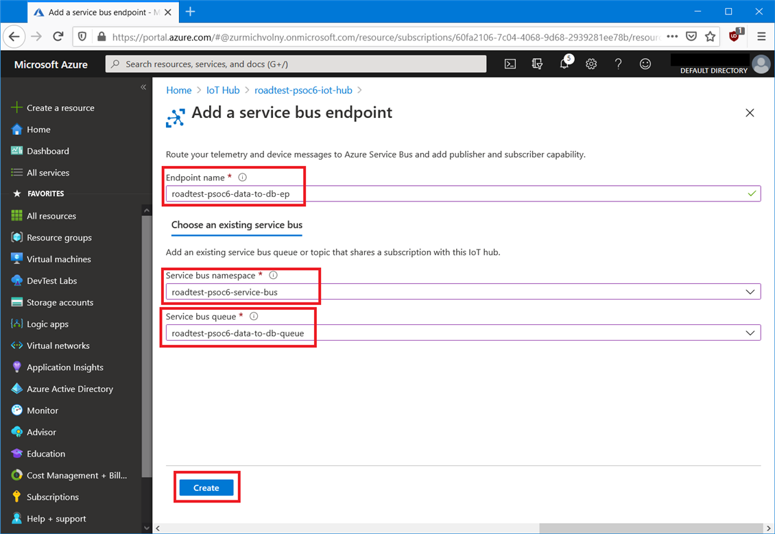

Go back to your IoT Hub and navigate to Message Routing in menu.
Switch to Custom endpoints tab and click Add and continue by Service bus queue.
Type some name, select service bus and queue created in previous step. Confirm by Create.
Switch to Routes tab and click Add.
Enter some name, choose endpoint created in previous step, and confirm by Save.

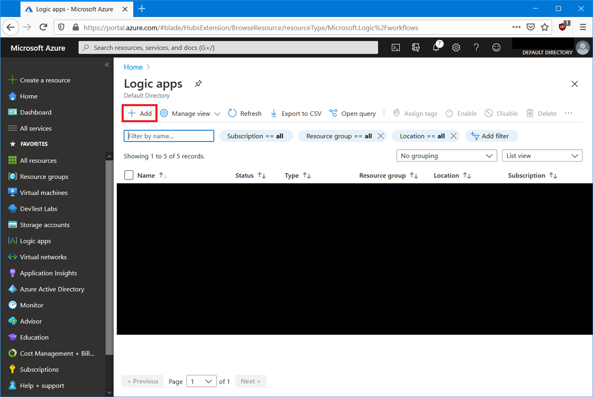

Go to Logic Apps.
Create new logic app.

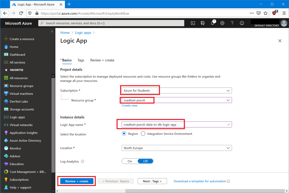

Select subscription and resource group. Enter some name and confirm by Review + Create.
Confirm by Create.

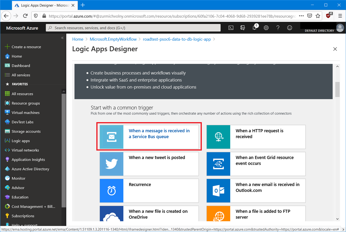

After a while, Logic app become created for you. Continue by Go to resource.
Editor of Logic app will occur. AS the trigger choose When a message is received in Service Bus Queue.
Continue by Create button.

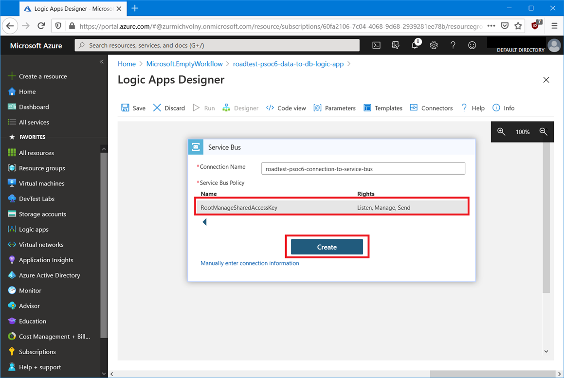

Enter some name of the connection and select service bus.
Click predefined name and rights for connection. Continue by Create.
Then continue by Continue button.

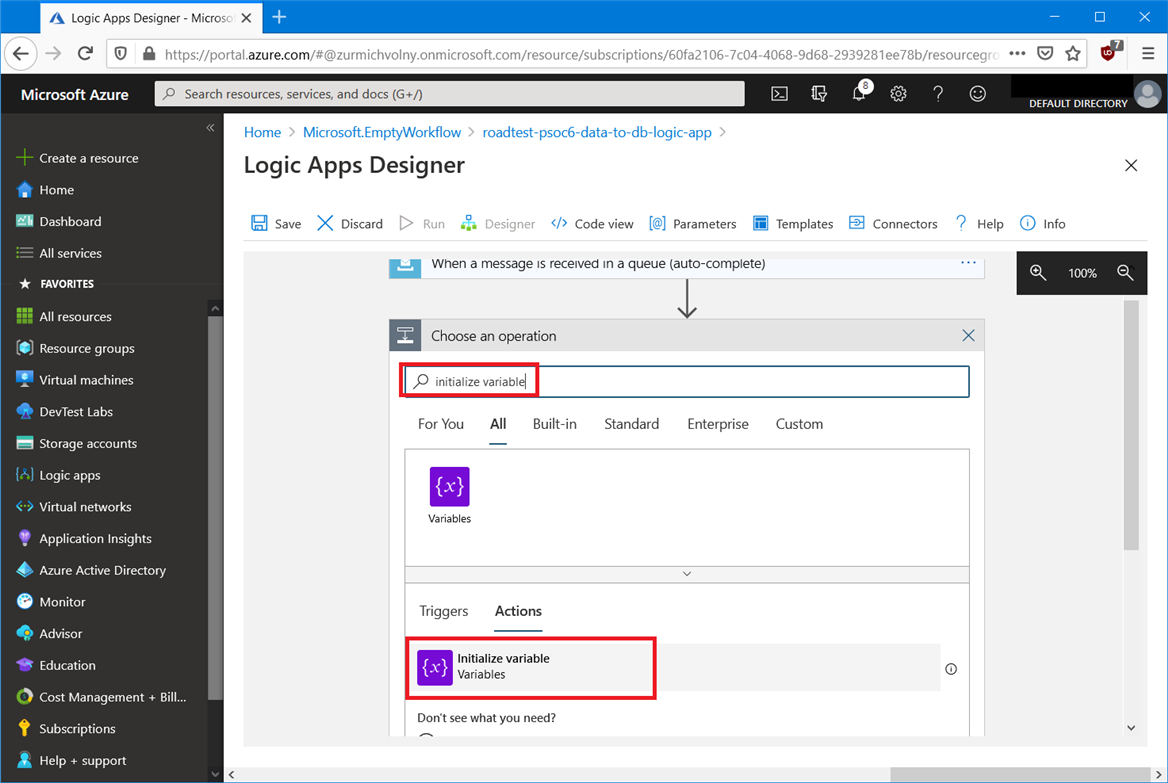

Select queue and change checking frequency to 1 minute. Then continue by New step.

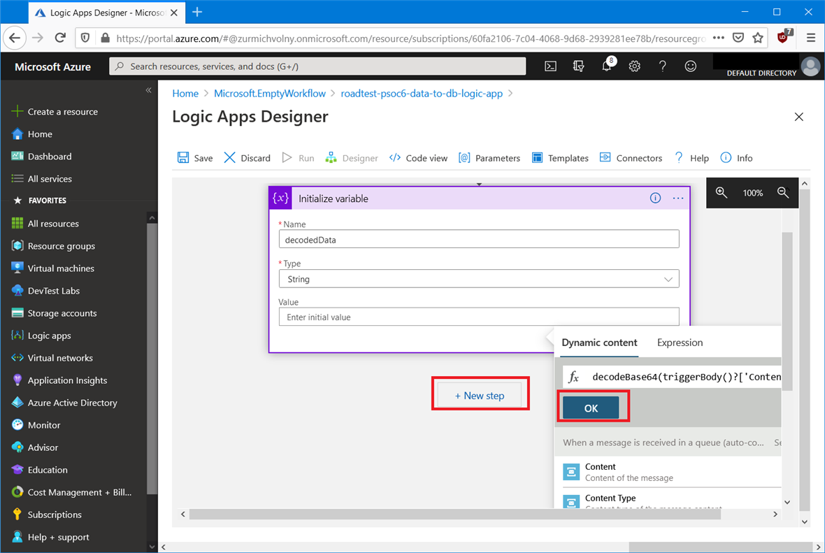

This logic app gets the data from Iot Hub as input. It receives data in RAW format. Because IoT Hub supports receiving any data It encodes it in base64 format. So as first we will decode received data and stores them in variable. Search for Initialize variable and select that action.
Enter some name for variable. Type set as String. Click to Enter initial value. Switch to Expression tab and type decodeBase64(). Place cursor between brackets.
Switch to Dynamic content and select Content of the message.
Confirm by OK. Create New step.

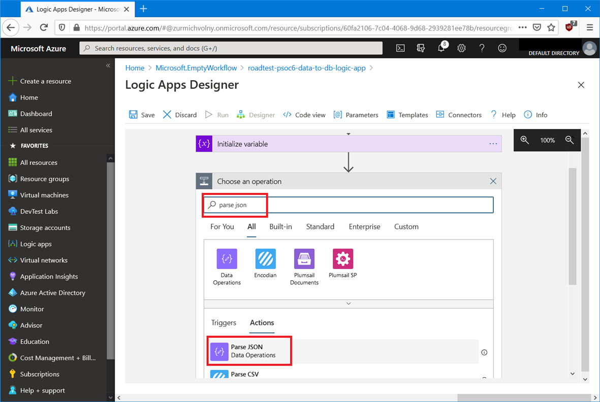

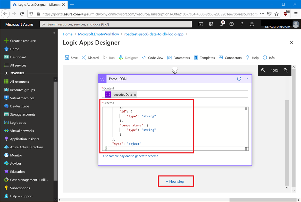

Now we need parse JSON from data. We will reformat it a little and then build new data. Search for parse JSON and select that action.
Select variable from previous step as source for Content.
Copy following schema and continue by New step.
    "properties": {
        "humidity": {
            "type": "string"
        "id": {
            "type": "string"
        "temperature": {
            "type": "string"
    "type": "object"

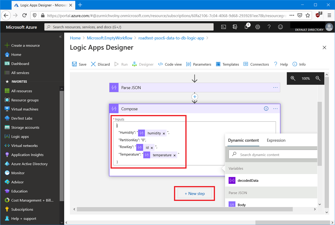

Search for Compose operation.
Now create a new JSON in format for Azure table DB. It must have RowKey and PartitionKey set. Use 0 as partition key and id field from parsed JSON as value of RowKey. Also include Humidity and Temperature fields. Use Dynamic content to include parsed fields. You can safely use enter in this field. Actions should look as follows. Then continue by New step.

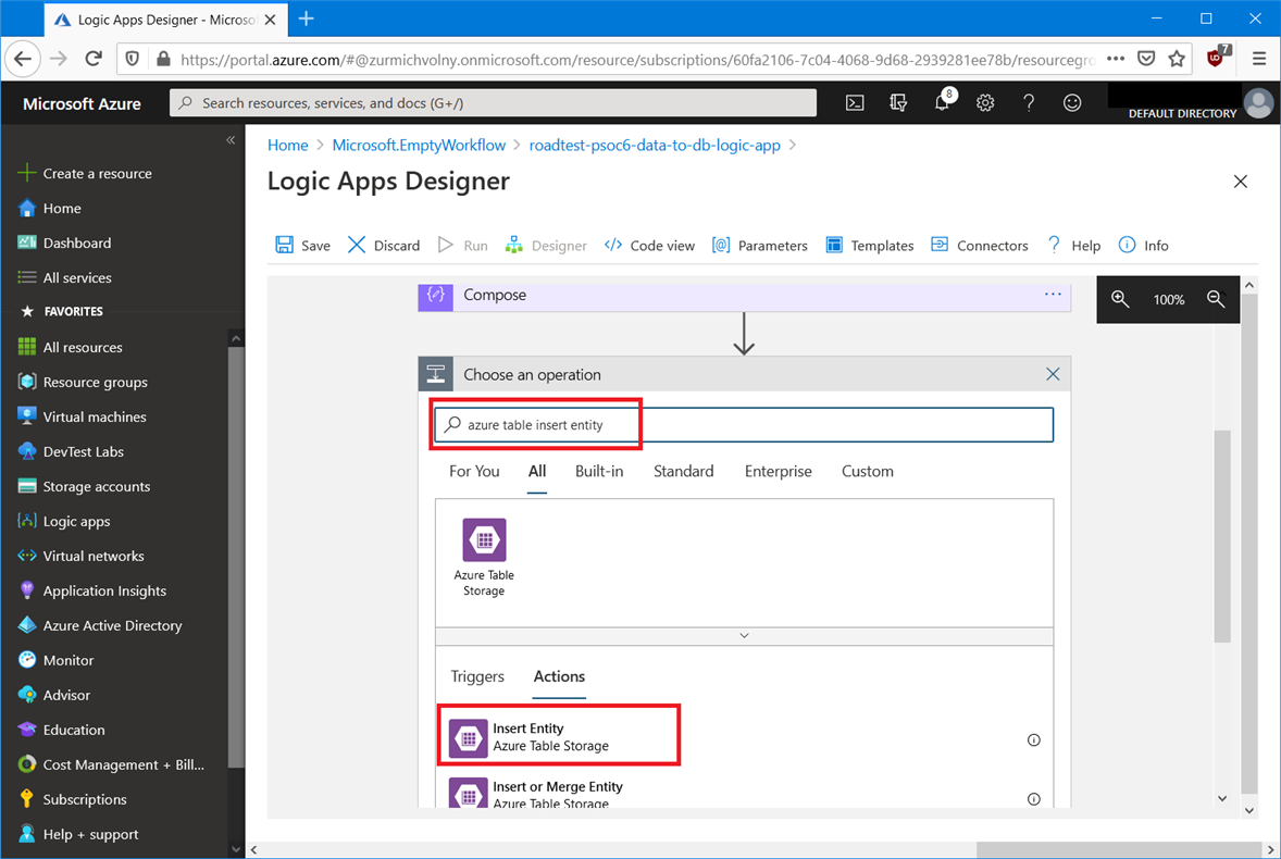

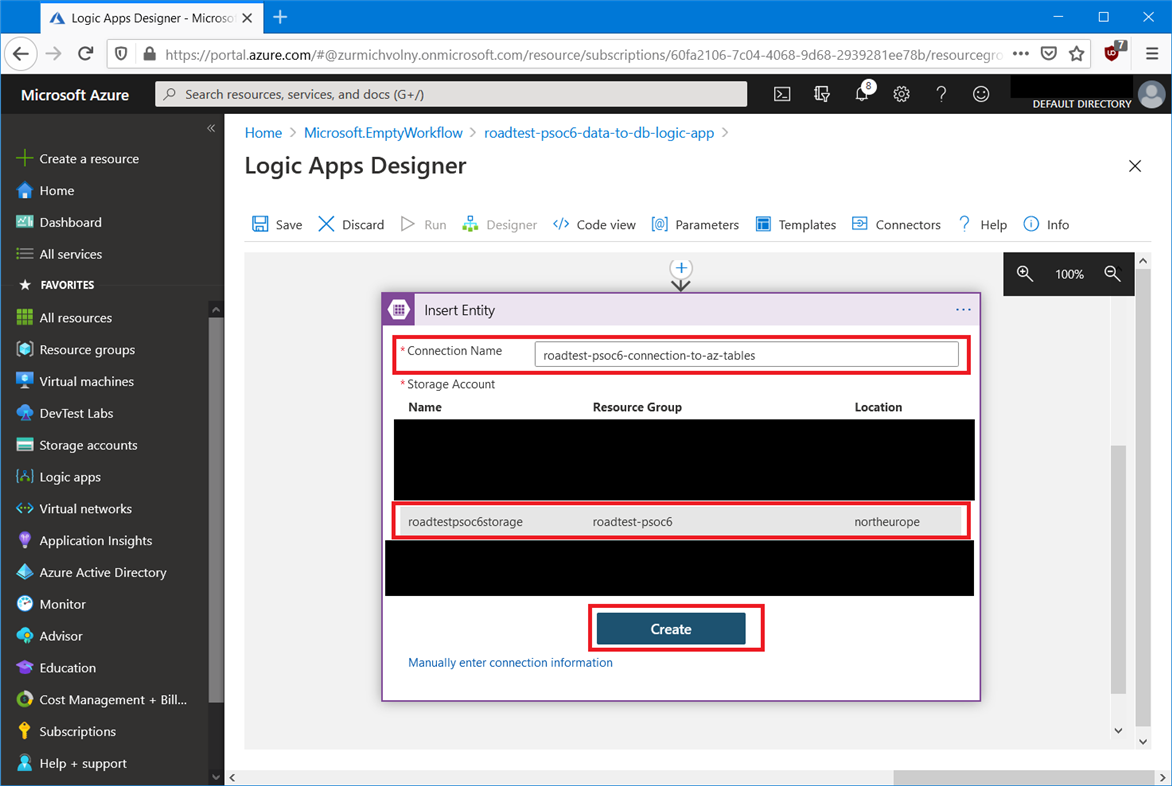

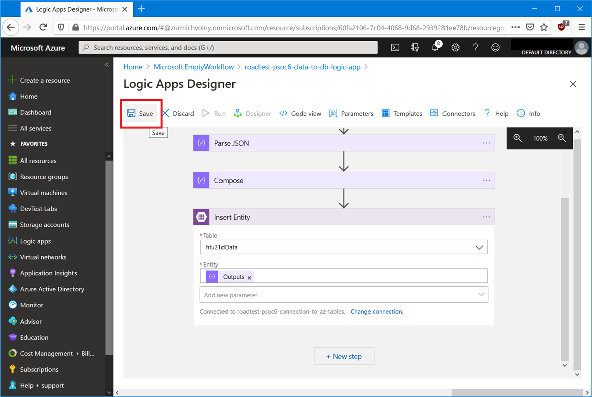

Search for Insert Entity of Azure Table Storage and select them.
Enter some name for connection to Azure Storage, select storage account and continue by Create.
Select created table and outputs of Compose command as source for inserted entity.
Then press Save.

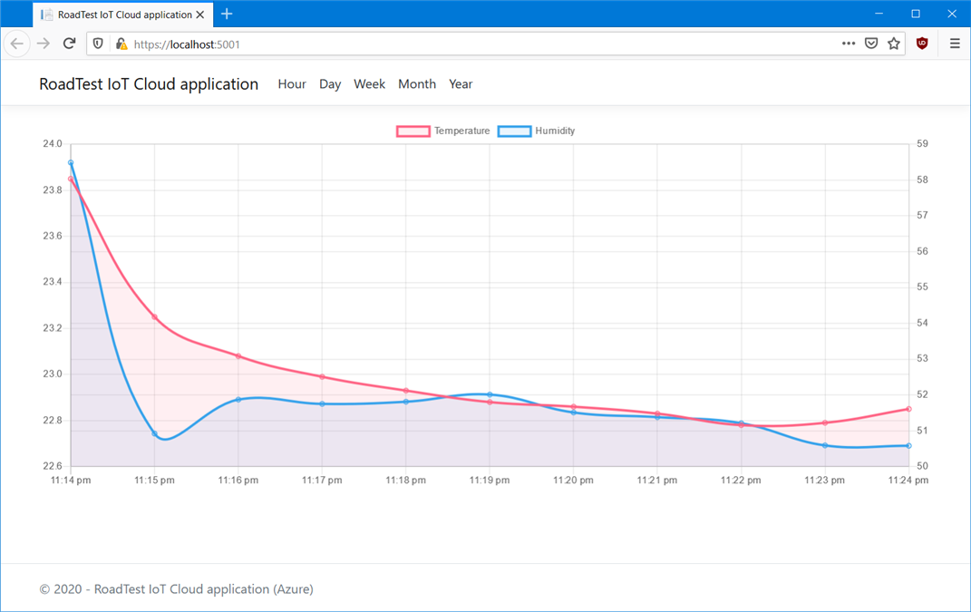

And that is all. I create web administration in ASP.NET Core which is out of scope of this tutorial. You can find them with source codes at the end of this article. You must modify it with credentials for your Azure Account.
Web interface to cloud data
I have created ASP.NET Core application that connects to Azure Table and renders chart with measured data. His description is outside of scope of this roadtest review. This application is available to download with source at the bottom of this article. It is Visual Studio solution. You have to update Azure credentials in appsettings.json file before running. You need to generate SAS. You can do that in Azure Portal in Shared Access Signature of Storage account.
After some minutes you can see data in charts in web application.
