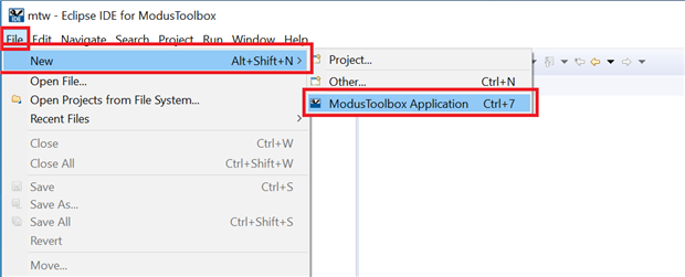

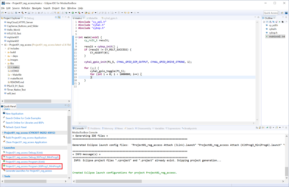

Create project in ModusToolbox IDE

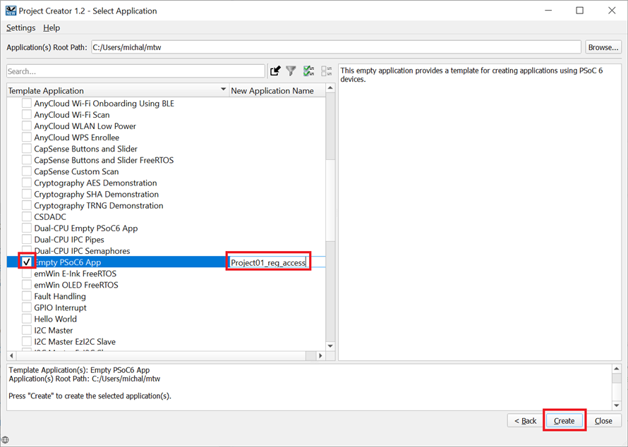

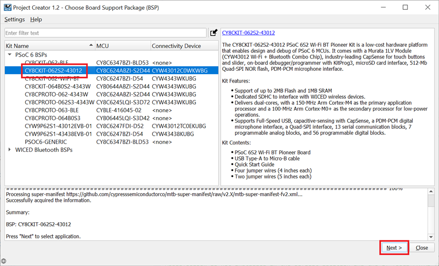

At first you need to open ModusToolbox IDE and create new project. To do that select File > New > ModusToolbox Application. Do not choose new Project.
The dialog window will appear. At the first page of wizard choose the correct development board. If you remember, in the chapter “Review of development board” I mentioned that the most import name of board is “CY8CKIT-062S2-43012” and you see it again. The click Next.
At the second page select the type of Application. You can select same example app if you begin with the board but in this tutorial lets select Empty PSoC6 App. Do not forget to type the name of project next to his type. Then press create.
Then in Quick Panel will appear 4 additional buttons enabling you to run or debug app. Both in two variants for J-Link (you do not need this) and KitProg3 (you need this). KitProg3 is onboard programmer. J-Link you use if you debug external (even custom designed) board using external standalone programmer. In this example I will use only integrated KitProg3.

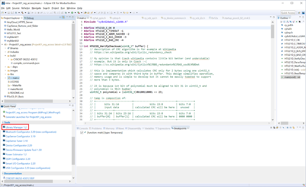

For making code completion working I recommend to building project. This cause eclipse to know details about building environment and learn what files can analyze for code completion.

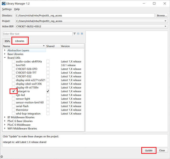

Later we will need prints floats using printf function (and send it over UART). By default, standard functions do not support printing floats because float related code occupies a lot of flash and ram memory. Tiny hack how to make support for floats is include retarget-io library. This library is designed to retarget printf calls to UART. We will not do that in this example because this example controls all peripheral using registry access (not a printf) but including this library into project will bring us support for formatting float using snprintf function. To include library to project, select Library Manager in Quick Panel.
In Library Manager switch to Libraries tab and select retarget-io library. Then press Update button. In bottom text area you can see progress of cloning library from GitHub. After library will be downloaded and included into project Close the window.

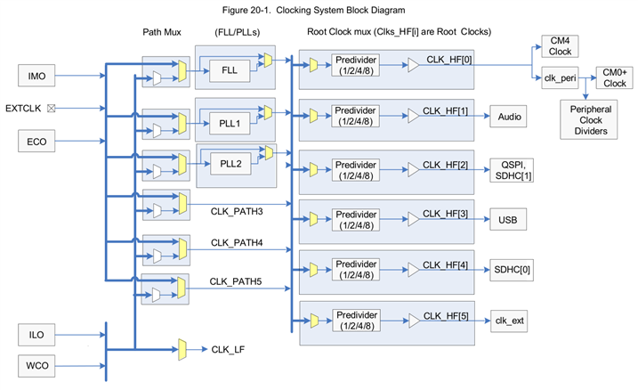

Setup clock of MCU
The first what we must do is setup whole clock system of the MCU to get it running on expected speeds and setup clocks for other peripherals and secondary Cortex M0 core. I will configure clock using PLL which get 8MHz internal oscillator as input and will output clock at speed of 100MHz. Main Core of MCU can run at higher speed (up to 150 MHz) but for simplicity I will configure it to 100 Mhz. Note that this is also default configuration of lot a of projects created by ModusToolbox. If you are using PDL or HAL the first call in main usually is cybsp_init function which will do similar work what I do in this section. It does a much more, but I will not use that in this example.
You may remember the era of 8bit MCUs where you do not need to configure any clocks (with some exceptions like divider for SPI bus and so on). In nowadays MCUs it is much more complicated because they are expected to run much faster and their clock system provides lot of functionality that 8bits never offered. PSoC6 contains also tons of features in clock subsystem and it offers a lot of features in clock subsystem then many other ARM competitors. More details about clock subsystem you can find in chapter “Review of microcontroller”. In this part I will only briefly describe what it can do and how to configure it. Clock system for PSoC6 is in TRM described by this image.
I will use only part of it. I will use only IMO, PLL1 and Clk_HF[0]. Later I will also configure Peripheral Clock Dividers when configuring peripherals.
The initialization of clock system I will do in function SYSTEM_Init. So, create this function and call it from main.

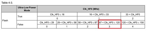

Because we will increase the speed of core, we must handle little side effect which occur when running on high speeds. The Core executes instructions from some memory. It should be Flash, RAM or some external one. In my program it will be flash only, but RAM will be also accessed. The side effect is that while core can run at high speed the memory should not be able to feed core with instructions so fast. Because that we must add some latency to accessing memory. For SRAM it is problem only when running in ultra-low powered mode. For flash it is problem in both modes. In TRM you can find how much wait states you need to setup. Answer for 100 MHz is shown in following table.
So, I must configure number of wait states of flash controller to 3. At the lowest level it could be done using following command which directly writes the correct value to register. In TRM you can find details about this register.
FLASHC->FLASH_CTL = 0x00000003;

As I mentioned before I will use internal 8MHz oscillator as the source for PLL so I must enable it first. This can be done using this command.
SRSS->CLK_IMO_CONFIG = 0x80000000;
Now the internal oscillator is running, and I will configure PLL itself. From the TRM you can decode following formula to calculate output frequency.
output freq = ((input / reference_divider) * feedback_divider) / output_divider
input is 8MHz and I need to configure reference_divider, feedback_divider and output_divider. There are some restrictions about that values and you can find them in TRM.
I selected following values:
  • reference_divider as 2
  • feedback_divider as 50
  • output_divider as 2
This results into formula ((8M / 2) * 50) / 2 which is expected 100 MHz. The following code configure PLL with these values.
SRSS->CLK_PLL_CONFIG[0] =
            (2 << 16) | // output divider is 2
            (2 << 8) | // reference divider is 2
            (50 << 0); // feedback divider is 50
When the PLL is configured We can enable it. We cannot do it in the same write instruction as the configuration is done. We will enable it in next instruction.  Add command that set flag in this register. This efficiently enables the PLL.
SRSS->CLK_PLL_CONFIG[0] |= 0x80000000;
The PLL does not starts immediately but it may take some time. Wait until it gets locked at the correct frequency. We will wait until it became locked with the following loop.
while ((SRSS->CLK_PLL_STATUS[0] & 0x00000001) == 0) {}
Now PLL works and at output is 100 MHz clock. As last we must configure that the clock to the core is clock from PLL because we can route different clocks to different parts of system. Following command configures PLL as the source for Cortex M4 core, peripherals and also for Cortex M0 core. Clocks for peripherals and M0 core can be also divided if required but I wont do that in this project.
SRSS->CLK_ROOT_SELECT[0] =
            0x80000000 | // enable first root clock (clocks to ARM cores and peripherals)
            0x00000001;  // use PATH1 (PLL0) as source

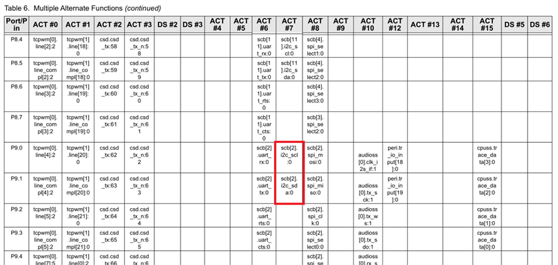

The first thing to do is selected mode of SCB block. Except I2C it supports UART and SPI. I2C is default but in the same register we must selected that we are working with bytes (8bit) and not words (16bit).
SCB2->CTRL = 0x00000800;
Now we must do I2C specific configuration of the block. Following command will set I2C mode (master/slave), sets the flag that SCB will NACK the transaction in case the internal buffer became full and set oversampling to 10. Oversampling is used to choose how much clock cycles will be used for sampling/emitting the low and high part of bit transfer. In I2C there may be requirements to duty cycle different from 50% So you can select a ration using this setting. I am setting ration of 1:1 (50% duty cycle). One half of bit transfer will be 10 clock cycles (in register it is written with -1 offset, because value of 0 does not makes sense). Totally transmission of one bit takes 20 clock cycles of internal clock.

Configuration of HSIOM is done using following command.
HSIOM_PRT9->PORT_SEL0 =
            0x00000013 | // set alternative action of P9_0 to ACT_7
            0x00001300;  // set alternative action of P9_1 to ACT_7
Now We will configure GPIO ports to be driven as open drain with external pullup (pullup means that line is driven low by I2C node, otherwise it is driven high by pullup). Configuration is done using following command.
GPIO_PRT9->CFG =
            0x00000004 | // set drive low mode on P9_0
            0x00000008 | // enable input buffer on P9_0
            0x00000040 | // set P9_1 to drive low mode
            0x00000080;  // enable input buffer on P9_1
