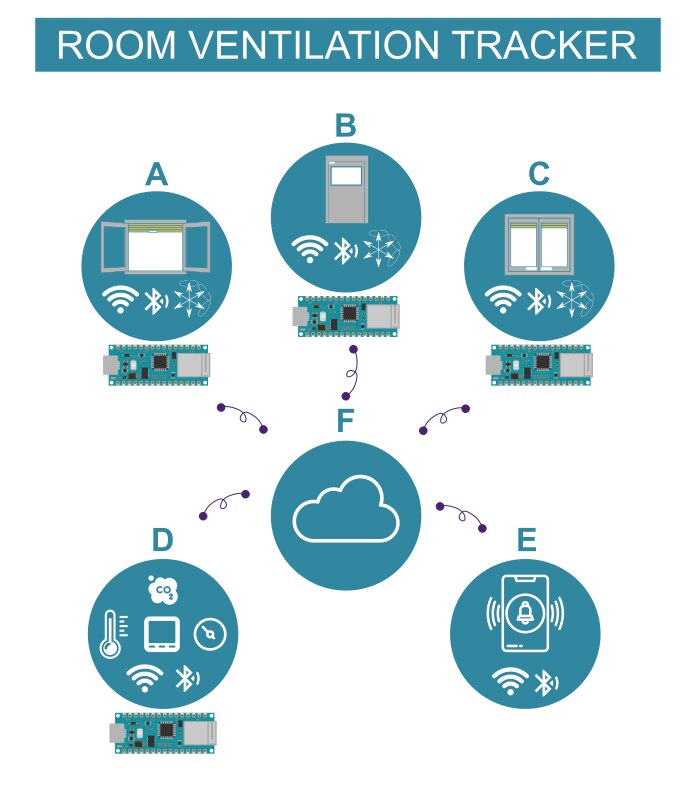

How does my solution work? How am I going to use the Arduino Nano 33 IoT board?
The Tracking System for Classroom Ventilation Routines:
  • A - Wireless window shutter opening sensor
  • B - Wireless door opening sensor
  • C - Wireless window opening sensors
  • D - Wireless environmental sensor
  • E - Monitoring App
  • F - IoT Cloud
