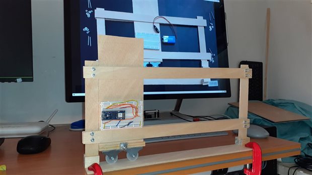

The final result of our mockup to simulate the behavior of sliding windows:

We a need a model, mockup, to make tests and gather data for Machine Learning. So we can carry out the tests in a controlled environment.
We are going to design a plywood model to simulate sliding windows.
These are our prerequisites:
  • It should be designed to allow only one degree of freedom in the direction of sliding.
  • It should still allow us to simulate small vibrations in all three dimensions.
  • It should have a friction similar to a sliding window and that can be adjusted to simulate cases with more and less friction.
  • It should have some rollers to facilitate movement as in real sliding windows.
  • It should have several surfaces where the device and / or magnets can be placed both on the fixed part and on the moving part.
  • The mockup should have enough to fit a medium-sized breadboard and a battery.
  • Must be able to be built with a medium sized plywood board and a 20mm x 10mm wood strip

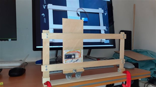

The construction
We cut the Plywood board and the wooden strip to obtain the necessary pieces for our model.
We are going to use screws and nuts to make the joints and washers to prevent the nuts from loosening with vibrations and to obtain enough space so that the boards do not rub too much against each other.
Some of the parts are assembled with white liquid glue.
And finally the built model.
With its sliding moving part.

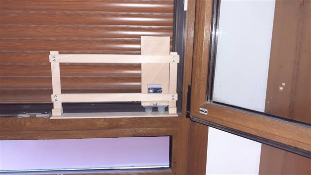

We compare with the size of a real window. Our model is somewhat smaller but it will allow us to take data and test prototypes from the desktop.
