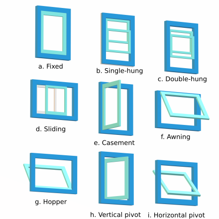

Windows types
  • a. Fixed windows: are windows with a fixed frame that cannot be opened. The lack of window stiles and rails makes for a narrow frame and wide opening that lets in significantly more natural light.
  • b. Single-hung windows: feature a single movable sash, raised from the bottom for ventilation, while the top stays stationary.
  • c. Double-Hung windows: have two operating sash that move up and down allowing for ventilation on the top, bottom or both.
  • d. Sliding windows: glide open horizontally from one side, providing easy access to fresh air.
  • e. Casement windows: are windows that is attached to its frame by one or more hinges at the side. They are used singly or in pairs within a common frame, in which case they are hinged on the outside. Casement windows are often held open using a casement stay.
  • f. Awning windows: are hinged on the top and open outward from the bottom, allowing for ventilation and protection from the rain. Often placed higher on walls for privacy or in combination with large stationary windows for a better view.
  • g. Hopper window: is a small window that opens downward and inward. It is commonly installed as a bathroom or basement window. The upward tilt of the window glass pane blocks open dirt and debris from getting into your home. It usually can be opened with a crank or hinge.
  • h. Vertical Pivot Windows: windows having a sash which pivots about a vertical axis at or near its center; when opened, the outside glass surface is conveniently accessible for cleaning.
  • i. Horizontal pivot Window: The windows mechanism used allows the window to open both inwards and outwards to enable customers to benefit from optimum ventilation and light without compromising on security and heat conservation.

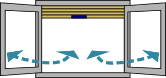

Pivoting: Those doors, windows, shutters and blinds that tilt on a pivot or hinge.
Casement: They open pivoting on a fixed axis, using the fittings located on one of the sides of the sash.

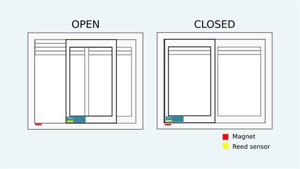

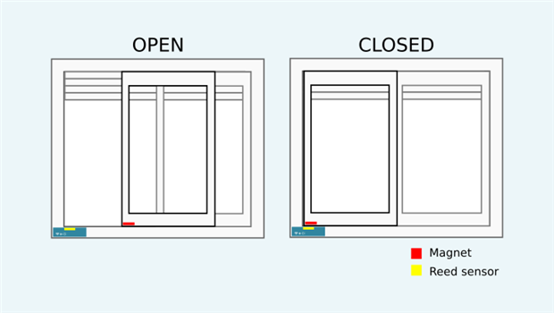

Is it the window open?

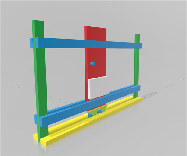

This is the simple part. We can use a plunger that activates a switch like in automatic door seals or something simpler like a reed sensor and magnet.
Our device can be on the moving part of the window, on the fixed part. If we are only concerned with whether the window is open or closed, as in an intrusion alarm, the fixed part is a good place for the device and the magnet would go in the moving part.
Device on window moving part:
Device on window fixed part

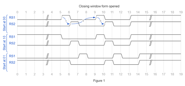

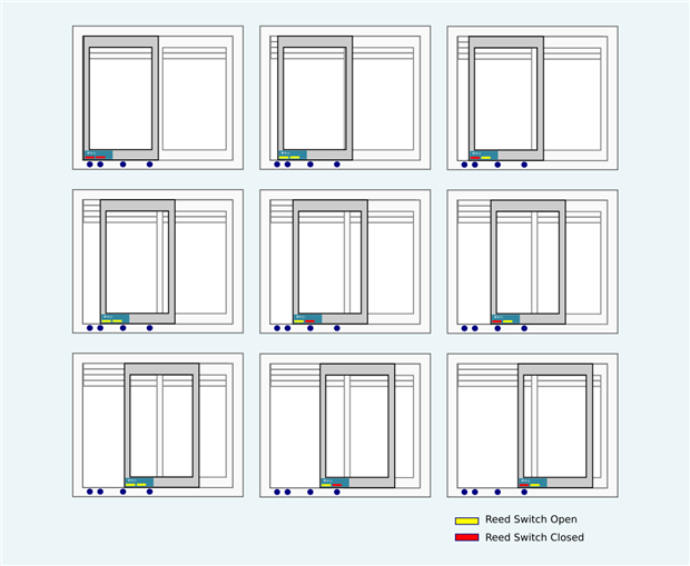

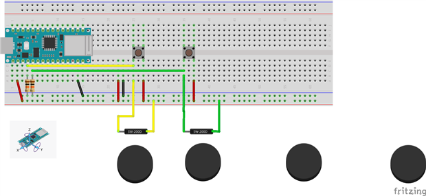

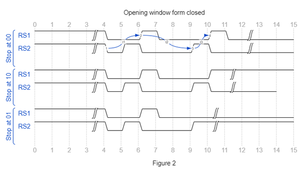

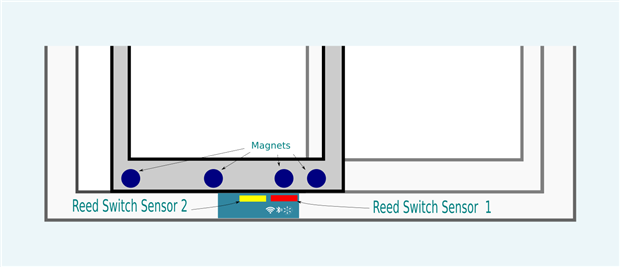

  • A quadrature encoder made by two reed switches, or two hall sensors, aligned and several strategically placed magnets.

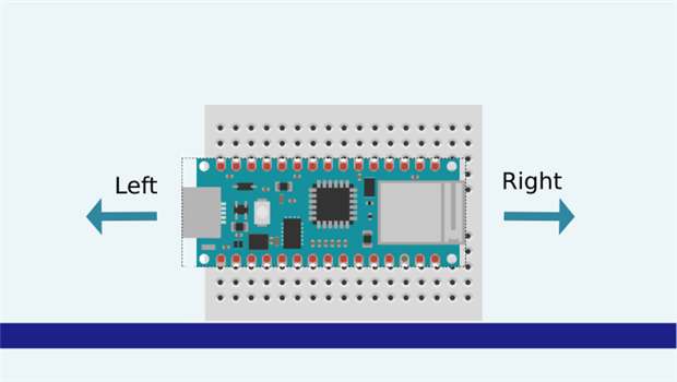

Let's take samo data to see how the LSM6D3 accelerometer responds to left and right displacements
The IMU is located near the USB connector.
The circuit model. Use a breadboard to hold the arduino aligned with a ruler and connect via USB port to capture data with a serial port monitor.

Moving the device to the left.
First the acceleration on the x-axis is positive and its absolute value increases with time. The velocity of the part is also positive and its absolute increases with time. The moving part moves to the left.
Then the acceleration decreases and changes sign braking the device until the speed becomes zero and the device stops.
Moving the device to the right
First the acceleration on the x-axis is negative and its absolute value increases with time. The velocity of the part is also negative and its absolute value increases with time. The moving part moves to the right.
Then the acceleration increases and changes sign braking the device until the speed becomes zero and the device stops.

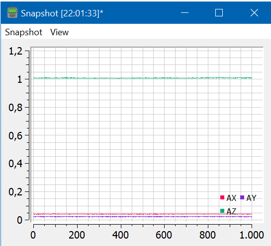

Let's check the influence of the gravity for the board plane, x and y axes
Reading data in no movement condition
AX AY AZ
0.040410000 0.018800000 1.008420000
0.041020000 0.019650000 1.007320000
0.041380000 0.020750000 1.008420000
0.041990000 0.019650000 1.006840000
0.041630000 0.020750000 1.007810000
The accelerometer at resting on a table, it measure s 1G ( 9.81 m/s2) for the z-axis straight upwards.
The need for calibration is clear. The calibration will remove the acceleration offset component in the sensor output due to the earth's gravity (static acceleration).

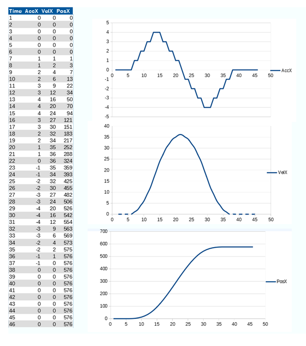

How can we obtain the velocity and the position from the accelerometer data?
Acceleration is the rate of change in the velocity of an object.
Velocity is the rate of change in the position of that same object.
In math we say that velocity is the derivative of position and acceleration is the derivative of velocity, like this:
  a=ddt v   and  v=ddt x
Integration is the opposite of the derivative. If the acceleration of an object is known, we can obtain the position data by applying a double integration (assuming that the initial conditions are zero):
v=∫aba(t)dt+v0    x=∫abv(t)dt =  ∫ab∫aba(t)dt

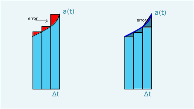

The integral computes the area below the curve, where the integration is the sum of very small areas whose width is almost zero.
In other words, the sum of the integration represents the magnitude of a physical variable.
Let makes some numbers to see how this work.
Sampling a signal gives us instantaneous values of its magnitude, so small areas can be created between two samples. This method introduces errors
velX(t)=velX(t−1)+a(t)·△t
PosX(t)=PosX(t−1)+v(t).△t
For this method to be correct, the time increment between samples would have to be zero. To reduce the error a bit we can divide the rectangular area into another rectangle and a triangle. The good news is that we can reduce the error by increasing the sampling frequency, but the bad news is that the velocity error accumulates and what is worse the position error increases quadratically.
velX(t)=velX(t−1)+(a(t−1)+a(t)−a(t−1)2 )×△t
posX(t)=posX(t−1)+(v(t−1)+v(t)−v(t−1)2 )×△t
Let's see what it looks like.
Moving the device to the left:
Moving the device to the right:
How to obtain movement direction
Average velocity < 0 going to the right
Average velocity >0 going to the left
Velocity = 0 stopped

Making a custom magnetic encoder for sliding windows.
We can make a quadrature encoder with two magnetic sensor to detect the out-phase and another one for detecting closed and open state.
But we are trying to do the same thing with only two reed sensors.
Let's try to design a quadrature encoder with open close detection.
The first two magnets are close enough to have the two magnetic sensors in phase so we can detect the open closed state, after that after the sensor 1 detects the second magnet the quadrature encoder will start.
In this case, the device can be located both on the mobile part and on the fixed part.
The encoder in action
When closed both switches are closed.
After switch 1 transitions from off to on without a switch 2 transition, the quadrature encoder is activated.
Timing diagrams
Breadboard diagram for testing.
The two push button switches in parallel with the reed sensors will allow us to simulate the transitions without the magnets.
Designing a model to make tests
I start to need a model to carry out the tests in a controlled environment.
I am going to have to design a wooden model to simulate sliding windows.
It should have
  • a single degree of freedom,
  • simulate small vibrations,
  • have friction similar to a sliding window
  • and some rollers to facilitate movement
  • a surface where the device and / or magnets can be placed both on the fixed part and on the mobile part, enough to place a medium-sized breadboard
