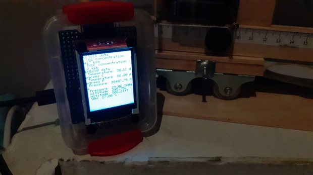

We have already built our second device based on the Arduino Nano 33 IoT boardArduino Nano 33 IoT board. The sensor and environmental monitor that will allow us to take measurements of volumes of CO2 in air, temperature, humidity and pressure to be able to measure the efficiency of natural ventilation habits in classrooms.
This is one of the versions of the user interface that we are testing:
The device was held upright with a slight incline to facilitate reading.
The graphic display shows:
  • the actual time retrieved by NTP using the WIFI connection.
  • environmental sensor combo data:
    • CO2 concentration in ppm
    • a color scale with four levels of CO2 from normal (green) to adverse (red)
    • the temperature in degrees Celsius or Fahrenheit
    • and the percentage of relative humidity

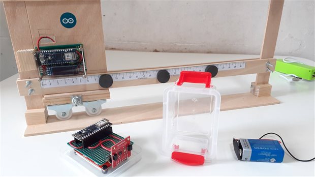

Here our family of devices: Wireless Window Sensor & Wireless Environmental Sensor & Monitor:
The assembly

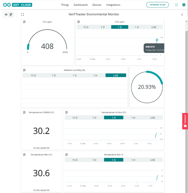

Visualizing Data
While we continue working with the final version of the user interface, we have designed a simple screen to verify that everything works by showing data in real time on the screen and connecting to the Arduino IoT cloud.
Dashboard
Device overview

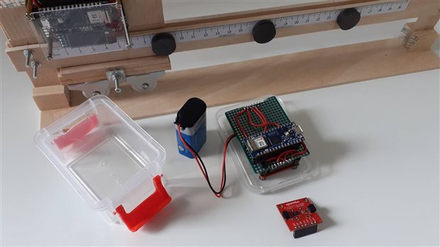

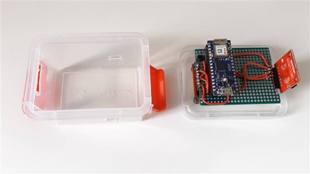

We have built the device inside a plastic box. On the front we have placed a 1.8 "color LCD display and 128x160 pixel resolution.

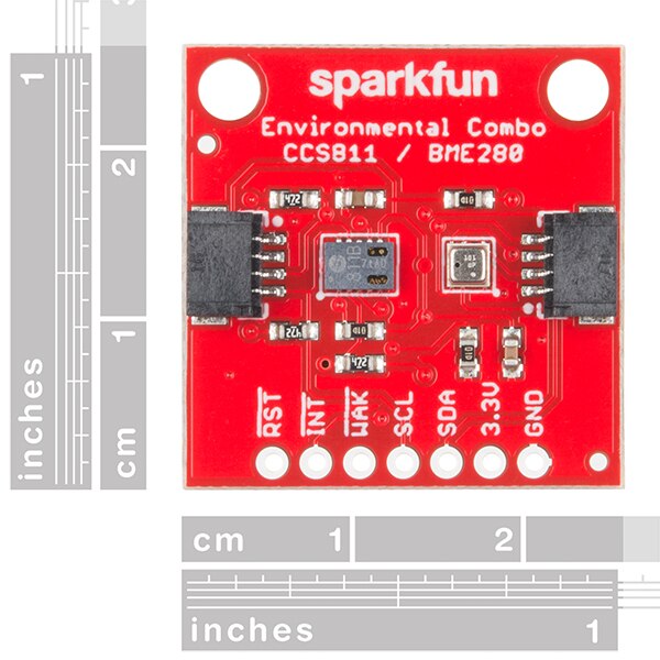

At the top we have placed a couple of sensors in a combo, the SparkFun Environmental Combo Breakout - CCS811 / BME280.
The CCS811 provides readings for equivalent CO2 (or eCO2) in the parts per million (PPM) and total volatile organic compounds in the parts per billion (PPB).
The BME280 provides humidity, temperature and barometric pressure. The CCS811 must be adjusted with humidity and temperature measurements.
The assembly is stacked and is screwed to the front cover of the box.

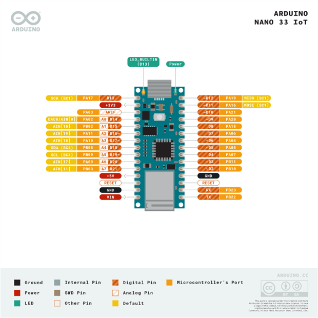

The Arduino Nano 33 IoT fits into two female headers on the back of our board stack.
The SparkFun Environmental Combo Breakout - CCS811 / BME280  connects to the main board via a 90 degree header pin.

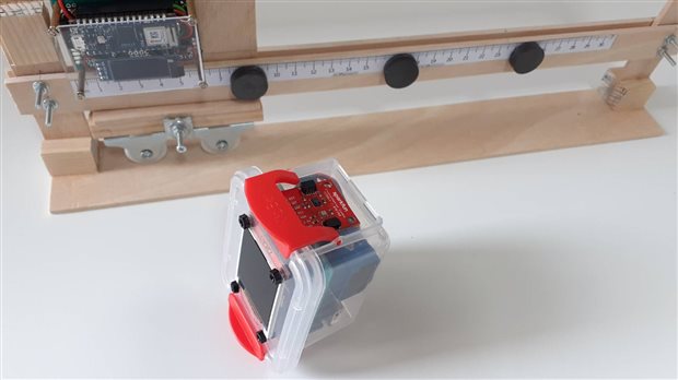

The final assembly of the combo is done with the box closed.
The device can be powered by the USB port that is accessible from the outside of the box or by a 9V battery that fits inside the box.

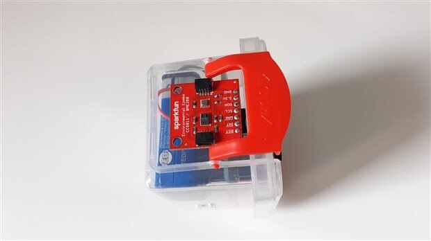

The box has three slots, one to allow the connection of the combo of environmental sensors another to allow the external connection to the usb port and a third to allow the exchange of heat with the outside.
The front and the environmental sensor combo are assembled at 90 degrees to allow the sensors to be in contact with the outside.
The 1.8 "SPI TFT LCD Screen Module, 9 pins interface.
The LCD drive ic is ST7735S. It's a 128 X 160 (resolution).
The display is screwed to the cover and connected to the main board by header pins and a screw to secure the board.
The environmental sensor combo sits on the top outside of the box.

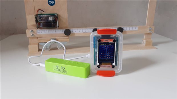

The transparent box allows us to visualize the placement of the 9-volt battery.
We can also power our device through the usb port. In the image powered by a power bank. In the image our labyrinth puzzle created to study the use of the accelerometer to estimate the speed and position of the windows that we developed in the past blog VenTTracker #04 -  Playing with the IMU

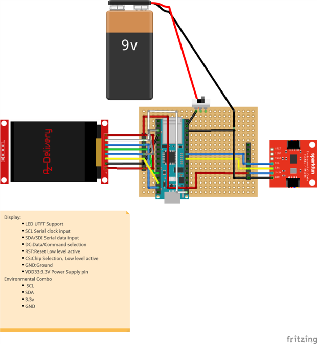

Schematic

Display1.8 TFT SPI 128x160
It is a 1.8 "SPI TFT LCD Screen Module, 9pins interface. Not just a LCD break but include SD card (2GB),
The LCD drive ic is ST7735S. Resolution: 128 X 160
The display interface is SPI, it just needs 5 wires (CS, RS, SCL, SDA, RST) for controlling.
SDcard use hardware SPI interface (CS / MOSI / MISO / SCK)

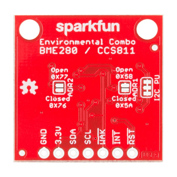

SparkFun Environmental Combo Breakout - CCS811/BME280 (Qwiic) - SEN-14348 - SparkFun Electronics
The CCS811 also has a feature that allows it to fine-tune its readings if it has access to the current humidity and temperature.
This allows the sensors to work together to give us more accurate readings.
  • humidity,
  • temperature,
  • TVOCs and equivalent CO2 (or eCO2)
  • barometric pressure,
  • CO2 (or eCO2) in the parts per million (PPM)
  • total volatile organic compounds in the parts per billion (PPB)
Features
  • Qwiic-Connector Enabled
  • Operation Voltage: 3.3V
  • Total Volatile Organic Compound (TVOC) sensing from 0 to 1,187 parts per billion
  • eCO2 sensing from 400 to 8,192 parts per million
  • Temp Range: -40C to 85C
  • Humidity Range: 0--100% RH, =-3% from 20--80%
  • Pressure Range: 30,000Pa to 110,000Pa, relative accuracy of 12Pa, absolute accuracy of 100Pa
  • Altitude Range: 0 to 30,000 feet (9.2 km), relative accuracy of 3.3 feet (1m) at sea level, 6.6 (2m) at 30,000 feet
Arduino Libraries
sparkfun/Qwiic_BME280_CCS811_Combo (github.com)
CCS811
BME280
The I2C address of the Environmental Combo Breakout is 0x77 / 0x5B and is jumper selectable to 0x76 / 0x5A.

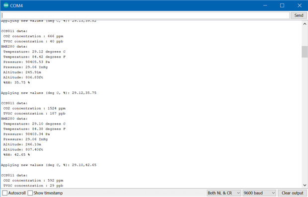

Checking the environmental combo

Testing the environmental combo

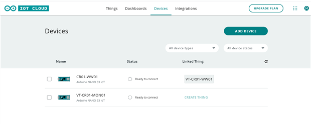

Arduino IoT Cloud
Creating a new device and a new thing
