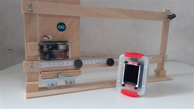

      • We built a mockup for sliding window simulations.
      • We built a window sensor device prototype including the bill of materials and schematics.
      • Then we attached the window sensor to our sliding window simulation mockup.

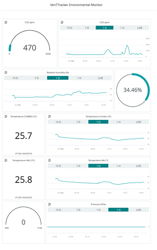

      • We connected our window sensor with the arduino iot cloud. Then created the monitoring dashboard.
      • We built an auxiliary device connected to the cloud to measure CO2 concentrations and other environmental data.

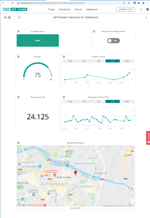

VenTTracker #10 - Ventilation Monitor on Arduino IoT Cloud
And we connected our prototype to the Arduino IoT Cloud
and created our first dashboard that we would later integrate with our environmental sensor.

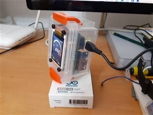

And finally we redesigned and remade our broken environmental sensor
Unfortunately the combo module stopped working three days after it was turned on. Probably some of the children at home touched it, we don't know. We couldn't get it back because it shorted the I2C communication lines.
So we decided to try two cheap I2C 3V3 modules.
VenTTracker #14 (aka #11 bis) - Environmental Monitor Revisited - Version 2
