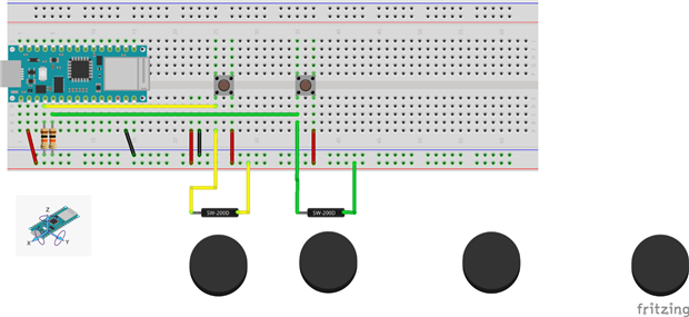

This was the previous version:
  • Two Reed Switch Sensors Aligned with pull down resistors and positive logic.

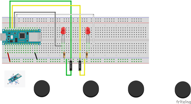

And this is the new version:
In the new version:
  • We can no longer detect the closing position. Although the encoder could try to detect the closed position through the relative position, since there is no absolute reference we cannot know if it is closed or not. We have to delegate the problem of detecting the closed position to a new sensor.
  • The sensors are no longer aligned. Being aligned, and not being exactly the same, caused them not to switch at the right time.
  • We change the ports that the sensors connect to. Now there are two ports that support interruptions to allow us to work with multithreading.
  • We add two LEDs for debugging.
  • We removed the pull down resistors from the old version switches and replaced them with two internal 20K pull up resistors from the microcontroller.
  • This makes the logic of the switches in our design now negative. Low when the switch is closed and High when the switch is open.
Building an encoder model for testing
Let's build a real model for testing and see if our design works.
Parts
#Part
1Arduino Nano 33 IOT
2100Ω Resistor
2TILT-SWITCH-SW-200D
4MAGNET
2Red LED
Connections:
Arduino Nano 33 IoTComponent
10Left Reed Switch. Other end to ground.
9Right Reed Switch. Other end to ground.
8Left Red LED. With a 100Ω Resistor to ground.
7Right Red LED. With a 100Ω Resistor to ground.

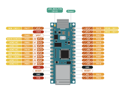

The pins below can be used with attachInterrupt() on Nano 33 IoT.
We are going to use pins 9 and 10:
BOARDDIGITAL PINS USABLE FOR INTERRUPTS
Nano 33 IoT2, 3, 9, 10, 11, 13, 15, A5, A7
Arduino Nano 33 IoT Pinout:

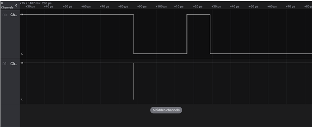

Checking encoder signals.
The video shows the signals at the two switch sensors
As seen in the video we will need a low pass filter to avoid bouncing on the switches.
Zooming:

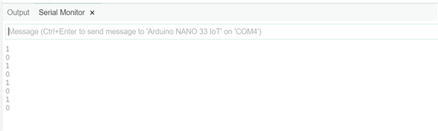

When the code finds a low-to-high transition on the leftSwitchState , it checks to see if the rightSwitchState  channel is high or low and then increments/decrements the counter with the encoderPosition. By now the encoder position is a relative position. We will need to add an absolute reference position to calibrate our encoder.
This is the serial output going right to left and left to right with the magnet.
