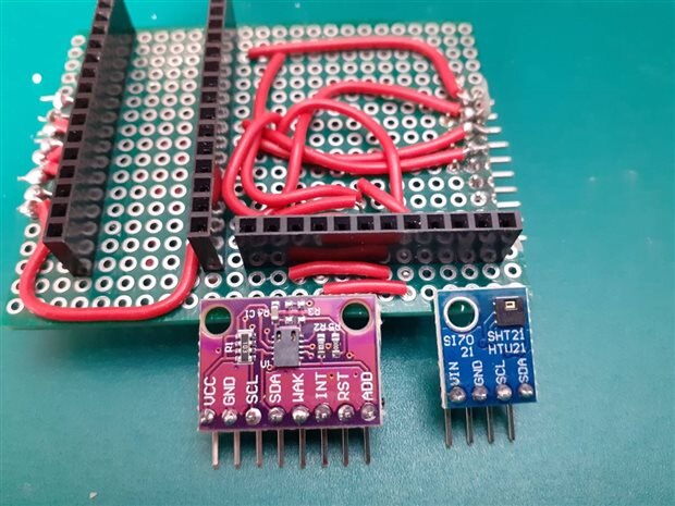

So we decided to try two cheap I2C 3V3 modules that we find on the Amazon Spain website of two European sellers who promised to ship in the same week.
CCS811 Air Quality Sensor for VOC, TVOC and eCO2
https://www.amazon.es/gp/product/B08M615S73/
GY-21 HTU21 humidity and temperature Sensor
https://www.amazon.es/gp/product/B07PFHM9HN
We modified the software to use the HTU21 module instead of the BME280. Fortunately everything has worked without problems.
We have only lost the barometric pressure measurement but we maintain compatibility with the previous version.

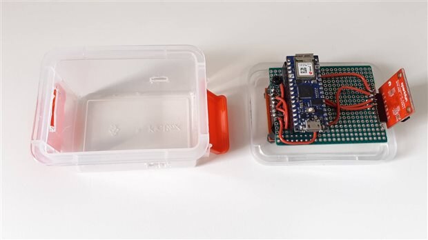

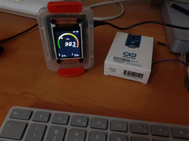

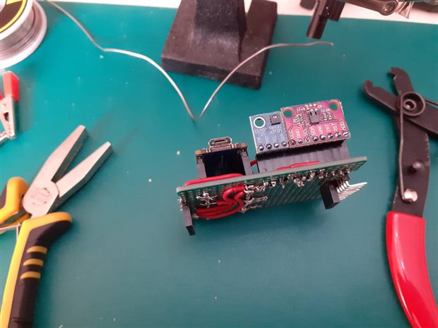

Once the operation has been verified, we solder a new header for the two modules and place them inside our box.
This is the result.

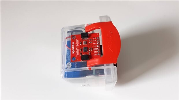

In the first version, the environmental combo module was located outside the box. Maybe that's why it ended up "breaking by itself."
We will not make the same mistake again.
Environmental Sensor and Monitor Version 2

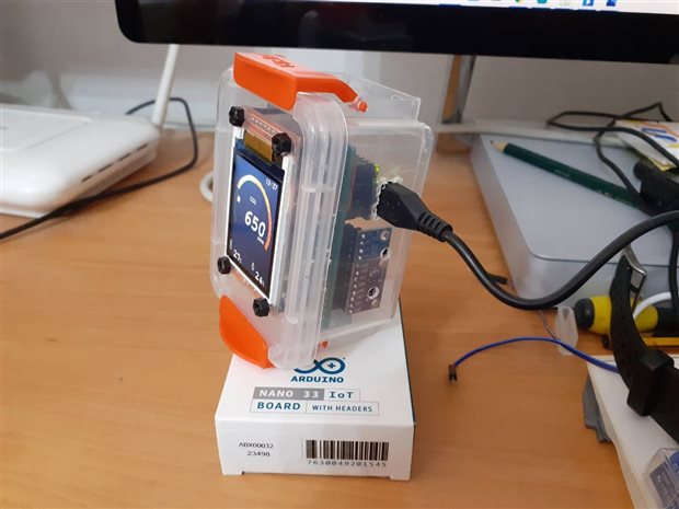

In the new version, we place the sensors on one side in which we will make some holes for the air from outside to reach them.

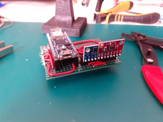

Connections
WAK - this is the wakeup pin for the CS811 sensor. It needs to be pulled to ground in order to communicate with the sensor.
Vin - this is the power pin. Both sensors use 3.3V
GND - common ground for power and logic
SCL - this is the I2C clock pin, connected to our Arduino Nano 33 IoTArduino Nano 33 IoT I2C clock line.
SDA - this is the I2C data pin, connected to our Arduino Nano 33 IoT I2C data line.
At the bottom we keep the row of pins for the connection of the Sparkfun environmental combo that by default has a different I2C address than the new CS811 module.

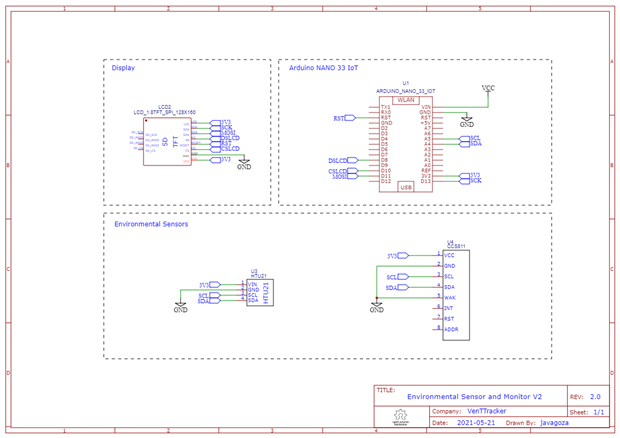

Schematics

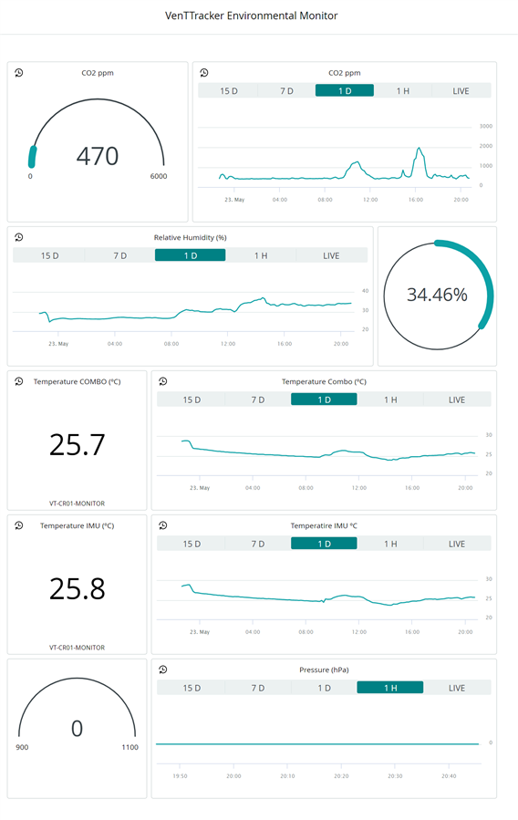

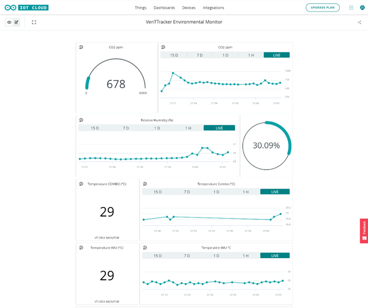

Visualizing VenTTracker Data on Arduino IoT Cloud with PC
We maintain compatibility with the THING created in the previous version. We have only lost the barometric pressure measurement.

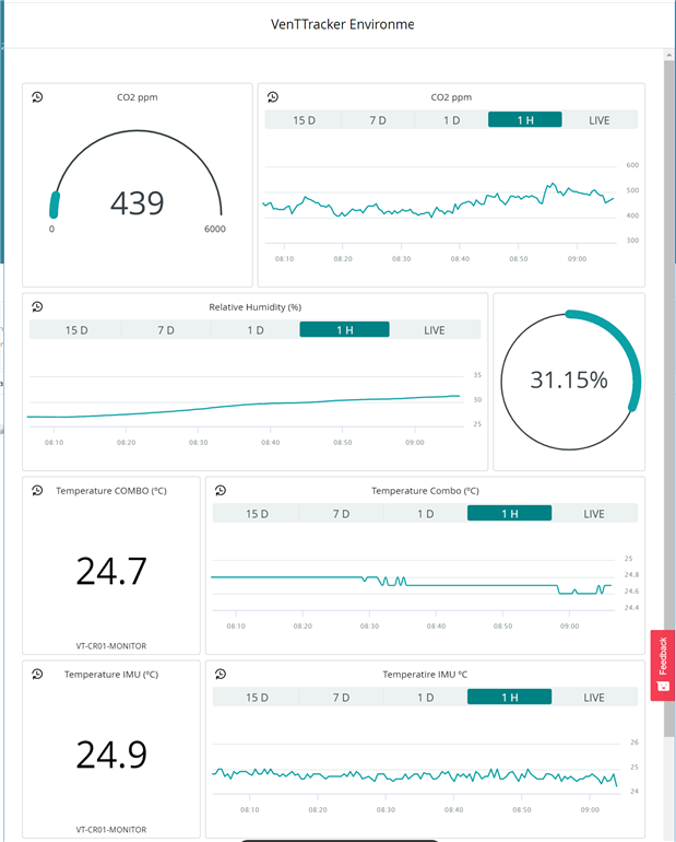

Live Data
Historical data
1 Hour view
1 Day View

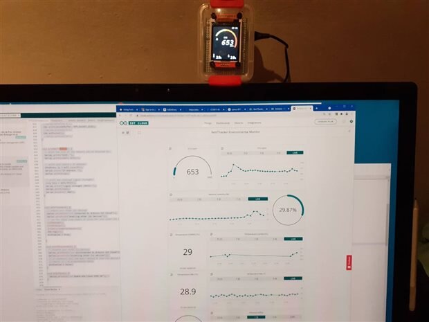

Visualizing VenTTracker Data on Arduino IoT Cloud with Android
We can monitor our sensor also from a mobile.

    I added a potentiometer to adjust the LCD brightness and turn off the display when not needed.
