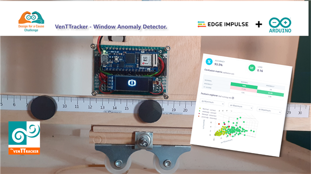

Windows are essential for good natural ventilation. Our project aims to monitor natural ventilation habits in classrooms. And this week we implemented an anomaly detector for sliding windows. This will allow our window sensors to detect if the windows need maintenance due to difficulty in opening or closing. We have designed and trained a Machine Learning model to detect anomalies in the opening and closing of sliding windows through the IMU incorporated in the Arduino Nano 33 IoTArduino Nano 33 IoT and using the services of the Edge Impulse platform.
  Design for A Cause 2021 the VenTTracker project
  01 - Intro and motivation. | 02 - Analyzing Window Types (I) | 03 - Analyzing Window Types (II) | 04 - Playing with the IMU | 05-Sliding Window Mock-up | 06 -  Window Sensor Prototype | 07 - Adjusting the window sensor | 08 - Trying to make a measuring device with the accelerometer | 09 - Checking and updating WiFiNINA Firmware | 10 - Ventilation Monitor on Arduino IoT Cloud | 11 - Wireless Environmental Monitor on Arduino Nano 33 IoT | 12 - Window Anomaly Detection. Edge Impulse & Arduino Nano 33 IoT | 14 - Environmental Monitor Revisited - Version 2 | 13 - Project wrap-up and Lessons learned
Tracking System for Classroom Ventilation Routines
A STEM project for classrooms
the VenTTracker project - VenTTracker #12 - Window Anomaly Detection. Edge Impulse & Arduino Nano 33 IoT

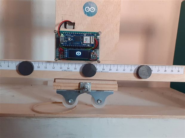

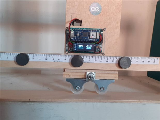

The problem
Our problem is to detect anomalous movements in the window due to elements that interfere with the movement of the window when opening or closing.
The solution
Our solution will be an intelligent device with embedded Machine Learning processing the data that the accelerometer of the Arduino Nano 33 IoT gives us and converting it into information that allows us to classify the movement as an anomaly or as normal movement.

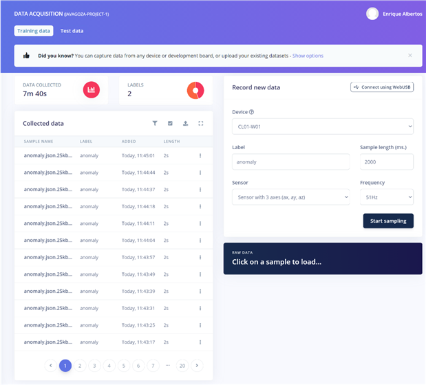

Data acquisition
Edge Impulse provides specific data capture firmware for many boards on the market. At the moment the Arduino Nano 33 IoT board is not fully supported but there are many other methods of capturing the data and uploading it to the platform. In our case, we have opted for the simplest, the Data Forwarder, which allows us to capture data from any device with a few lines of code.

In a command window:
C:\edge-impulse-data-forwarder
Edge Impulse data forwarder v1.13.4
Endpoints:
    Websocket: wss://remote-mgmt.edgeimpulse.com
    API:       https://studio.edgeimpulse.com/v1
    Ingestion: https://ingestion.edgeimpulse.com
? Which device do you want to connect to? COM17 (Arduino AG (www.arduino.cc))
[SER] Connecting to COM17
[SER] Serial is connected (82:65:39:24:50:57:37:38:35:2E:31:20:FF:12:06:36)
[WS ] Connecting to wss://remote-mgmt.edgeimpulse.com
[WS ] Connected to wss://remote-mgmt.edgeimpulse.com
[SER] Detecting data frequency...
[SER] Detected data frequency: 51Hz
[WS ] Device "CL01-W01" is now connected to project "javagoza-project-1"
[WS ] Go to https://studio.edgeimpulse.com/studio/175/acquisition/training to build your machine learning model!

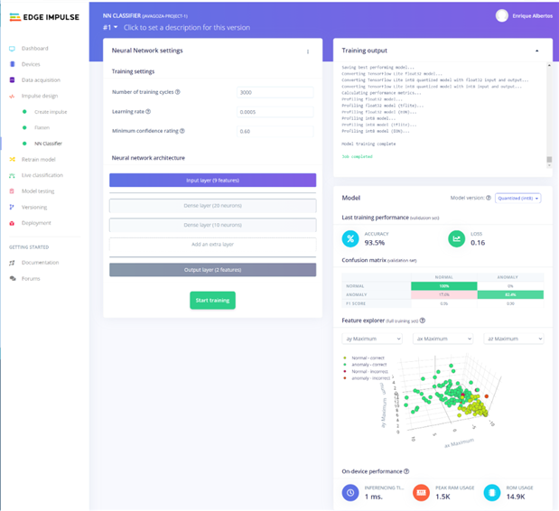

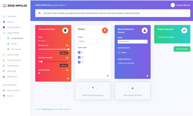

Impulse Creation
An impulse takes raw data, uses signal processing to extract features, and then uses a learning block to classify new data.
Nearest Neighbour Classifier
We tested live classification and surprise all the tests give the correct classification of the anomalies.

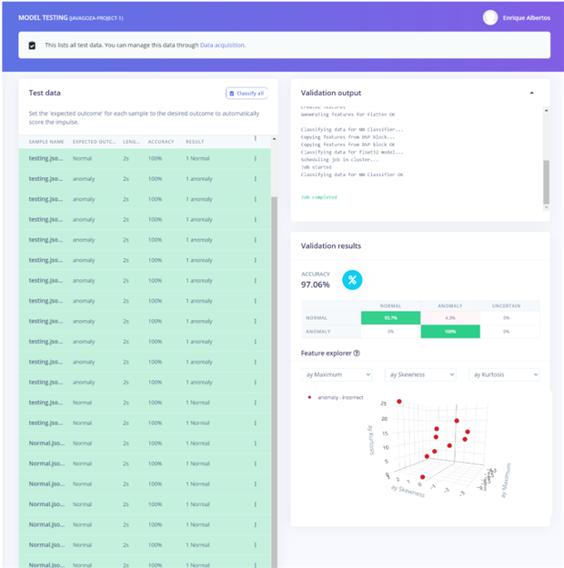

Model Testing
The model behaves very well but we observed that the model crashes when hitting the window hitting the window frame when closing. We can avoid this with a mechanical window, preventing certain values or adding more complexity to our model.

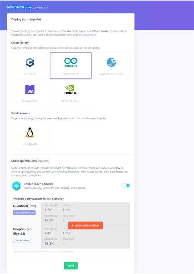

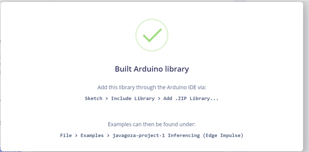

Deployment
Compiling the code and resolving conflicts
Reference: https://docs.edgeimpulse.com/docs/running-your-impulse-arduino

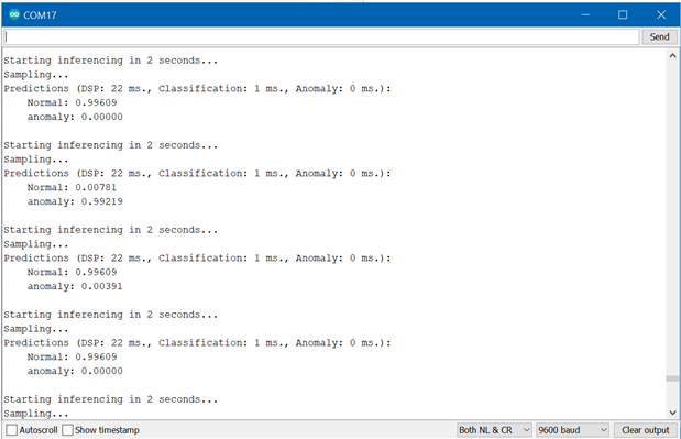

Static buffer inference
The first thing we are going to do is test the inference engine under controlled conditions without taking data from the accelerometer. We will treat a static buffer

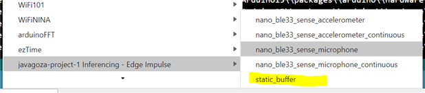

We have installed the project as a library. And they provide us with several examples with the application skeleton ready to use. We start by testing the static buffer example to see that it compiles well.

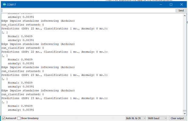

We compiled again and everything works, it has been just 5 minutes following the Edge Impulse guide
Using library ei-javagoza-project-1-arduino-1.0.4 at version 1.0.4 in folder: C:\Users\ealbertos\Documents\Arduino\libraries\ei-javagoza-project-1-arduino-1.0.4
Sketch uses 14712 bytes (5%) of program storage space. Maximum is 262144 bytes.
Global variables use 3708 bytes (11%) of dynamic memory, leaving 29060 bytes for local variables. Maximum is 32768 bytes.

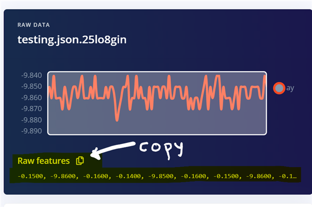

Finally copy raw features here (for example from the 'Live classification' page)

And the results with the static buffer:
Inference with real-time IMU data

Capture with several normal cases and one anomaly. The results are very good.
The detector in action
Normal condition, no anomalies.
Anomaly detected, send alert:
Code used in the demo video

    ei_printf("Sampling...\n");
    // Allocate a buffer here for the values we'll read from the IMU
    float buffer[EI_CLASSIFIER_DSP_INPUT_FRAME_SIZE] = { 0 };
    for (size_t ix = 0; ix < EI_CLASSIFIER_DSP_INPUT_FRAME_SIZE; ix += 3) {
        // Determine the next tick (and then sleep later)
        uint64_t next_tick = micros() + (EI_CLASSIFIER_INTERVAL_MS * 1000);
        IMU.readAcceleration(buffer[ix], buffer[ix + 1], buffer[ix + 2]);
        buffer[ix + 0] *= CONVERT_G_TO_MS2;
        buffer[ix + 1] *= CONVERT_G_TO_MS2;
        buffer[ix + 2] *= CONVERT_G_TO_MS2;
        delayMicroseconds(next_tick - micros());
    // Turn the raw buffer in a signal which we can the classify
    signal_t signal;
    int err = numpy::signal_from_buffer(buffer, EI_CLASSIFIER_DSP_INPUT_FRAME_SIZE, &signal);
    if (err != 0) {
        ei_printf("Failed to create signal from buffer (%d)\n", err);
        return;
    // Run the classifier
    ei_impulse_result_t result = { 0 };
    err = run_classifier(&signal, &result, debug_nn);
    if (err != EI_IMPULSE_OK) {
        ei_printf("ERR: Failed to run classifier (%d)\n", err);
        return;
    // print the predictions
    ei_printf("Predictions ");
    ei_printf("(DSP: %d ms., Classification: %d ms., Anomaly: %d ms.)",
        result.timing.dsp, result.timing.classification, result.timing.anomaly);
    ei_printf(": \n");
    for (size_t ix = 0; ix < EI_CLASSIFIER_LABEL_COUNT; ix++) {
        ei_printf("    %s: ", result.classification[ix].label);
        Serial.println(result.classification[ix].value, 5);
    if(result.classification[1].value>.65f) {
       blinkLogo(alert, ALERT_WIDTH, ALERT_HEIGHT,500);
    } else {
      drawLogo(edgeimpulsearduino, EDGEIMPULSE_LOGOWIDTH, EDGEIMPULSE_LOGOHEIGHT);
#if EI_CLASSIFIER_HAS_ANOMALY == 1
    ei_printf("    anomaly score: " );
    Serial.println(result.anomaly, 3);
#endif

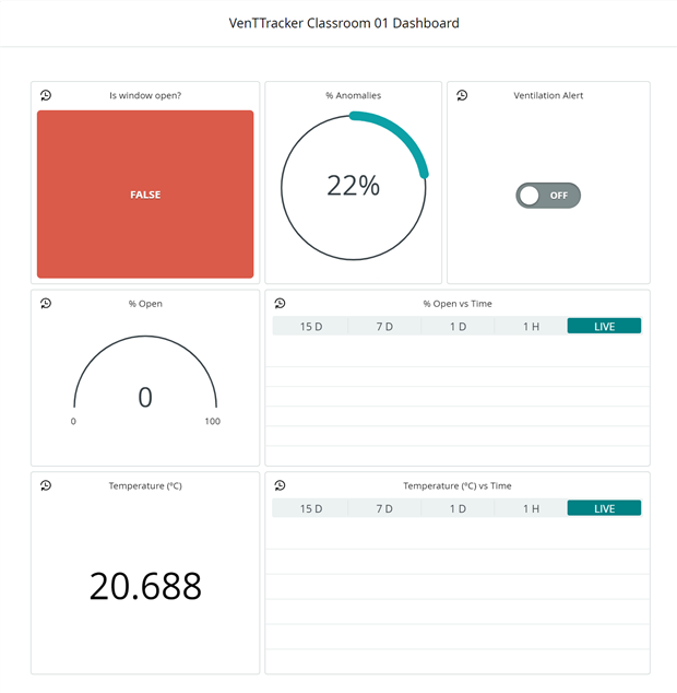

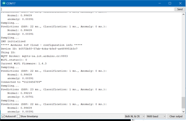

Connection to the Arduino IoT cloud
We connect our detector and sensor to the Arduino IoT cloud.
Add the includes as in VenTTracker #10 - Ventilation Monitor on Arduino IoT Cloud
#include "arduino_secrets.h"
#include "thingProperties.h"
Add cloud setup. We use callbacks to allow the Wi-Fi connection to be established without problems without affecting the communication with the cryptoprocessor that will secure the connection.
  initProperties();
    // Connect to Arduino IoT Cloud
  ArduinoCloud.begin(ArduinoIoTPreferredConnection);
  ArduinoCloud.addCallback(ArduinoIoTCloudEvent::CONNECT, onIoTConnect);
  ArduinoCloud.addCallback(ArduinoIoTCloudEvent::DISCONNECT, onIoTDisconnect);
  ArduinoCloud.addCallback(ArduinoIoTCloudEvent::SYNC, onIoTSync);
  setDebugMessageLevel(2);
  delay(3000);
  ArduinoCloud.printDebugInfo();
and update cloud variables in loop
    ArduinoCloud.update();
