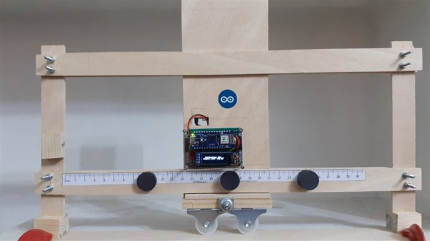

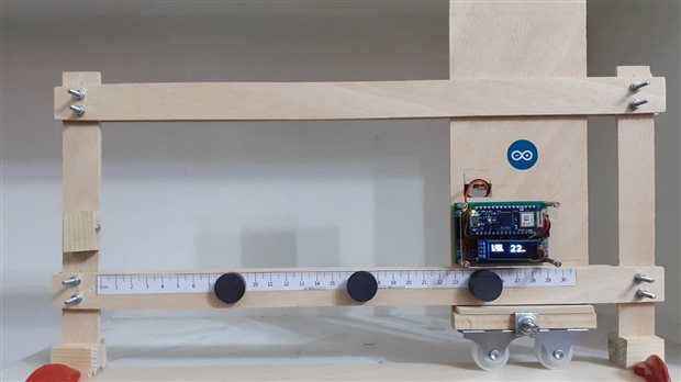

The measuring device
We have converted our window sensor into a distance measuring device. This will allow us to know the opening status of a window for our project to monitor the ventilation routines that we are doing with the Arduino Nano 33 IoT.
We use the LSM6DS3, iNEMO inertial module sensor, from the the Arduino Nano 33 IoTArduino Nano 33 IoT, to estimate the distance from the window closed position.

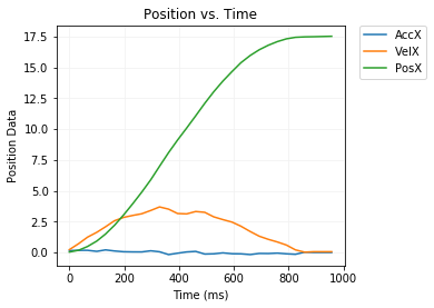

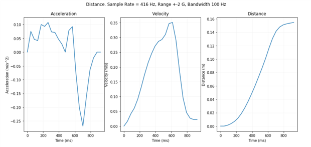

To obtain the position we must perform a double integral on the acceleration data. We apply a simple algorithm to implement a double integration of the data obtained from the sensor. The double integration consists of making a first integration to obtain the velocity and then another on the latter to obtain the position.
Graphic visualization of the double integration that we have obtained with the small python script that we include at the end of the blog

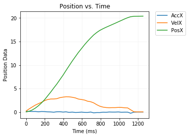

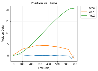

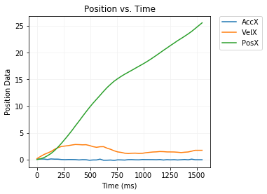

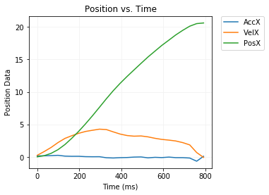

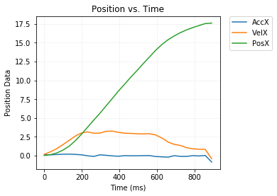

Getting started
Initially we started taking samples with the official arduino library to see the behavior of our sensor by doing the double integral and applying an initial filter. The results are not very exact but they are valid for our purpose, which is to determine the position of the window without much precision. From this moment we decided to use the SparkFun library to have more control over the working parameters of the IMU.
Graphics made with the Arduino library. AccX in m/s^2, VelX in m/s, PosX in cm

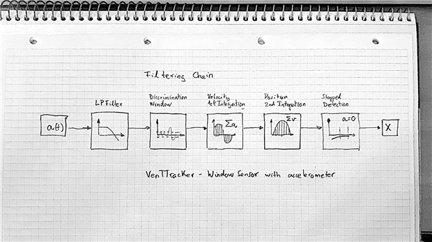

Filtering Chain
To eliminate mechanical noise we use a low pass filter. We have to eliminate as much noise as possible to prevent errors from accumulating when integrating. Being a double integral the one that we are going to make, the errors grow quadratically.
An easy way to perform a low pass filter is to perform a moving average. We have simplified filtering and consists of obtaining the average of a set of samples. It is important to obtain the average of a balanced number of samples. If we take too many samples we can end up losing too much information and if we take too few we end up with an incorrect value.
We have carried out many tests to reach an adequate value. However, we observe that the number of samples required also depends on the average speed at which we move the window, so we have had to reach a compromise in which the sensor no longer acts correctly below a velocity threshold.
When we are in the stop condition, minor errors in acceleration can be interpreted as constant velocity due to the fact that non-zero samples are added. In the ideal case for a stopped state, all samples should be zero. If we do not zero these samples they will accumulate on the velocity producing a virtual continuous movement and, therefore, an unstable position.
Even with the above filtering, some data may be wrong, so we need a discrimination window between valid data and invalid data for the stopped state.
This is our filtering chain:
After filtering:

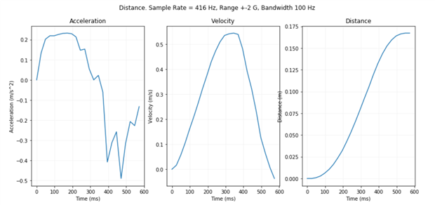

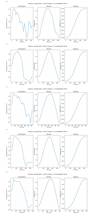

Motion completion detection.
Looking at the graph below, there is an initial acceleration or deceleration at maximum speed. So that acceleration changes direction to zero again. At this point we can consider that a complete displacement has been made and a new position has been reached.
In a real scenario, the area under the positive part should be equal to the area of the negative part, reaching zero velocity when the window stops. If we don't force that velocity to zero, the position will be in an unstable state. To force the steady state if we have several acceleration samples to zero or the velocity changes sign, we force the velocity to zero.

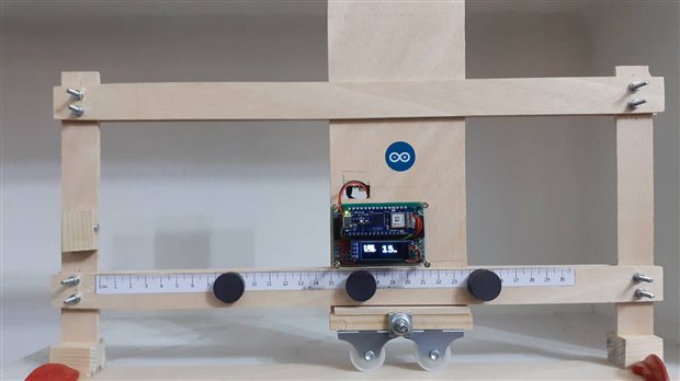

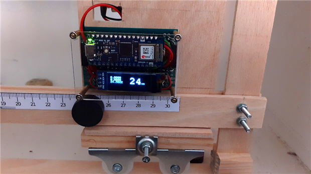

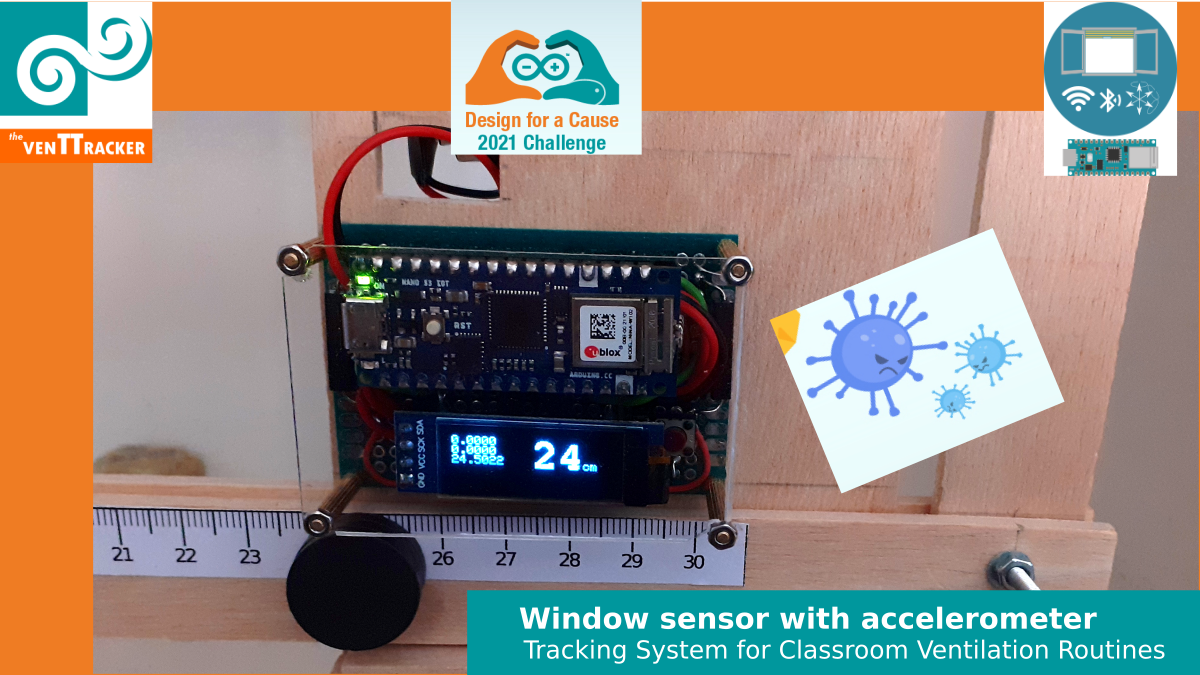

User interface
Our final version of the sensor will not have a graphic display to reduce power consumption and increase battery life.
For taking samples we have included the same graphic display that we used for the previous prototype of the sensor that used a linear magnetic encoder to determine the position of the moving part of the window.
The display shows the filtered data of the acceleration, speed and position. The last position data is shown in centimeters.

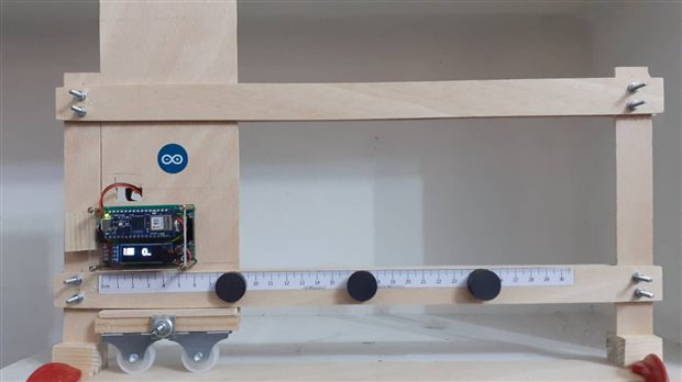

Absolute reference
We need a way to force an origin to our measurements. We use a magnetic reed switch to zero our sensor.
Resetting position to zero. Absolute reference.

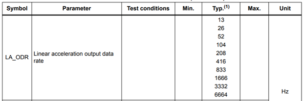

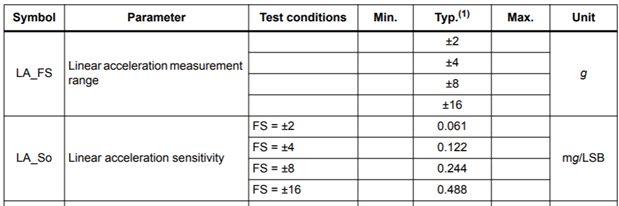

Adjusting the LSM6DS3 sensor
With the LSM6DS3 we can adjust:
  • the Linear acceleration measurement range
  • the sample rate
  • the antialiasing filter bandwidth
After taking many samples we decided to adjust the settings as shown in the following images.

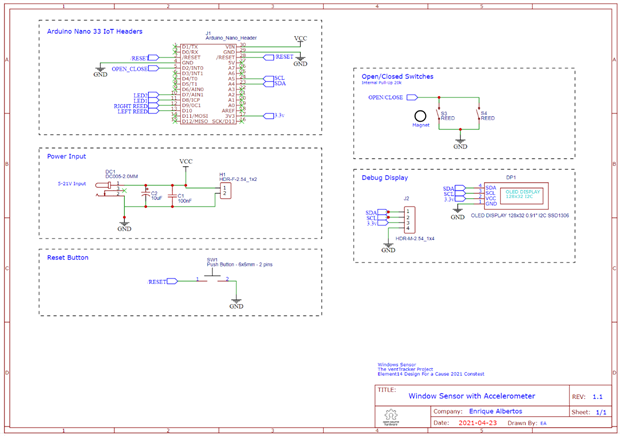

The circuit
The circuit is similar to the window sensor prototype from the previous blog, VenTTracker #06 -  Window Sensor Prototype, from which we have removed the indicator lods and the two magnetic reed switches that made up our magnetic linear encoder.

  This function transforms acceleration to a proportional position by
integrating  the acceleration data  twice. It also adjusts sensibility by
multiplying the "positionX"  and "positionY" variables. This integration
algorithm carries error, which is compensated in the "movenemt_end_check"
  subroutine. Faster  sampling frequency implies less error  but requires more
memory. Keep  in mind that the same process is applied to the X and Y axis.
