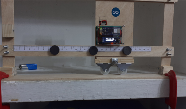

The system in action:

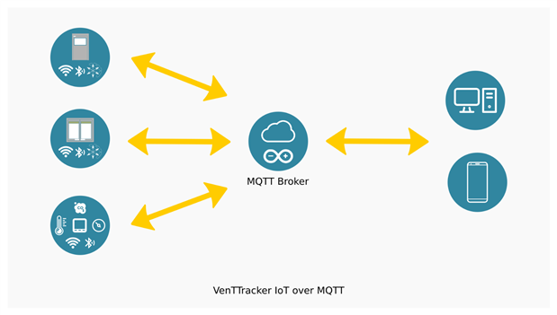

IoT over MQTT
We are going to use the arduino IoT Cloud service which is based on MQTT. MQTT is a widely used publish-subscribe messaging protocol in the Internet of Things. It runs on top of the TCP / IP protocol and is designed for connections to remote locations where a "small code footprint" is required or network bandwidth is limited. The goal is to provide a protocol that saves bandwidth and uses little battery power.
Architecture
Our routine ventilation monitor is composed of:
  • Devices:
    • Window sensors that record both the position of the window and the temperature in the window, as well as whether the window needs to be opened.
    • Environmental sensor to capture the environmental variables that concern us, such as the concentration of carbon dioxide in the room.
  • Software to define the behavior of our hardware.
  • Cloud application to store data or control devices remotely.

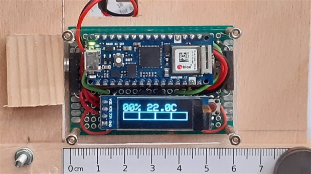

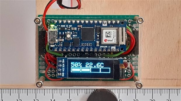

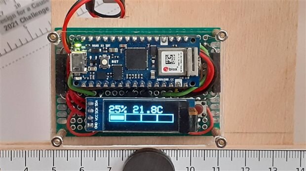

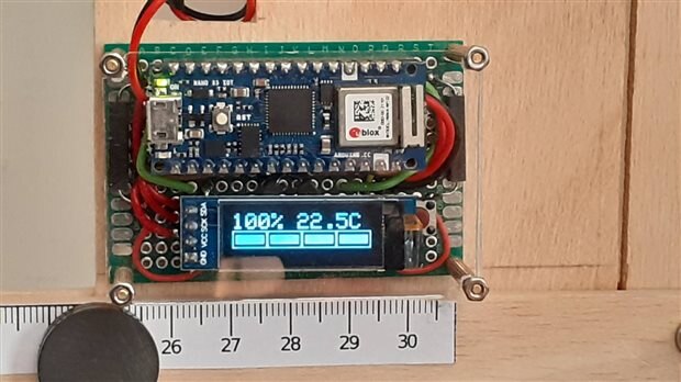

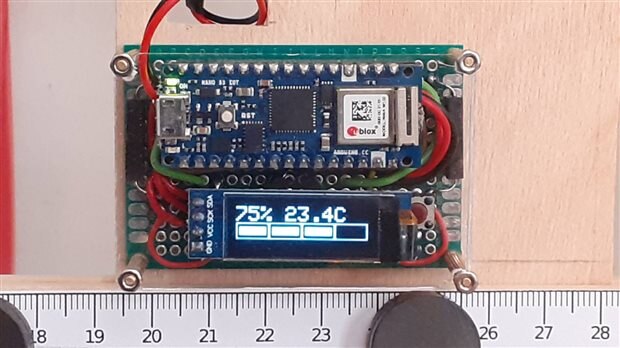

Our devices are built on the Arduino Nano 33 IoTArduino Nano 33 IoT board. They are the hardware that runs the software, reads sensors, controls actuators, and communicates with the Arduino IoT Cloud.

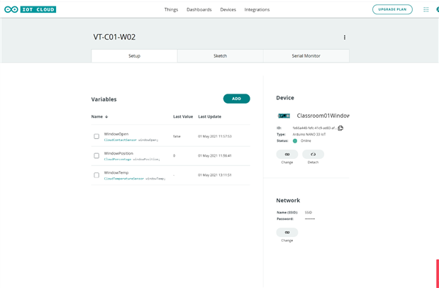

Things
Things are the digital twin of our hardware. When we create a new Thing, there are a few configurations that we need to do to get started.
Each thing has a linked physical device for which we have to define the credentials of the WIFI network to which it is going to connect and the variables that will be controlled or monitored with that device.

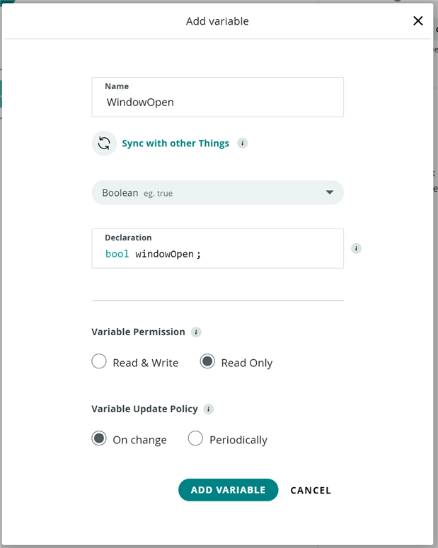

Variables
Variables are attributes that define the characteristics of a device. A variable can be 'read only' (RO) to indicate that Arduino Cloud IoT can read data but can not change the value of the variable. A variable could be designed as 'read and write' (RW) if Arduino Cloud IoT can also remotely change the value of the variable and send an event notification to the device.
Window Sensor Variables
  • CloudSwitch windowOpen: (RO) indicates if the window is open or closed
  • CloudSwitch windowAlert; (RW) can signal the window in alert state
  • CloudPercentage windowPosition; (RO) indicates if the window open percentage (0%, 25%, 50%, 75%, 100%)

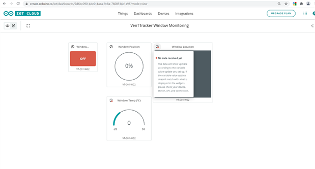

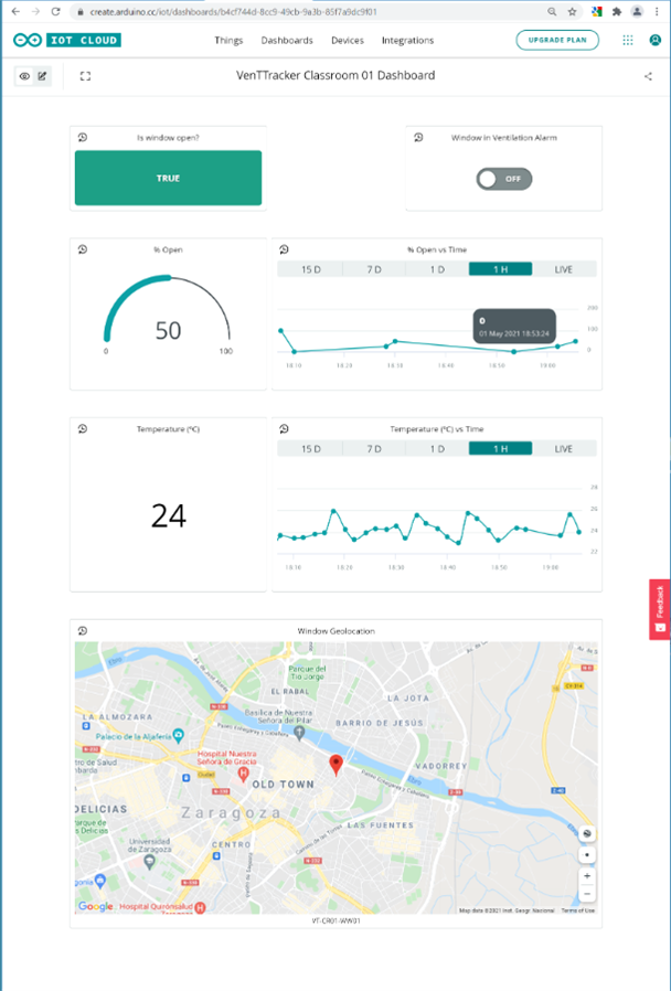

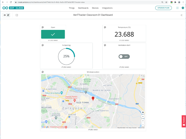

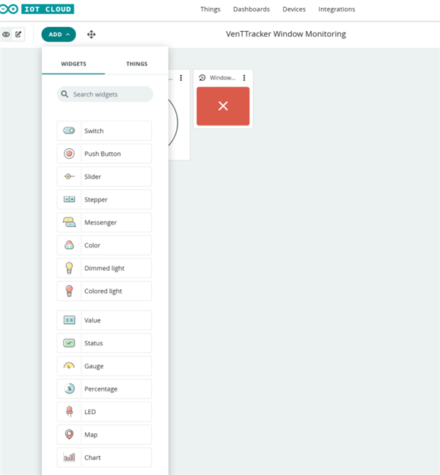

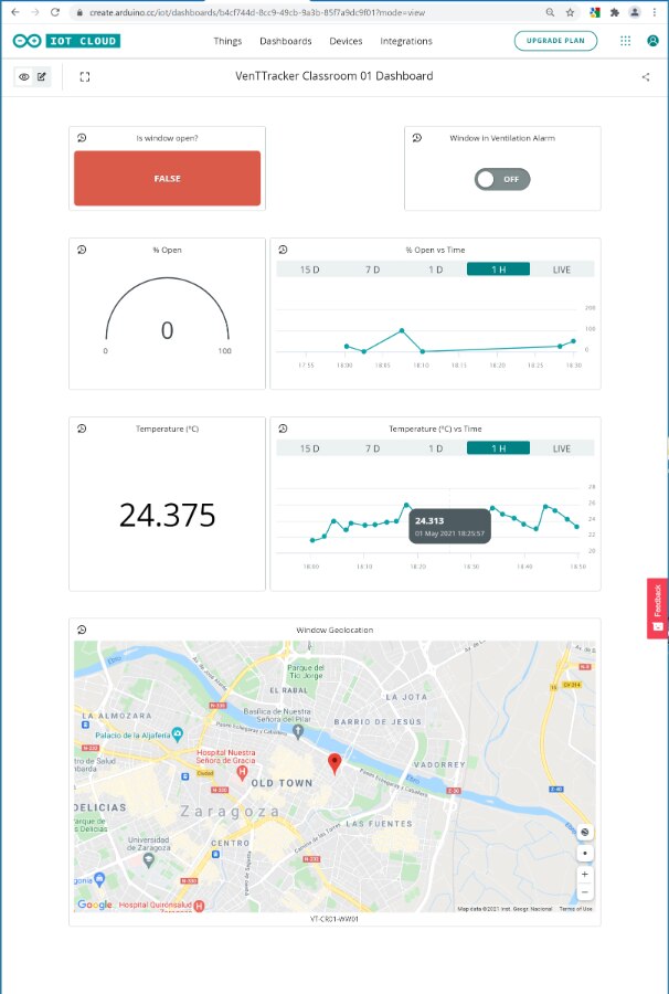

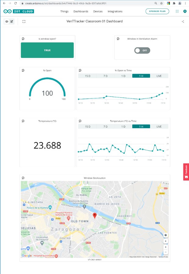

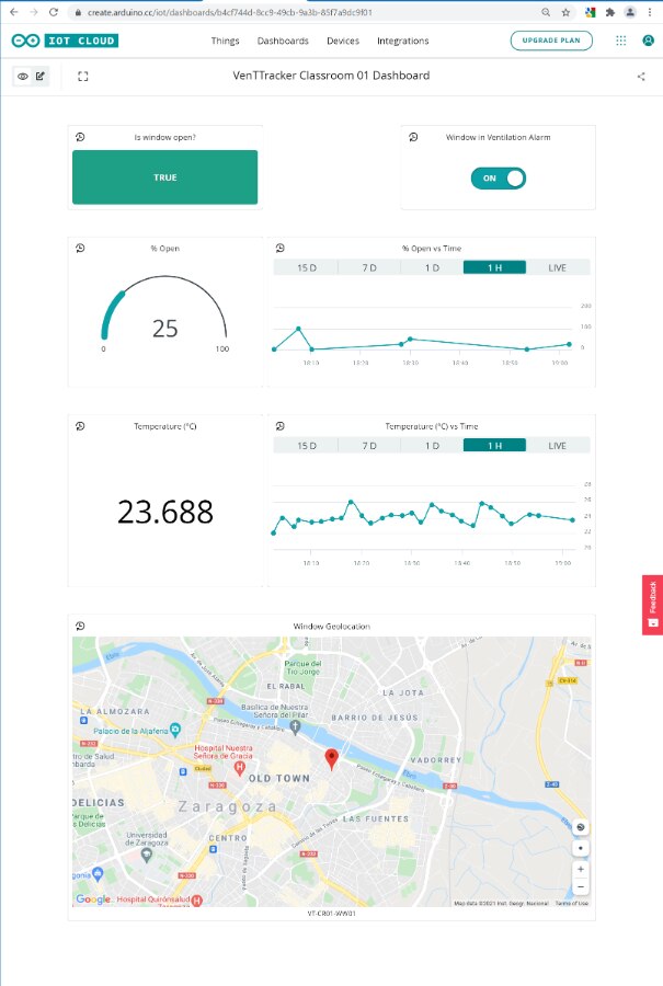

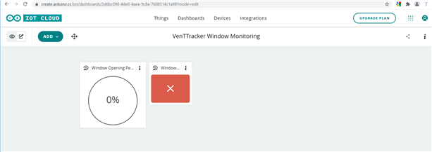

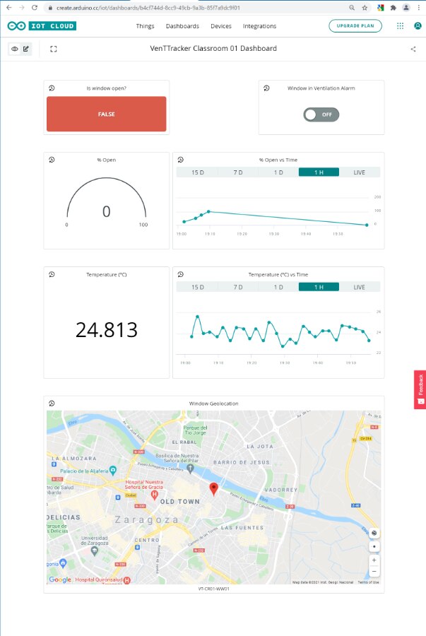

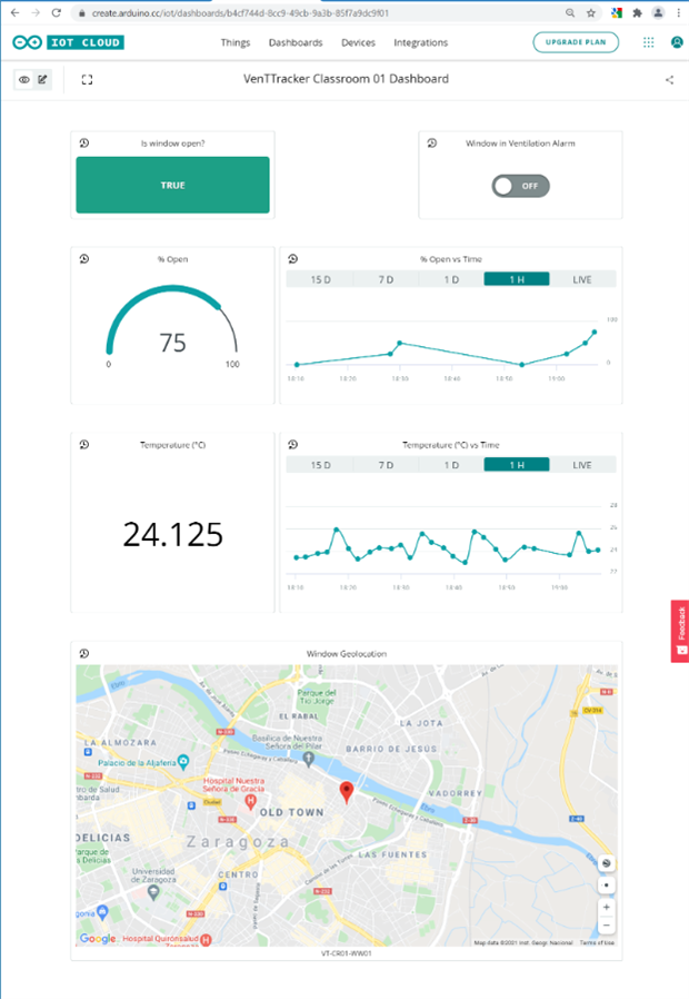

Dashboard
The dashboard is the cloud monitoring and control center! In the panel we have included several widgets linked to our variables
Dashboard Widgets

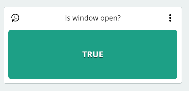

Is the window open? widget
"Is the window open?" widget tells us if the window is open or closed

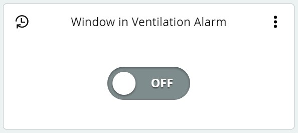

"Window in ventilation alarm"  widget
"Window in ventilation alarm" allows us to put the sensor of that window in an alarm state or to know if it is still in an alarm state.

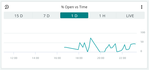

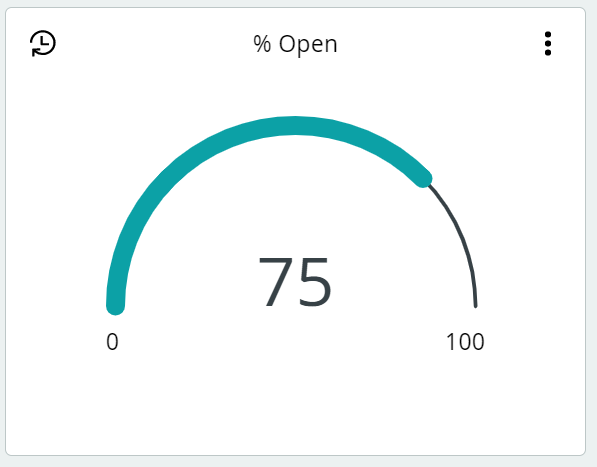

"% open" widget
"% open" allows us to know the degree of opening of the window in percentage.
"% opening vs time"  widget
The graph of "% opening vs time" allows us to graphically see the historical information of the degree of opening of the window in time.

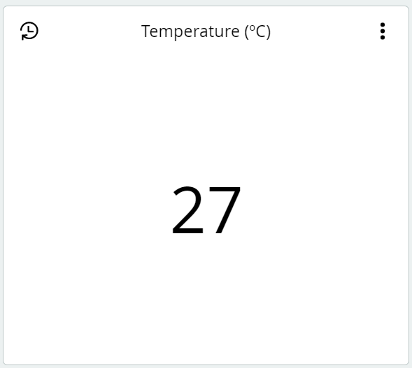

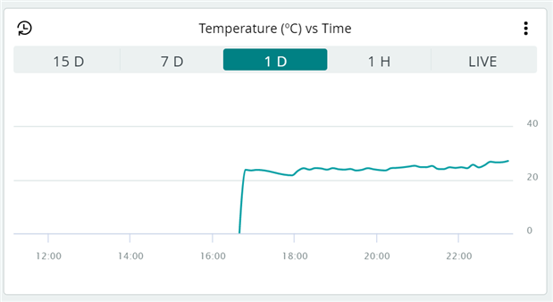

"Temperature (ºC)" widget
The temperature widget allows us to view the last temperature reported by the sensor in ºC
"% temp vs time" widget
The graph of "% temp vs time" allows us to graphically see the historical information of the temperature reported by the window sensor over time.

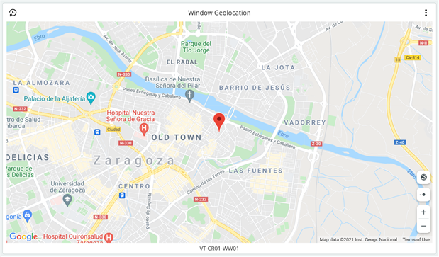

"Window Geolocation" widget
The Window Geolocation widget shows the location of our window sensor device.

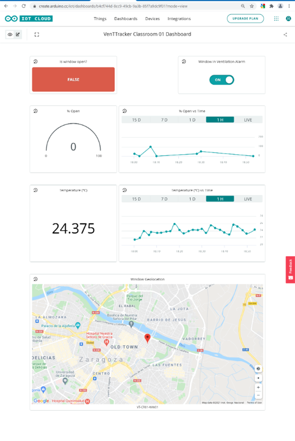

The Dashboard in Action
Window closed, with alarm state
Ventilation Alarm State Change
Window closed, no alarm state
Window 25% open
Window 50% open
Window 75% open
Window fully open

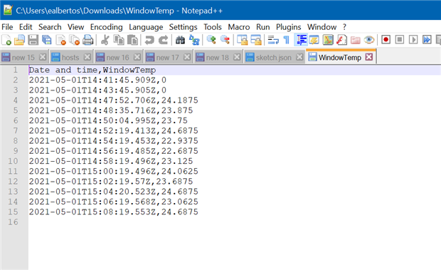

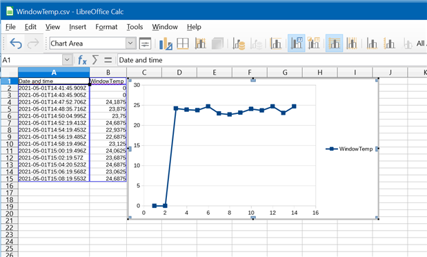

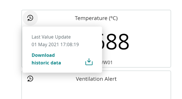

Download Historical Data

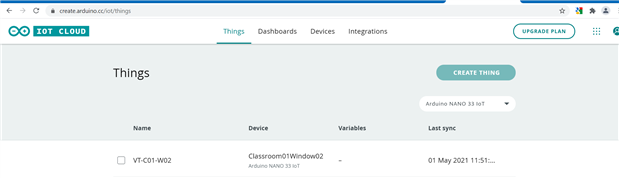

Step by Step creation of the Thing and Dashboard
The Create Environment

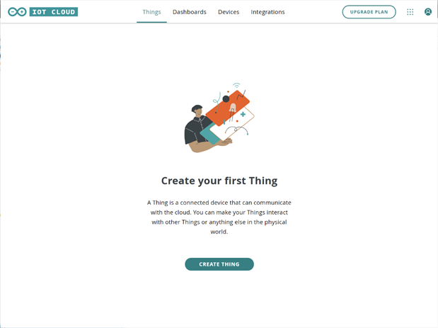

Go to https://store.arduino.cc/digital/create and select IoT Cloud
Create thing

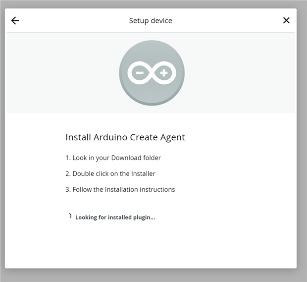

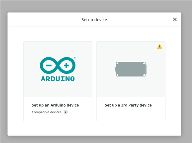

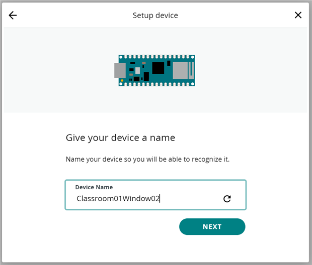

Set up an Arduino Device

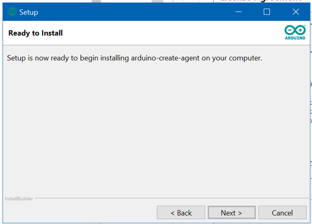

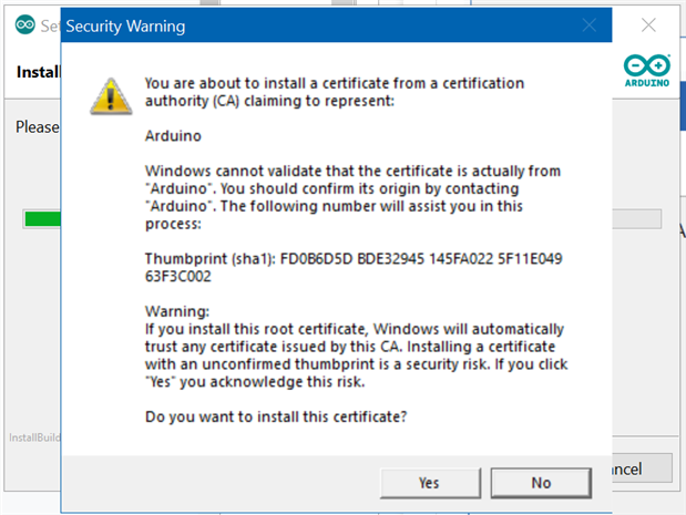

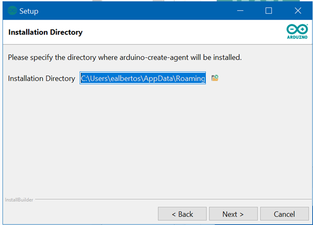

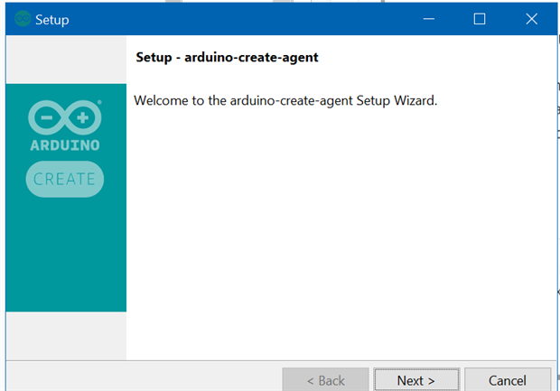

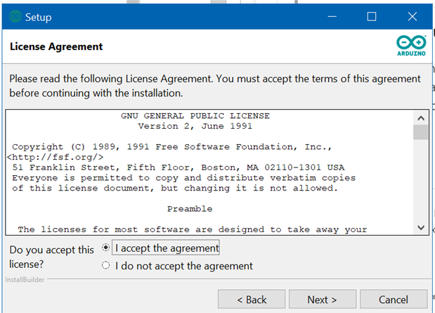

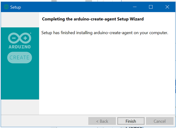

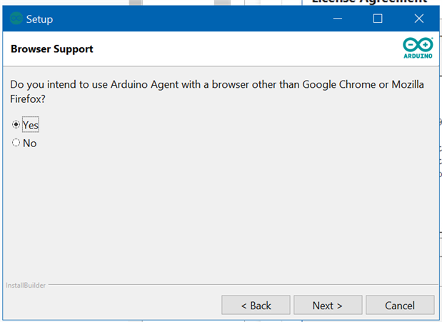

We install the Arduino Create Agent plugin
Run the installer
Accept the license
Specify the directory for the installation of the agent:
Accept the certificate
Back in your web browser, chrome for us.

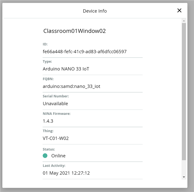

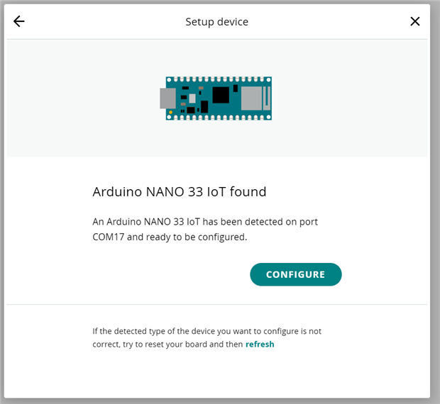

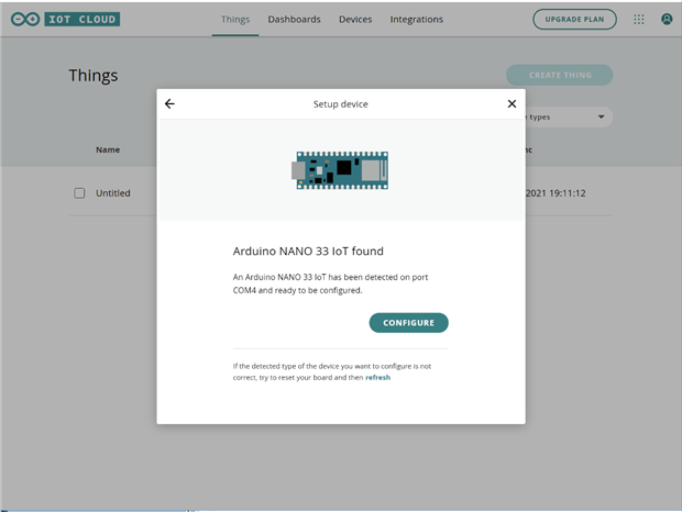

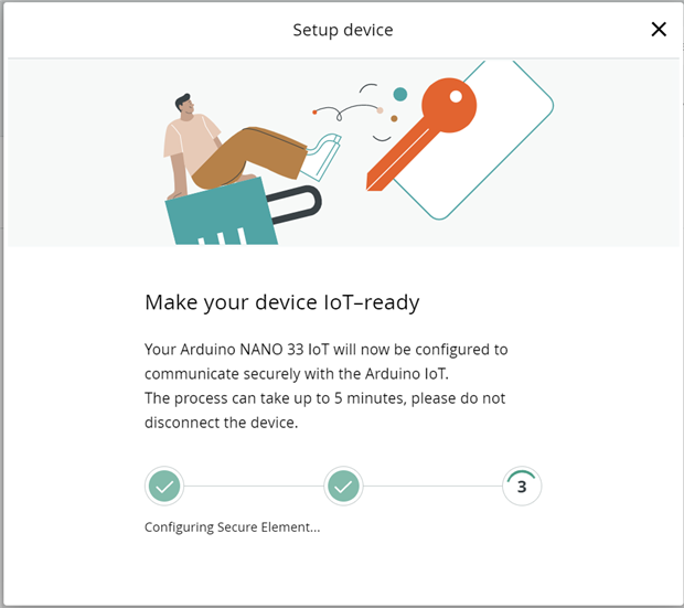

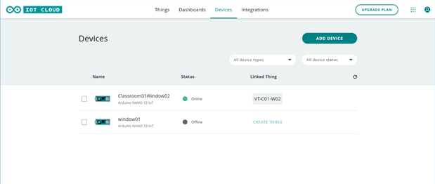

Connect your Arduino NANO 33 IoT by USB
Configure your device

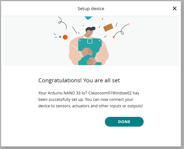

Name it
Let the agent communicate with your Arduino:
You are done

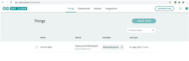

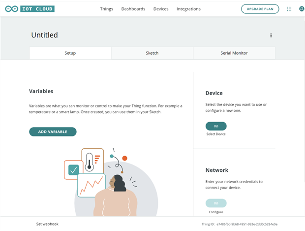

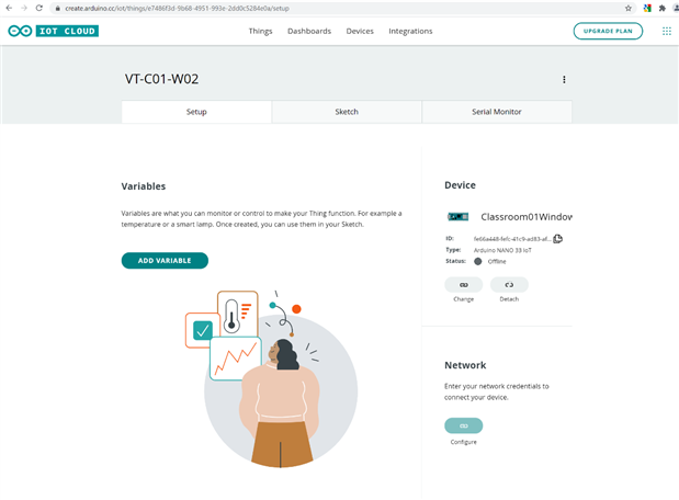

Your first Thing
Create your variables by adding them:
Add Variable
Add and Edit variables

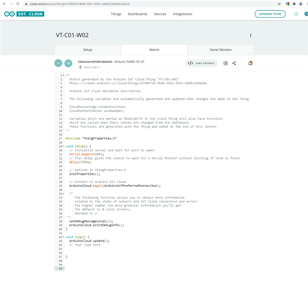

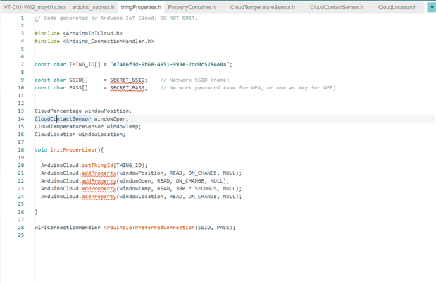

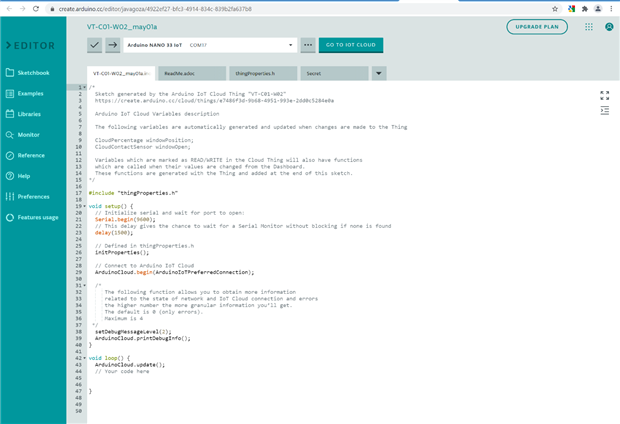

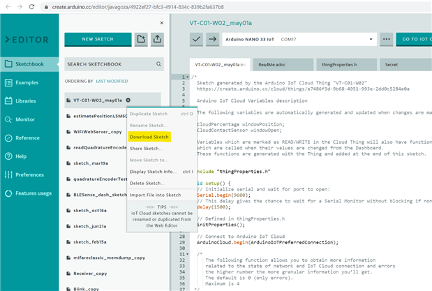

Automatic Sketch Generation
  Sketch generated by the Arduino IoT Cloud Thing "VT-C01-W02"
  https://create.arduino.cc/cloud/things/e7486f3d-9b68-4951-993e-2dd0c5284e0a

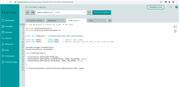

  Arduino IoT Cloud Variables description
  The following variables are automatically generated and updated when changes are made to the Thing
  CloudContactSensor windowOpen;
  Variables which are marked as READ/WRITE in the Cloud Thing will also have functions
  which are called when their values are changed from the Dashboard.
  These functions are generated with the Thing and added at the end of this sketch.
#include "thingProperties.h"
void setup() {
  // Initialize serial and wait for port to open:
  Serial.begin(9600);
  // This delay gives the chance to wait for a Serial Monitor without blocking if none is found
  delay(1500);
  // Defined in thingProperties.h
  initProperties();
  // Connect to Arduino IoT Cloud
  ArduinoCloud.begin(ArduinoIoTPreferredConnection);
     The following function allows you to obtain more information
     related to the state of network and IoT Cloud connection and errors
     the higher number the more granular information you’ll get.
     The default is 0 (only errors).
     Maximum is 4
  setDebugMessageLevel(2);
  ArduinoCloud.printDebugInfo();
void loop() {
  ArduinoCloud.update();
  // Your code here

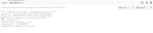

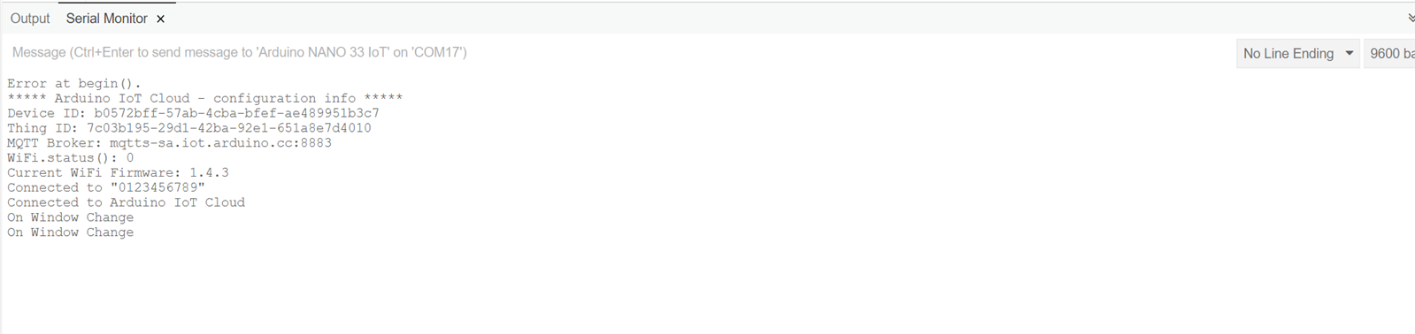

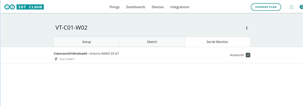

Serial monitor view

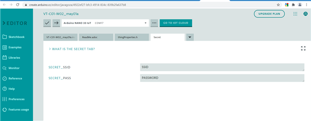

I do not feel safe uploading the credentials of my Wi-Fi network to the Internet so from now on we will work the sketch locally.

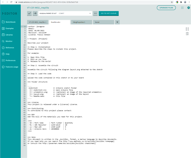

Open in full Editor the Sketch:
VT-C01-W02_may01a.ino tab
ReadMe.adoc tab
ThingProperties.h tab
Secret Tab
Download Sketch to local drive
Open in local Editor

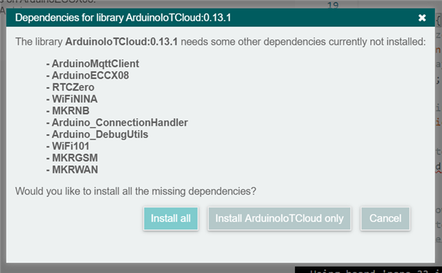

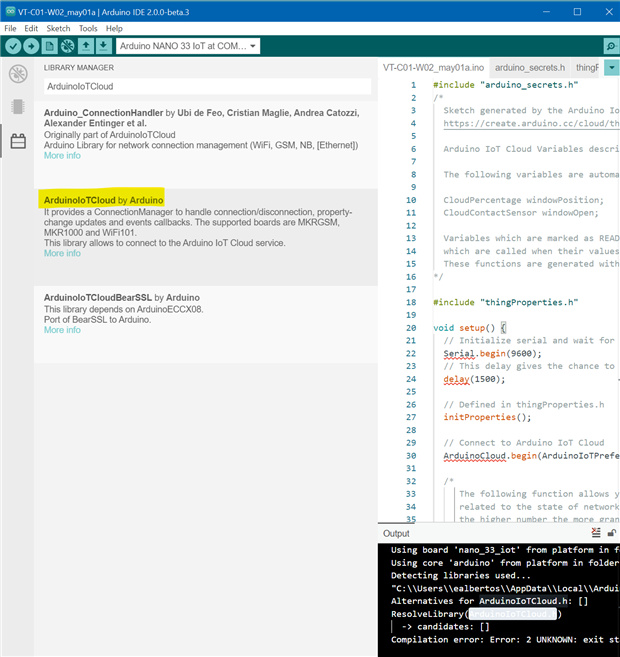

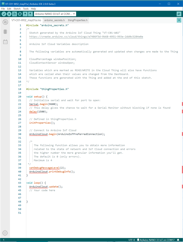

Adding library ArduinoIoTCloud.h
Install all
Verify Sketch
The first compilation takes a long time.
Without having programmed a single line of code, this is what we have left for our program
Sketch uses 143844 bytes (54%) of program storage space. Maximum is 262144 bytes.
Global variables use 20592 bytes (62%) of dynamic memory, leaving 12176 bytes for local variables. Maximum is 32768 bytes.

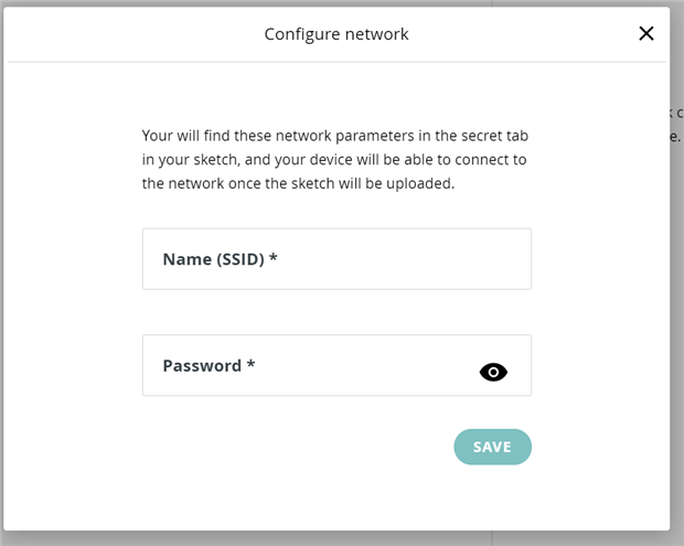

We update the wifi credentials in the arduino_secrets.h file
#define SECRET_SSID ""
#define SECRET_PASS ""
Lets upload and run the sketch

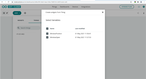

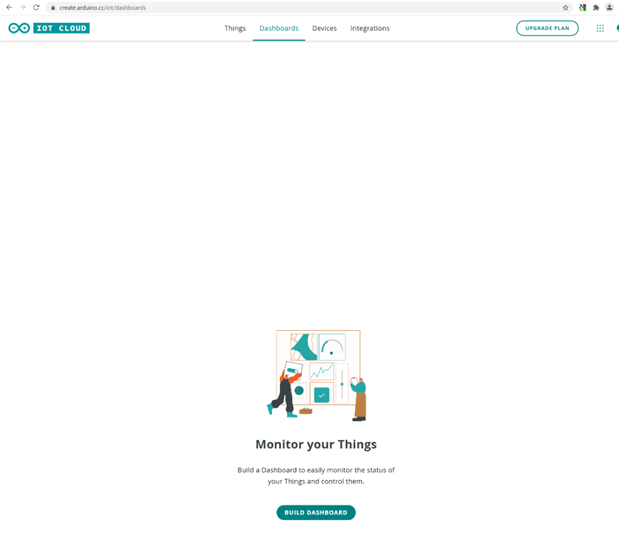

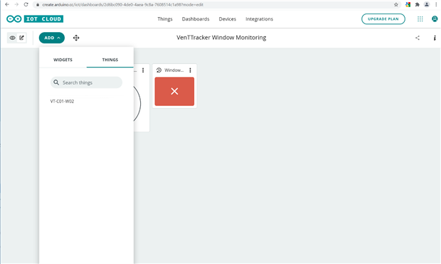

Create a Dashboard
Build dashboard
Add
View Dashboard
Adding a new variable. Let's add a variable for the window temperature
Adding a new device
The sketch changes, a new property is added
We have created a new variable and added it to our local Sketch. But the variable is not refreshed.

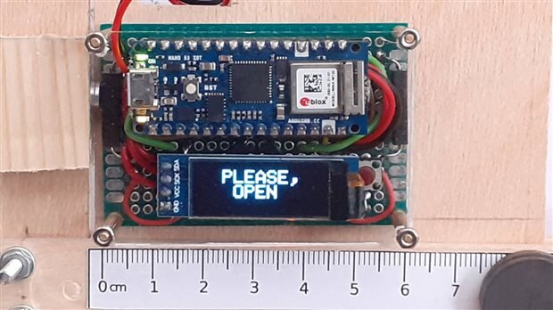

The demo code
#include "arduino_secrets.h"
  This is an example for testing the VenTTracker Window Sensor
  connecte to Arduino IoT Cloud.
  Displays a progress bar indicating the window openes on
  a Monochrome OLED display based on SSD1306 drivers.
  This example is for a 128x32 pixel display using I2C to communicate
  3 pins are required to interface (two I2C and one reset).
  Lights LED according sensor events:
                       | LEFT LED  |  RIGHT LED  |
  WINDOW OPEN EVENT    |    OFF    |    OFF      |
  WINDOW CLOSED EVENT  |    ON     |    ON       |
  TO THE LEFT MOVEMENT |    ON     |    OFF      |
  TO THE RIGHT MOVEMENT|    ON     |    OFF      |
  Hardware. Pinout
    8 A4/SDA Analog ADC in; I2C SDA; SDA to SDA OLED Display
    9 A5/SCL Analog ADC in; I2C SCL to SCK OLED Display
    13 RST Digital In Active low reset input  RESET to push button. Other end to ground.
    14 GND Power Power Ground to Battery  -
    15 VIN Power In Vin Power input VIN to Baterry  +
    20 D2 Digital GPIO - to Open/Closed Reed Switches
    25 D7 Digital; Right LED with a 100 Ohm resitor to ground
    26 D8 Digital GPIO to Left LED with a 100 Ohm resitor to ground
    27 D9/PWM Digital GPIO to  Right Reed Switch. Other end to ground.
    28 D10/PWM Digital GPIO;  to Left Reed Switch. Other end to ground.

LSM6DS3 IMU(I2C_MODE, 0x6A);
void setup() {
  Serial.begin(9600);
  delay(5000);
  setupAccelerometer();
  initProperties();
     Maximum is 4
  setDebugMessageLevel(4);

  windowLocation =  Location(41.652785957455f,  -0.8729272143593402f);
  windowOpen = !windowState;
  windowTemp = IMU.readTempC();

void setupAccelerometer() {
  IMU.begin();
void onWindowAlertChange() {
  Serial.print("On Window Change\n");
  if(windowAlert) {
    digitalWrite(LED_BUILTIN, HIGH);   // turn the LED on (HIGH is the voltage level)
    displayOpenWindow();
  } else {
    digitalWrite(LED_BUILTIN, LOW);    // turn the LED off by making the voltage LOW
  Interrupt Service Routine for Falling Edge in Left Switch Port
void isrFallingLeftSwitchPort() {
  if ((millis() - lastLeftSwitchDebounceTime) > debounceDelay) {
    if (digitalRead(rightSwitchPort) == HIGH) {
      if (encoderPosition > 0) {
        encoderPosition--;
      lastWindowDirection = LEFT;
    } else {
      if (encoderPosition < 3) {
        encoderPosition++;
      lastWindowDirection = RIGHT;
    lastLeftSwitchDebounceTime = millis();
    encoderChangePending = true;
  Interrupt Service Routine for Changing Edge in Open Close Switches
  when the window is closed light the two LEDS
void isrChangeOpenClosedSwitchPort() {
  windowState = !digitalRead(openClosedSwitchPort);
    encoderPosition = 0;
    openCloseChangePending = true;
* Print the progress bar
void drawProgressBar(const int counter) {
  display.clearDisplay();
  canvas.fillScreen(BLACK);
  canvas.setCursor(0, 0);
  canvas.setTextSize(2);
  canvas.print((counter+1)*25);
  canvas.print("% ");
  canvas.print(IMU.readTempC(),1);
  canvas.print("C");
  for(int i = 0; i < 4; ++i) {
    canvas.drawRect(i * SCREEN_WIDTH / 4, SCREEN_HEIGHT / 2,SCREEN_WIDTH /4 , SCREEN_HEIGHT / 2 , WHITE  );
  for (int i = 0 ; i <= counter;++i) {
      canvas.fillRect(i * SCREEN_WIDTH / 4+3, SCREEN_HEIGHT / 2 + 4,SCREEN_WIDTH /4 -6, SCREEN_HEIGHT / 2 -8, WHITE  );
  display.drawBitmap(0, 0, canvas.getBuffer(), 128, 32, WHITE,
                     BLACK); // Copy to screen
  display.display();
void displayOpenWindow() {
  canvas.println("  PLEASE,");
  canvas.print(  "   OPEN ");
  display.display();
  Send a logo to the Display and center it and wait 1 second
void drawLogo(const unsigned char* logo, const int width, const int height ) {
  display.drawBitmap(
    (display.width()  - width ) / 2,
    (display.height() - height) / 2,
    logo, width, height, 1);
  display.display();
  blinks a logo on the display
void blinkLogo(const unsigned char* logo, const int width, const int height) {
    // After reset blink the logo
  drawLogo(logo, width, height);
  //Invert and restore display, pausing in-between
  display.invertDisplay(true);
  delay(1000);
  display.invertDisplay(false);
  delay(2000);
Summary
It has been very easy to connect our sensor to the Arduino IoT cloud. The entire process including the documentation has not taken more than an hour of work.
To do the full demo we wanted to have connected three window sensors but the free plan did not allows us to connect more than one device or manage more than 5 cloud variables without upgrading to a paid plan.
