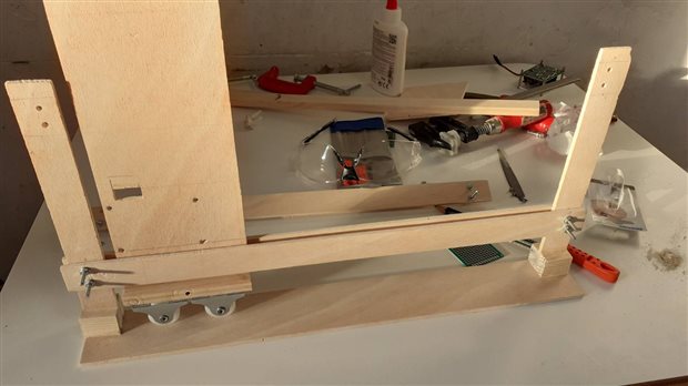

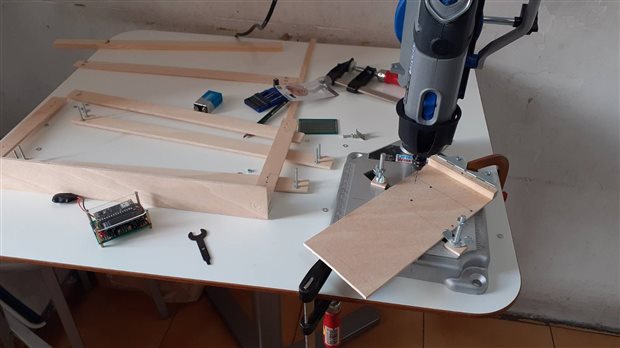

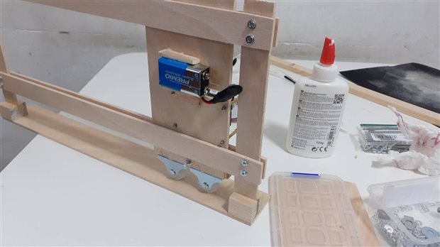

During this week we have finished placing our window sensor prototype in the window mockup built weeks ago. We have modified the mockup to be able to screw the sensor and place a 9v battery behind it. We have also added a numerical ruler and several equally spaced magnets so that we can test our sensor. Several programs have been carried out to visually demonstrate the operation of the sensor obtaining the positioning by means of the linear encoder made with the magnetic reed sensors.
  Design for A Cause 2021 the VenTTracker project

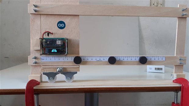

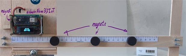

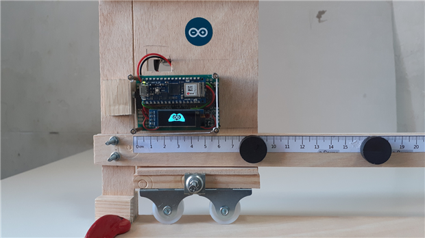

In the following video we can see graphically the operation of our sensor by a progress bar on the OLED DisplayOLED Display. Our final version of the sensor will not have the graphical display, only two LEDs located at the bottom. The LED will remain on the design off and only switched to temporarily indicate the movement of the window or opening or closing events. In this way we can minimize energy consumption and extend the useful life of the battery.
Visualizing the degree of openness
When the sensor detects that the window is closed it displays the logo of our design challenge, :

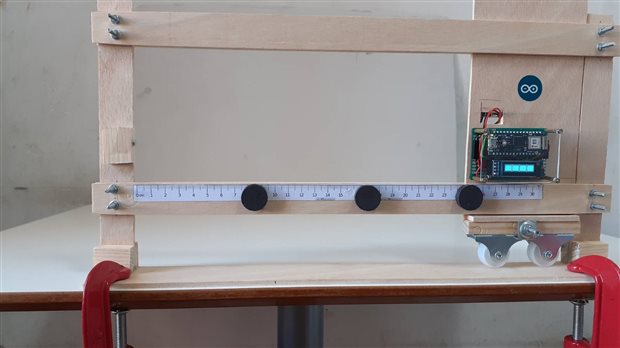

The window has been opened. The progress bar shows an approximate 25% open.

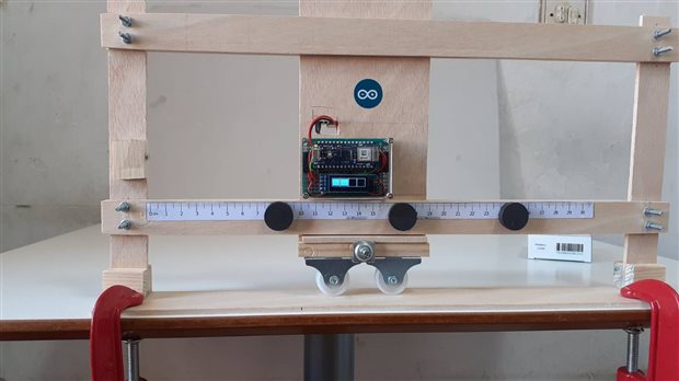

We continue to open the window halfway. The progress bar reaches the middle indicating an approximate 50% open.
Once the second magnet has passed, we are already at approximately 75% opening.
And finally we can consider that the window is already completely open.
Depending on the number of magnets that we place, we can increase or decrease the precision of our sensor.
For our final version we consider that two magnets will not be enough.
Being able to have a scale that indicates:
  1. Closed window
  2. Window open below 33% open
  3. Open window between 33% and 66% open
  4. and open window between 66% and 100% open.

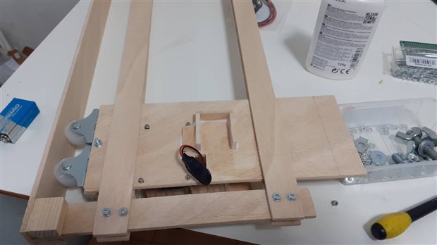

For the mockup we have placed a 9v battery at the back of the sliding part of the window.
We have prepared a bed for the battery and it is held with an elastic band.
When the sensor is started, the  design challenge slogan and logo are displayed on the screen.

Adapting our mockup for the prototype.
We disassemble the mockup to make the holes where our sensor will be located and screwed.
After drilling the moving part and checking that everything fits without friction, we reassemble the model.
We prepare a bed for the 9v battery at the rear of the moving part of our model. The bed is glued.
The battery cables pass through a hole also made in the moving part.
The battery fits well in its bed.
To prevent movement will be secured with a rubber band.
Then we glued a graduated ruler and three equally spaced magnets for our linear position encoder.
And a fourth magnet for the detection of the closed window state.
The sensor is now ready for the first tests.
Finally we tested the prototype already assembled in the model.
It seems that everything works as we wished and we can estimate the position of the window using our linear position encoder.
This will help us gauge our version of the sensor based on accelerometer and automate the labeling of samples for our learning model machining.
