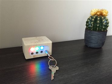

Key Holder
A mini build which was not originally foreseen, but which I thought would fit nicely in this challenge. The concept is simple: four connectors are foreseen to which keys can be attached. When a key is attached, a GPIO pin changes status, reporting the change to the control unit.
A future improvement could be to either use a different connector per key, or make use of different resistors and an ADC to know which key is inserted where.
The full project is described in a dedicated blog post:

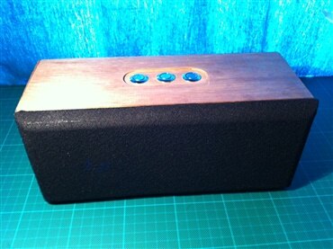

Alarm Clock
The idea of the smart, voice-controlled alarm clock started in 2014. The result was a functional prototype, but too slow and bulky to be really useful. This challenge was the perfect opportunity to revisit this project, and I'm quite happy with the way it turned out!
Here's a side-by-side comparison:
The original Raspberry Pi 1 B with Wolfson audio card has been replaced by the new Raspberry Pi 3 B with USB microphone and I2S audio module. The difference in performance is incredible. The result is a near real-time, voice controlled device capable of verifying sensor status, fetching internet data such as weather information or even playing music.
Most of the work was done for this device, and simply reused by the others. The posts cover voice control, setting up OpenHAB, controlling displays, and much more:

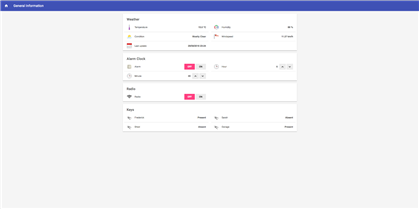

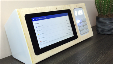

Control Unit
The Control Unit has the same guts as the alarm clock: I2S audio, USB microphone, speaker, Raspberry Pi 3, etc ... It does however add a keypad and touch screen, allowing control via touch on top of voice. The keypad switches between different webpages on the touch screen, which is locked in kiosk mode.
The touch screen can be used to trigger actions, visualise historic data (power consumption, temperature), consult the weather, etc ...
