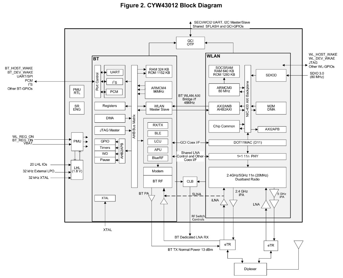

In the datasheet you can find following block diagram.
  From that diagram we can see that BT and Wi-Fi parts are independent. Each part has own ARM Cortex-M core. Wi-Fi part is controlled by CM3 running at 80 MHz and BT part is controlled by CM4 running at 48 MHz (diagram specifies 96 MHz, but later in text there are note that It runs only at 48 MHz because Cypress did not test anything else and their SDK do not use higher frequency. Do not confuse cores with cores presented in main MCU. These cores are used only for running internal firmware for controlling antennas transmitters and receiver and controlling other parts of that chip.
Second important part of that block diagrams are external interfaces to communicate with chip.  Bluetooth side supports some wakeup signals, UART, SPI, PCM, I2S and some GPIOs. That are interfaces supported by chipset. Not all signals are connected from the chipset outside module to the board or main MCU. One wakeup signal is connected to MCU, second is unconnected. UART (and probably also SPI, but it is not mentioned in documentation explicitly) is connected to MCU and is exported from the module to unsoldered connector also. I2S is not routed to MCU directly. It is routed to unsoldered connector If you want to use it. I think you can use it If you want do audio related Bluetooth application. But if you want to process audio using main MCU you must manually wire it from unsoldered connector to expansion port because it is not internally connected to MCU. PCM is not available at all. And GPIOs are available thru unsoldered connector and they are not routed to MCU. So, only UART is routed to MCU and other buses (except PDM) are available thru extension port If you want to use them.
Communication with Wi-Fi side is mainly done using SDIO, UART and GPIOs. SDIO is connected to MCU and not exposed on board. It makes sense because it is high speed bus and signal integrity is important. In opposition UART is exposed on board but it is not connected to MCU. There is also JTAG which is not designed to be used by anyone. It is exported on unsoldered SMT connector available at bottom side of board.
I was thinking about it. I think that It make sense. For BT there are UART which you can drive from the main MCU or If you want evaluate module by another external platform you can access it by soldering missing connector. Similarly, Wi-Fi is accessible by SDIO from main MCU and If you want to evaluate it by another external platform, you can do that using UART exposed on the same normally unsoldered connector.
