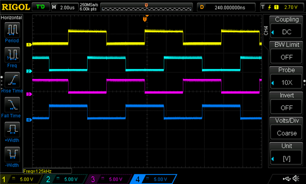

shabaz made a Software Defined Radio (SDR) Experiment Board. One of the components is a digital quadrature oscillator.
It's a circuit with 4 PWM outputs that are each 90° shifted.
In Shabaz' blog, the oscillator is made with flip-flops, and controlled by an external function generator.
Because it's the Summer of FPGAs, I'm proposing 2 FPGA based alternatives.
They work identical, generate the same frequency (input / 4), but the approach is different.
One works by replaying a predefined output pattern on the 4 outputs, with one clock delay for each output.
The second one by calculating the first channel based on a counter value, and left shifting the data through the outputs.
The entity is identical for the two approaches:

This is the first implementation.
The pattern used to define the outputs is 0011001.
Each of the pins continuously cycles through a (different!) range of 4 bits of the pattern, on the cadence of the clock.
pin 0 from 3 to 6: 1100
pin 1 from 2 to 5: 0110
pin 2 from 1 to 4: 0011
pin 3 from 0 to 3: 1001
They do this at the same time, in parallel.
You can see that this generates an output where each of the pins is 90° shifted.

The second implementation takes a different approach.
The data is the output vector is shifted 1 position to the left. That generates 90° phase shift.
I only have to take care that I set the LSB correct each time. For that, I use the MSB of the counter, inversed.
The counter is 2 bits. It cycles 00 -> 01 -> 10 -> 11.
If you take the MSB each time, inversed, you get 1100.
That's the identical as the output of pin 0 in the first implementation. The left-shift does the rest of the magic for the other 3 pins.

I've attached Vivado project and Jupyter notebook. Implementation #2 is active, approach #1 is commented out.
The VHDL for #2 is adapted, see https://www.element14.com/community/groups/fpga-group/blog/2021/08/04/learning-xilinx-zynq-a-quadrature-oscillator#comme… .
Latest source on github: https://gist.github.com/jancumps/0a1b2692ddfd6edc79e8487adc66539e
Which design do you prefer? Or do you have an alternative?

    Jan Cumps over 5 years ago in reply to Jan Cumps
    It works.
    With a clock of 100 MHz, and an 8 bit divider, I have between 48.8284 KHz and 12.5001 MHz.
    First step approx. 371 Hz, last one 6.25 MHz.
    There are many VHDL runtime configurable clock dividers available online. I've written one myself for this exercise:
