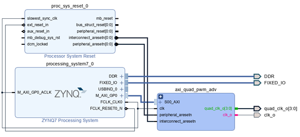

This post is a follow up on a previous article to generate a quadrature clock for shabaz 's Software Defined Radio (SDR) Experiment Board.
It's a circuit with 4 PWM outputs that are each 90° shifted.
I'm adding programmable frequency control. Without the need to change the fabric clocks.
It will be a VHDL module, that's put in between the fabric clock and the quadrature oscillator from the previous blog. A register allows you to control the output frequency.

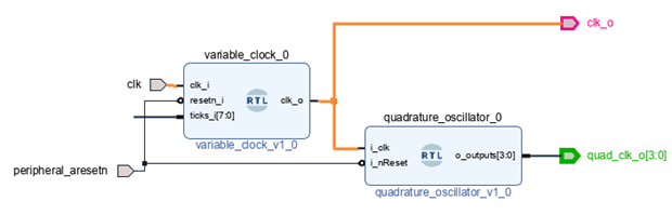

The purpose of this variable frequency block is to  control the speed of the quadrature oscillator of the previous post. This is an easy exercise, done in Vivado.
Remove the link between fabric clock and quadrature oscillator clock input.
Add your new variable clock IP to the design by adding it to the block diagram. Link its clock input to the fabric clock. Clock output to the quadrature oscillator.
I've exposed the variable clock output so that you can probe it and verify the claims above. This is optional.
The reset is shared with the rest of the PL.

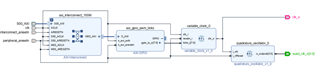

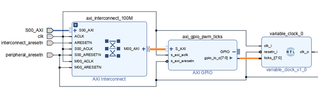

The ticks_i register is an 8 bit input.
In my design, I've attached it to the ARM/Linux part via the AXI interface. That makes that I can program it from the ARM/Linux part.
This is a choice specific to achieve my goal of having it software changeable. You could also control it from an FPGA quadrature decoder block, from 8 input pins, an FPGA sweep generator (counter), ...

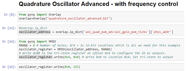

Jupyter notebook
The notebook allows you to load the bitstream into the FPGA, and set the register of the variable clock:

I used a hierarchy to show the variable clock and the quadrature oscillator as one block on the main design:
the content of the dark blue block is the 1st image at the top of this article.
