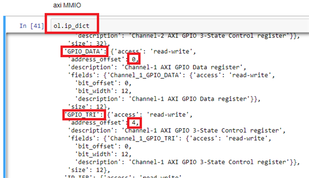

Get the memory mapped address of our interface between ARM and PWM FPGA block
pwm_address = ol.ip_dict['axi_gpio_pwm']['phys_addr']
Set the direction of the memory area from ARM to FPGA
image: the dictionary shows bit width and offset of the different registers we can (and have to) address to set values and direction

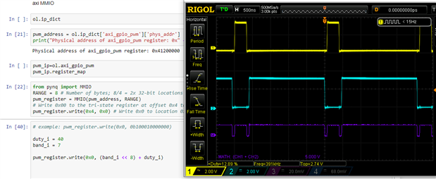

from pynq import MMIO
RANGE = 8 # Number of bytes; 8/4 = 2x 32-bit locations which is all we need for this example
pwm_register = MMIO(pwm_address, RANGE)
# Write 0x00 to the tri-state register at offset 0x4 to configure the IO as outputs.
pwm_register.write(0x4, 0x0) # Write 0x0 to location 0x4; Set tri-state to output

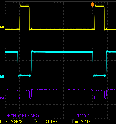

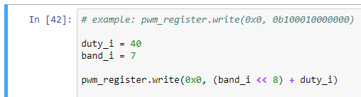

Test it:
duty_i = 40
band_i = 7
pwm_register.write(0x0, (band_i << 8) + duty_i)
This is where you lose a little of the functionality of the lower speed AXI GPIO approach of the previous post.
You write the full register, instead of being able to address bits 0 - 7 and 8 - 11 separately.
But on the other hand, you gain the execution speed that this solution offers.
