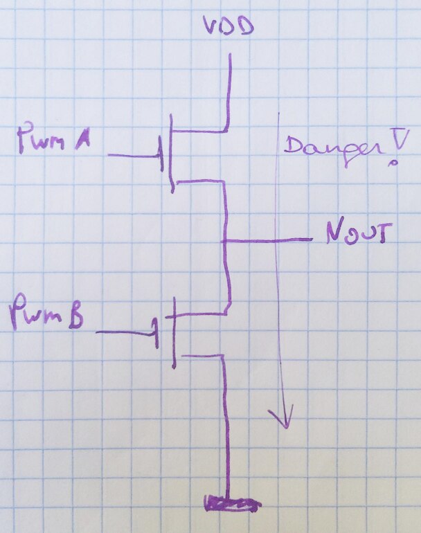

I wanted to use a relevant exercise that solves a common task in electronics: drive a transistor half-bridge. Half-bridge circuits are all around. You'll find them in power designs such as motor control, buck converters, ... Virtually every digital output pin of a microcontroller has one.
It's a very common and well known design, and it's easy to translate the requirements into criteria for a digital driving circuit. And that's what we're making here: a digital circuit for an FPGA, with VHDL.
The PWM block is made to control this type of half-bridge circuits:
When you control such a design, there is always one watch-out: both transistors should never conduct at the same time. Because you would short the power supply directly to ground (shoot-trough).
Because there is a little delay between closing the gate and switching off the source-drain channel, you can't drive the two transistors with a simple inverted signal.
During that delay, both transistors would conduct and there would be a high current directly from power supply to ground. Ignoring to deal with this will destroy the transistors in seconds.
The remedy is to put a waiting time between switching off one transistor, and witching on the other one. This time is called dead time or dead band.
For efficient operation of the design, this dead time should be as short as possible. For reliability, it should be long enough to avoid the shoot-through.
This VHDL design can generate the control signals for the two transistors, and gives a very fine control over the dead time (resolution: one clock tick). You can precisely define it, and guarantee that it's always there.

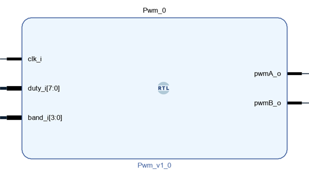

The PWM block has these inputs and outputs:
pin Function
clk_i input: clock signal
duty_i input: 8 bit duty cycle. Range: 0 - 255 == 0 - 100%
band_i input: 4 bit dead time, 0 - 15 clock ticks time between falling edge of one output and rising edge of the other one
pwmA_o output: PWM signal, opposite to pwmB_o, will wait dead time before switching on after pwmB_o becomes low
pwmB_o output: PWM signal, opposite to pwmA_o, will wait dead time before switching on after pwmA_o becomes low
You can control the block from any input that can set duty cycle and dead time.

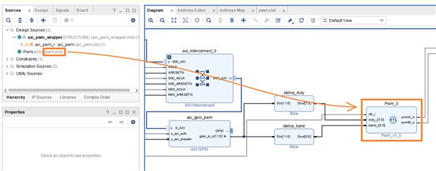

In my Spartan blog, it's controlled by a rotary encoder (mouse scroll wheel) that's connected to the FPGA.
In the recent Vivado / Pynq blogs, these two inputs are controlled by the ARM processors embedded on the Zynq silicon.
It's the exact same VHDL though.

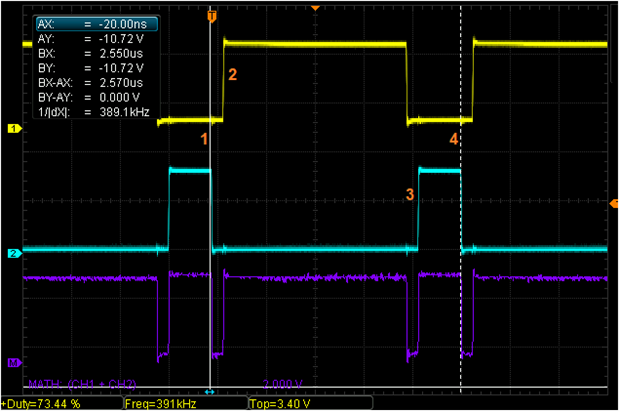

I've loaded the design on a Pynq-Z2, and set duty cycle and dead time:
pwm_register[8:12].write(12)
pwm_register[0:8].write(200)
The oscilloscope shows signal A  (yellow) and B (blue).
I've used the math function A + B to make the dead band visible (purple).
The two cursors show the start and end of a 255 clock tick cycle (white).
  1. start of the cycle. counter = 0
  2. counter = 12. pwmA_o waits 12 clock ticks before being set to 1
  3. counter = 200. pwmA_o is set to 0.
    counter = 200 + 12: pwmB_o waits 12 clocks before being set to 1.
  4. counter = 255. End of cycle. pwmB_o is set to 0.
