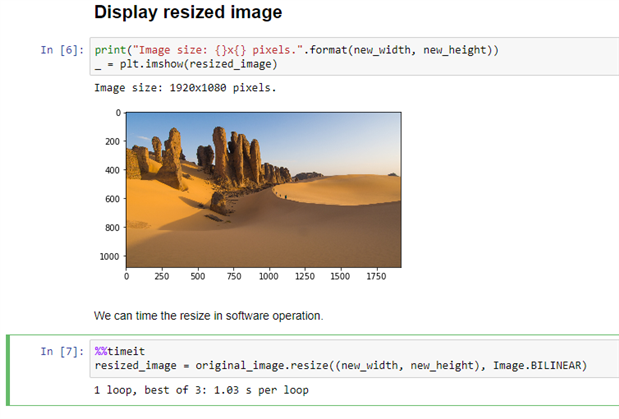

This demo performs the same exercise twice: resize an image from 3840 * 2160 to  1920 * 1080
  • using the ARM processor to execute OpenCV resize calls

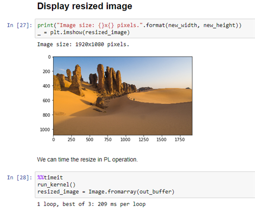

  • using the same function, implemented inside the FPGA fabric.
The results:
in software, it took 1.03 s. In hardware, 210 ms.
The test is both times done in a loop, taking the fastest execution as benchmark. This to take in account optimising, caching, incidental OS activity, ...
The time taken is from having the original image in memory,  to when the algorithm has finished writing the resized image to memory.

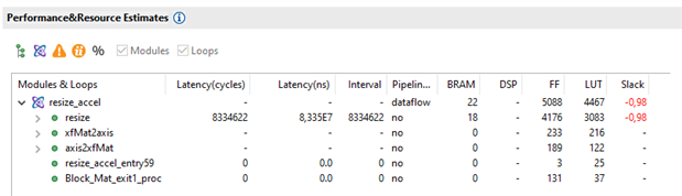

The Accelerated Resize Function Design
This is done in Vitis HLS. The example uses the Xilinx OpenCV port and calls its resize() function.
The C code (full):
void resize_accel(stream_t& src, stream_t& dst,
                  int src_rows, int src_cols,
                  int dst_rows, int dst_cols) {
    // Convert stream to xf::cv::Mat
    axis2xfMat<DATA_WIDTH, TYPE, HEIGHT, WIDTH, NPIX>(src, src_mat);
    // Run xfOpenCV kernel:
    xf::cv::resize<INTERPOLATION, TYPE, HEIGHT, WIDTH, HEIGHT, WIDTH, NPIX, MAXDOWNSCALE>(src_mat, dst_mat);
    // Convert xf::cv::Mat to stream
    xfMat2axis<DATA_WIDTH, TYPE, HEIGHT, WIDTH, NPIX>(dst_mat, dst);
Vitis HLS converts this into an FPGA IP (both Verilog and VHDL source are generated).

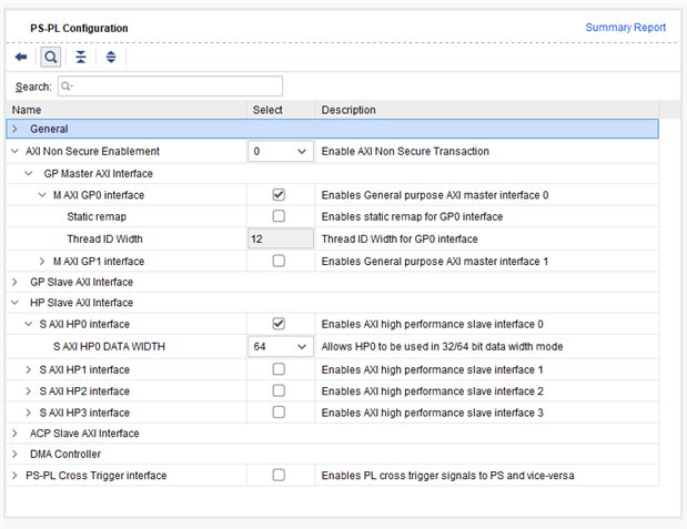

You can use this generated IP similar to other IPs in Vivado. In the image below, it's the orange block.
Inputs and outputs are interfaced with the ARM controllers via the AXI interface.
