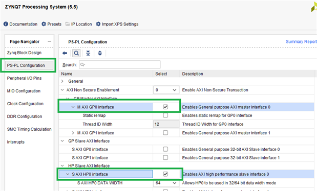

Zynq PS
Enable the two PS - PL interfaces Master AXI GP0 and Slave AXI HP0
Leave all other settings like they were created by the TCL script.

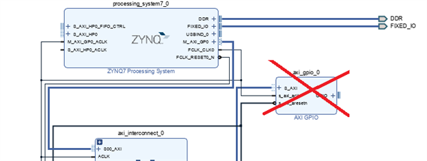

AXI GPIO
Delete it. It's not used in this design.

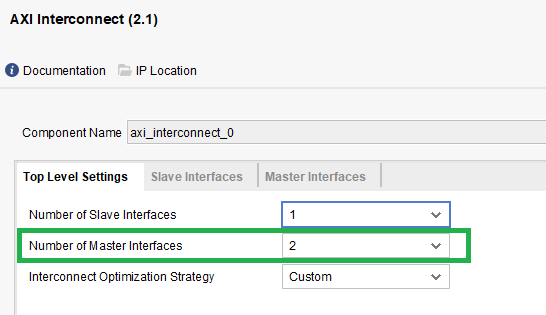

Axi Interconnect
Add an additional Master interface

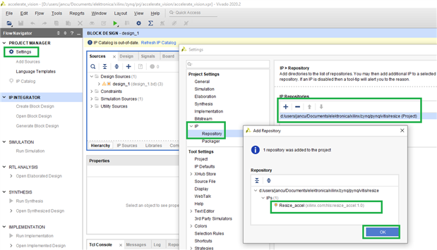

The Vitis HLS Resize Hardware Accelerator
This is the block we created in the previous post. Make it available for this project.
In Project Manager -> Settings, go to the IP Repository screen, and click the +.
Add the location of the Vitis HLS project from that previous post.

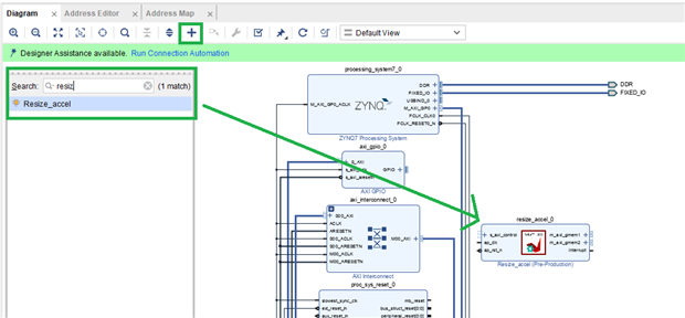

Vivado will tell you that one new IP is available for your design. Your resize_accel.
Navigate to the Block Design screen, click the +, and add the IP to your design.

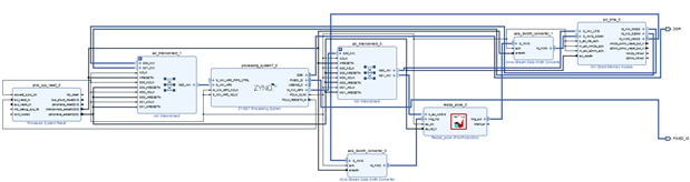

Here I'm stuck image - the Xilinx example builds an AXI Master interface. The HelloWorld example uses AXI Lite. I have to study ...
I have altered the Vision resize example code to adapt use AXI Lite as interface instead of AXI Master. The previous blog is rewritten to reflect that.
When I fully understand the AXI mechanisms, I may revisit this...
