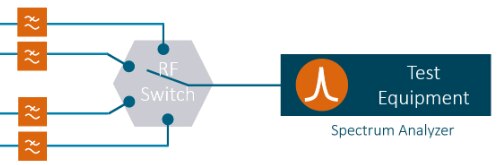

The approach is the digital twin of shabaz ' Building an RF Switching Unit. It also uses 3 2-input blocks to create a 4-input one.
image source: shabaz' post Building an RF Switching Unit

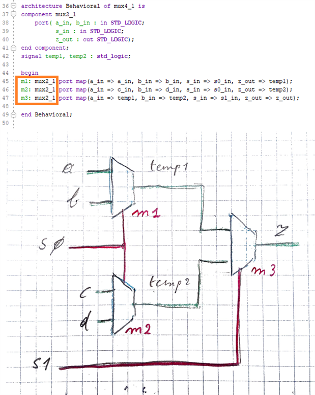

entity mux4_1 is
    Port( a_in, b_in, c_in, d_in : in STD_LOGIC;
          s0_in, s1_in : in STD_LOGIC;
          z_out : out STD_LOGIC);
end mux4_1;
architecture Behavioral of mux4_1 is
component mux2_1
    port( a_in, b_in : in STD_LOGIC;
          s_in : in STD_LOGIC;
end component;
signal temp1, temp2 : std_logic;
begin
m1: mux2_1 port map(a_in => a_in, b_in => b_in, s_in => s0_in, z_out => temp1);
m2: mux2_1 port map(a_in => c_in, b_in => d_in, s_in => s0_in, z_out => temp2);
m3: mux2_1 port map(a_in => temp1, b_in => temp2, s_in => s1_in, z_out => z_out);
end Behavioral;

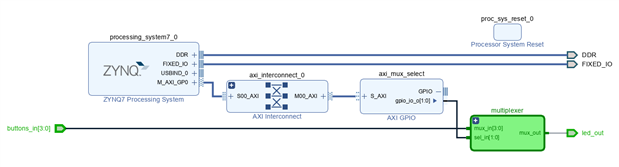

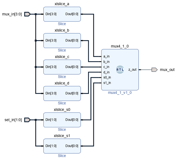

Multiplexer in the Vivado block design
The two inputs and the output are made external in the block design.
mux_in is a vector that represents the inputs a, b, c, d. You'll see later that it's connected to the 4 buttons.
sel_in is the 2 bit register that decides which input will be connected to the output. It's going to be mapped to an ARM/Linux memory address.
mux_out is the output z that will go to an LED.
Check the ALL ABOUT FPGA pages for the truth table.

I'm using the ARM/Linux part of the Zynq to select what input is active. A 2 bit AXI register controls the multiplexer.
image: the selection of the multiplexer is controlled by the ARM.

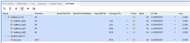

The 4 buttons are tied to the mux inputs (D19, D20, L20, L19), an LED to the mux output (R14).
image: constraints that bind the FPGA pins to the buttons and LED

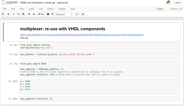

Test from Pynq
The multiplexer is tested in Pynq, with a jupyter notebook.
The first 3 cells load the Vivado FPGA bitstream, and prepare the variable that represents the multiplexer selection register
image: jupyter notebook allows to select input a, b, c or d by writing to the mux register
Then the 4 possible states of the register are defined, and it's put to the test:
mux_register.write(0x0, d)

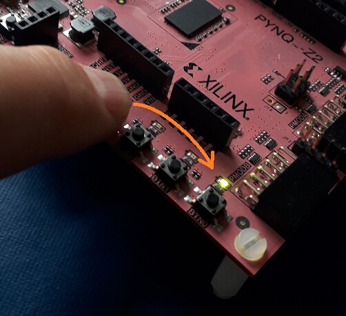

This call links (multiplexes) button BTN3 to the LED LD0
image: the multiplexer in action. Input d is selected.
