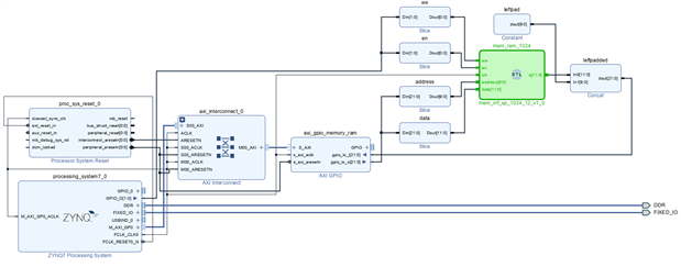

Block Design
I've kept it as simple as I could. Just enough to provide the interfaces described in the previous section.
I'm going to skip explaining the mechanics but will show the configs. Every technique has been used before in this blog series.
click to enlarge
The green block is Michael's Memory module. In the block design, I linked all inputs and outputs to the ARM / Linux interfaces.
For the technology used for each signal between ARM and fabric, see the section above.

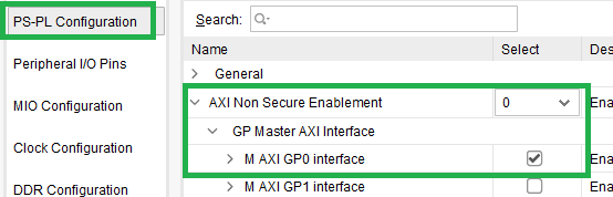

ARM
Zynq AXI for Data and Address register

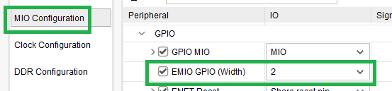

Zynq GPIO for Enable and Write Enable

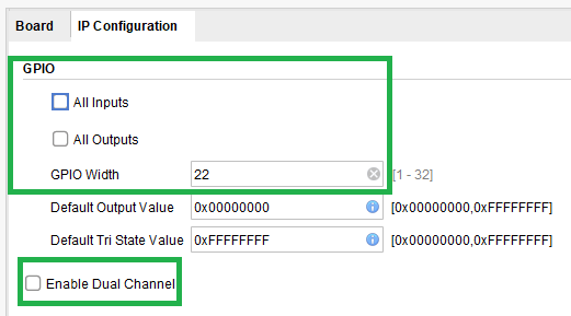

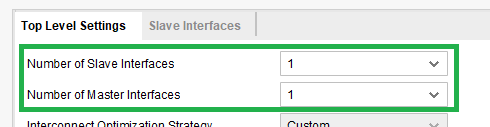

Data and address (AXI)
AXI Interconnect
AXI GPIO

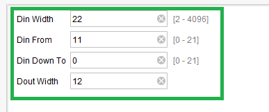

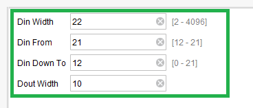

Address slice
Isolates the 10 Address bits out of a 32 bit AXI memory mapped register
Write Data slice
Isolates the 12 Data bits out of a 32 bit AXI memory mapped register

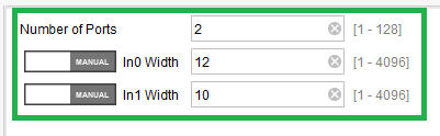

Read Data left-padded with 0
Concatenate (left pad) 10 '0' bits to the 12 data bits data, to fill all bits of the 22 bit wide AXI register
The constant 10 '0' bits

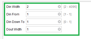

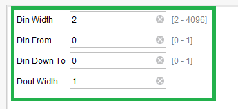

Enable and Write Enable (GPIO)
Enable slice
Isolates the Enable bit out of the 64 bit GPIO interface
Write Enable slice
Isolates the Write Enable bit out of the 64 bit GPIO interface
All of these blocks tie to the VHDL memory block. You'll see that the bit width and directions match.
