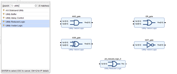

When you're working on a Vivado Block design, you can add IP.
There are 100s of options available. But you will not find a NOT gate, AND gate, ...
They are there though, available under the cryptical name Utility Vector Logic and Utility Reduced Logic
Utility Vector Logic:
Works on vector inputs, and outputs a vector where the logic has been applied to each of the bits.
There is AND, OR, XOR and NOT
Utility Reduced Logic:
Here, the inputs are also vectors, but the result is reduced to a single bit.
You can make an AND, OR and XOR gate.
These blocks are intended as glue logic in the Block Diagram. They are Vivado specific.
