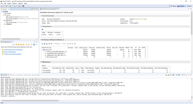

I started over, and now have a successfult synthesis of the resize example. That's the start point of this post.

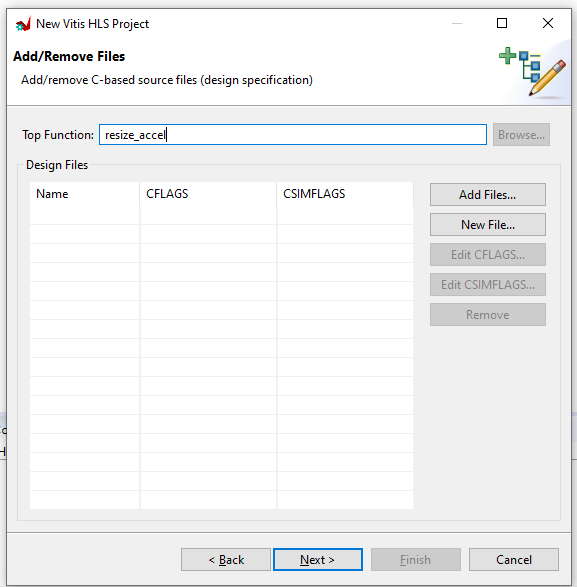

Create a Vitis HLS project
This is the next step: gather the code and simulation sources, get them in a Vitis HLS project and configure it.

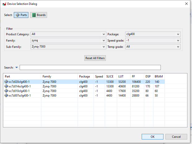

Start Vitis HLS 2020.2, then create a new project.
Name it Resize. Set Top Function to resize_accel.
We could define a number of settings while creating the project, but I'll do that after the creation.
So skip all but the last screen. Then set the Zynq part before confirming:
In my install, it doesn't know the board definition of the Pynq-Z2 that I use. I set the FPGA part by hand.

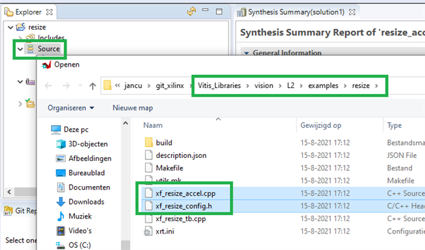

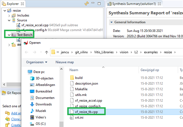

Add source files:
The accelerator has a C++ header and source.
You add them to the project by right-clicking on the source folder in the explorer tree, then select Add Files ...
Use the L1 folder, not L2.
The files aren't copied in the project. They are linked to.

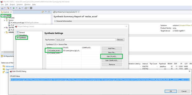

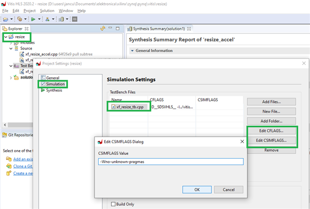

Then we need to set the compiler options for the source file.
I learned that the Vitis toolchain doesn't pick up includes, defines, ... that you set in the Eclipse properties. It's done differently.
Right-click on the project node and select Project Settings. Then select the Synthesis entries.
Select the .cpp file and edit the CFLAGS.
Set them to what reflects the locations for your setup.
I tried to make a Eclipse Path Variable then use the ${...} syntax, but it didn't take.
So here you go - edit to your environment:
-ID:/users/jancu/git_xilinx/Vitis_Libraries/vision/L1/include -ID:/users/jancu/git_xilinx/Vitis_Libraries/vision/L1/examples/resize -ID:/users/jancu/git_xilinx/Vitis_Libraries/vision/L1/tests/resize/resize_DOWN_BILINEAR_NO_RGB -D__SDSVHLS__ -std=c++0x
The nice thing is that this is reflected in the Eclipse Includes Indexer.

Add the simulation files:
Almost the same procedure, but the Test Bench node when adding the file.
Then go to the Project Settings again. Select the test bench source file.
Now set both CFLAGS and CSYMSFLAGS:
CFLAGS:
-D__SDSVHLS__ -I../vitis_lib/vision/L1/include -I../vitis_lib/vision/L1/examples/resize -I../vitis_lib/vision/L1/tests/resize/resize_DOWN_BILINEAR_NO_RGB -std=c++0x -Wno-unknown-pragmas
CSYMSFLAGS:

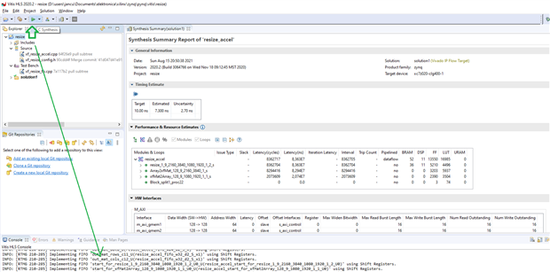

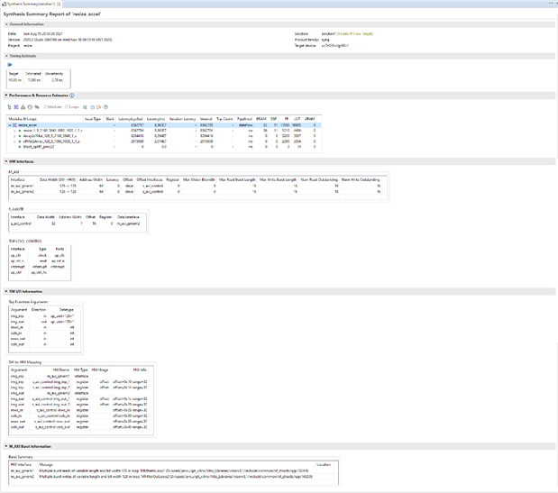

Try a Synthesis
This is a good time to try and build the project.
The result should be a VHDL IP that can be used in Vivado.
Click on the green arrow to run the synthesis. Watch the console for errors.
In the end you get a synthesis report that assesses the amount of FPGA resources will be used.

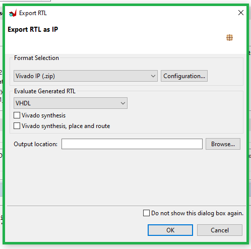

Export the IP as a Vivado RTL
Vitis HLS generates a Vivado IP when you select the Solution -> Export to RTL button.
Keep the defaults - set the language to your selection of choice.
That's it for now. We're finished in Vitis HLS.
