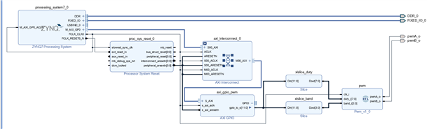

For the processing block, you have to enable AXI and not enable GPIO.
The easiest way to do that is to start from a fresh Zynq block, and run the block automation after that. That's it.
If you replicate this exercise: there is a mistake. The interconnect reset should go tho the first reset of the AXI Interconnect IP.
All other resets should connect to the peripheral reset pin.

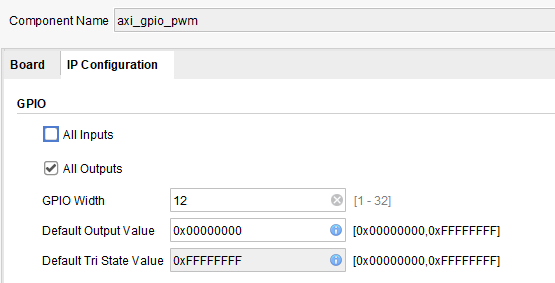

You need 3 additional blocks, Reset, AXI interconnect and AXI GPIO.
The interconnect will interface the protocols beteen PS and PL (beacon_dave  explains it in his post). The Reset is also part of the integration management

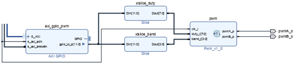

The AXI GPIO is our access to the 12 bit memory location.
From here on, we're back on common ground. Just like in my previous post, we'll use 2 slices to extract the 8 bits for duty cycle and 4 bits for dead time

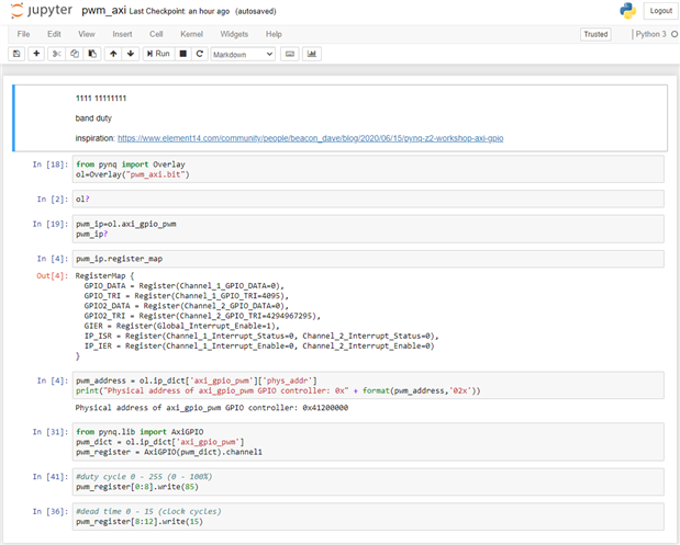

The Python code in the Jupyter book
from pynq import Overlay
ol=Overlay("pwm_axi.bit")
from pynq.lib import AxiGPIO
pwm_dict = ol.ip_dict['axi_gpio_pwm']
pwm_register = AxiGPIO(pwm_dict).channel1
#duty cycle 0 - 255 (0 - 100%)
pwm_register[0:8].write(85)
#dead time 0 - 15 (clock cycles)
pwm_register[8:12].write(15)
Tip: you can set duty cycle and dead time in a single call:
pwm_register[0:12].write(0b100010000000)
