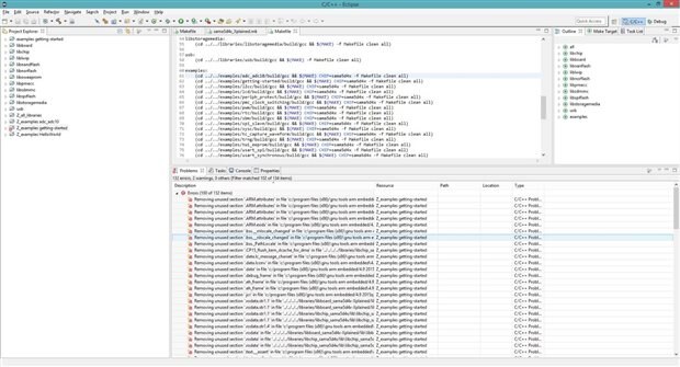

Once I go one step further and try to compile the examples, I get into errors. 132 of them.
Here's the start and end section of my log. The whole output is attached to the blog

That's where I am at the moment. Something tells me I'm close. But then again, maybe not image.
It would be great if you could give me a nod in the right direction.
