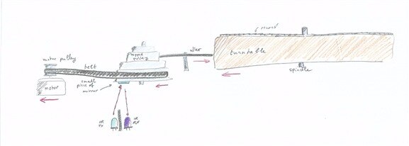

A Perpetuum Ebner turntable from 1958 is controlled by modern technology. Microcontrollers measure the table speed and control the motor.

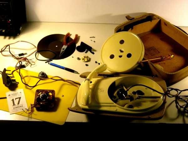

I've turned a defect 1950's treasure into a working turntable - without making a single scratch or permanent change.

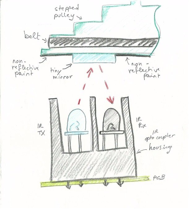

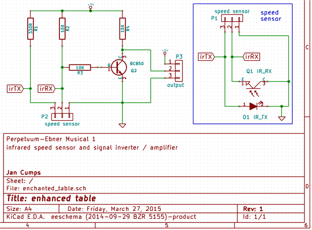

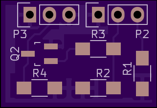

For the speed measurement and motor steering I've made a custom PCB. I added a single transistor pre-amp - an excuse to show that a very simple electronics design can be valuable.
I've made detailed drawings of the design concepts. I've also tried to use graphics to better explain processes and to lighten up the posts.

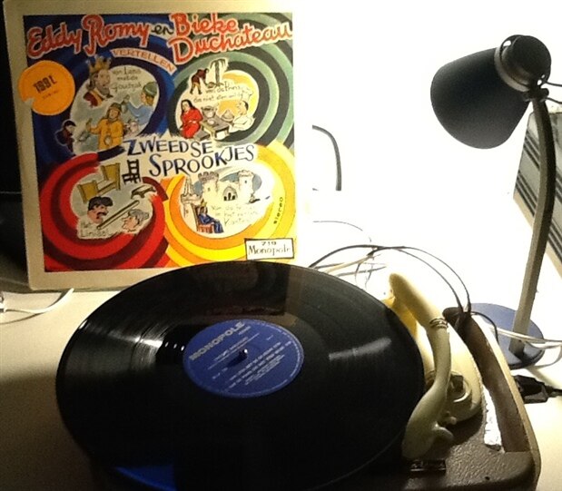

If you want to check how good the turntable actually sounds, check out the video at the top of this post.
The soundbites you hear at the start and end are directly taken from this project; no tricks - no filtering.
You'll hear Eddy Romy telling Swedish Stories (in Dutch image ) from this childhood record (Monopole 719 - Belgium, 1971)

    I love the hand drawn sketches

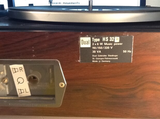

    Regret I have retired my own DUAL turntables now but I guess they are in good hands too! If I can trace back the new owners I would suggest your pages for a "modern up" job ;)
