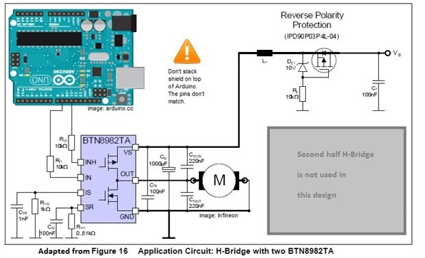

Time for the first electronics post. We're going to drive my turntable motor with the Arduino Uno and the Infineon motor shield.
The Infineon DC Motor Control Shield is connected to the Arduino UNO. The Arduino controls the motor power by sending PWM signals to the shield.

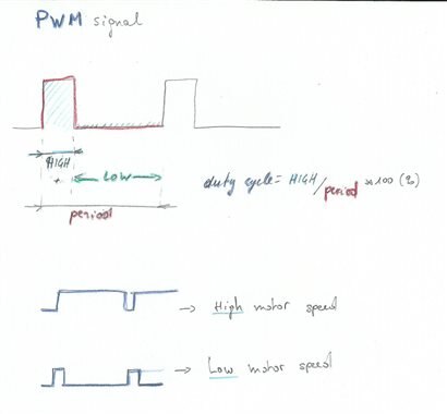

The duty cycle of the PWM defines how much power is going to the motor. I'm using that technique to speed up and slow down the motor.
The signal
The Arduino is generating the PWM signal. When you drive a motor with PWM, it's not the frequency that drives the motor speed, but the duty cycle of the signal.

I define two pins as outputs here:

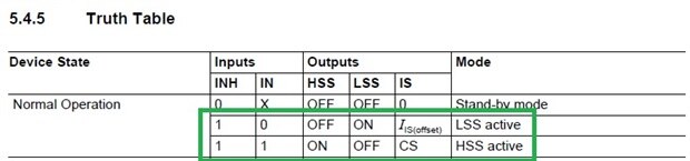

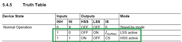

Pin 9 is connected to the half H-Bridge IN port. This is the PWM input that will control how much energy the motor shield sends to the motor.
Pin 11 connects to the half H-Bridge INH port. Driving this one low will stop the motor, whatever we do with pin 9.
Then we tell the library to generate a 33 kHz signal on pin 9, with a duty cycle of 705.
The duty cycle range goes from 0 to 1023. So you have to interpret this 705 as (705/1023)*100 = 68%.
I've chosen 705 because that gives me a correct turntable speed when I supply 10 V to the motor shield.

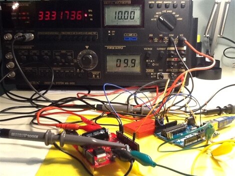

The pictures below show the PWM signal at different duty cycles.
The signal is probed at pin 9 of the Arduino.

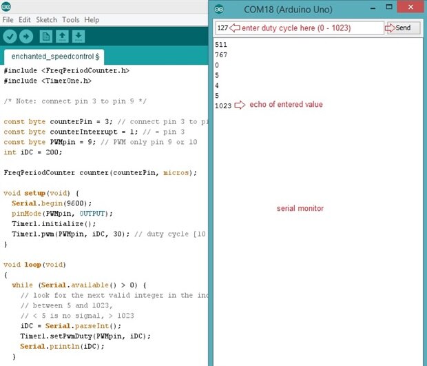

I've extended my sketch to make the duty cycle variable. You can enter a duty cycle in the Arduino IDE serial monitor, and that value is then sent to the Timer1 lib.
void setup(void) {
  Serial.begin(9600);
  Serial.println("Ready for input...");
void loop(void)
  while (Serial.available() > 0) {
    // look for the next valid integer in the incoming serial stream,
    // between 5 and 1023,
    // < 5 is no signal, > 1023
    iDC = Serial.parseInt();
    Timer1.setPwmDuty(PWMpin, iDC);
    Serial.println(iDC);
The setPwmDuty() immediately changes the duty cycle, and alters the motor speed.
This is an ideal test bed to exercise the motor driver design.

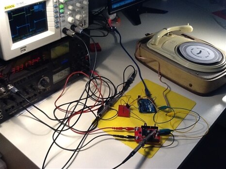

With the firmware ready and everything wired up, let's have a look at some results.
The picture below shows the input and output signal of the shield at a duty cycle of 705 (68%).
The yellow signal is probed at pin 9 of the Arduino. The blue signal is measured at out1 of the shield.
You can see the switching time on the capture. i've highlighted it with the two vertical cursors. I measured 4.40 µs.

The shield doesn't work from 0 to 100%. I've used the test bed to measure the working range in my circuit and with my firmware.
It's dependent on the frequency. The half H-Bridge needs time to switch on and off. So the total period of a PWM signal plays a role in the upper and lower limits.
I hit them around 10% and 86%. You can see that in the captures below.
In each of the captures, the blue signal is the output just outside the working range.
The white signal is a stored signal just within the range.
Lower limitUpper limit
You can see that the output signal flatlines in both situations. The output under 10% is 0 V, above 86% it's the input voltage of the shield (give and take some).
Voila. The motor drive part is finished. I'm now ready to start with the speed detector.
