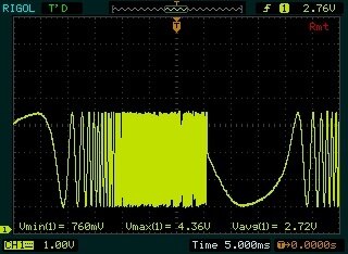

Demo Signal
I used my function generator in sweep mode. It scans the audio band (the human band, not the dog audio band).
You can see the bass, mid and high LEDs switch on when the signal is in range.
My DC offset is a bit high here, 2.7 in stead of 2.5, and the amplitude is on the high side too.
But it's all in the safe range for the microcontroller.
Bass is active around 450 Hz, Mid approx 1400 Hz and High kicks in close to 9 kHz.
