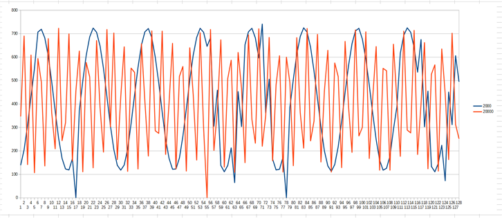

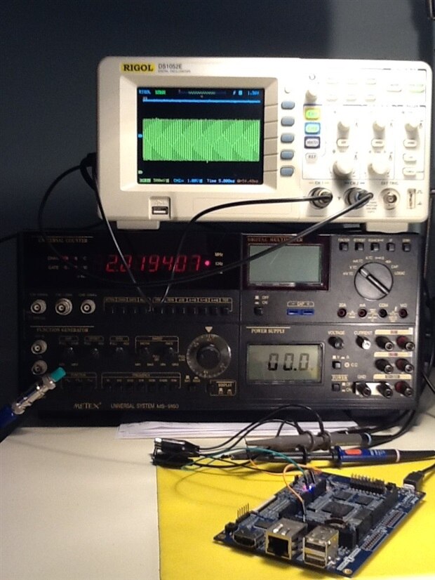

This is my first SAMA5D4 firmware that takes a reasonable sample of audio range signals.
I'm using the ADC buffer mechanism. The converter fills the buffer in the background.
I'm reading the values and log them. Later I'll use them to drive the light organ of the enchanted table.

After that point, the ADC starts filling the buffer - available as character device  /dev/iio:device0.
I then go on and read these 128 samples of the buffer. After that, my code will go to do the light organ work - a topic for the next post.
There's still some dodgy code in my program. My algorithm to read from that character device isn't good.
I do know how to do it properly (I have the c example code from generic_buffer.c available).
I was just hoping that I could simplify that code using a c++ character stream. I just don't seem to be able to use the stream mechanism reliable with a volatile character device yet.
I sometimes receive the two bytes that form my value in reverse order. I know that's me, because the sample code does it just fine. So there's still work to do.

For my light organ however, this sample quality will do.
In the next installment I'll transpose the samples to the -128..127 range.
Then to go through the FFT library, and I'll chop them up in bass, middle and treble...
