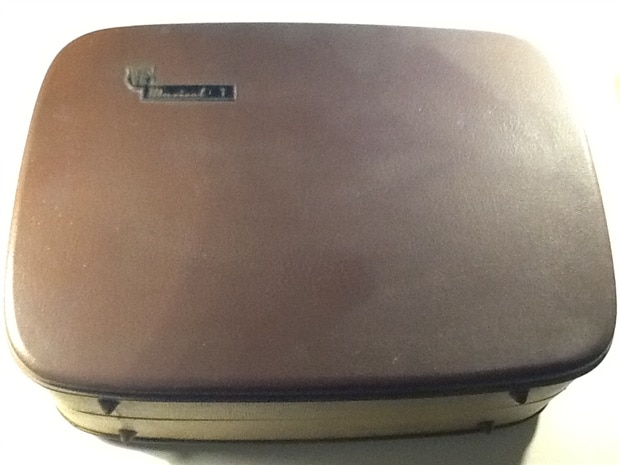

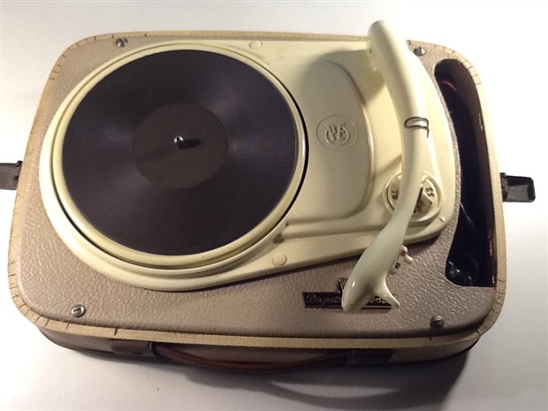

The first chapter is finished.
I started with a defect turntable. It looked good at the start but didn't turn.
It hasn't changed on the outside, but the inside is revamped with latest technology. And it spins!

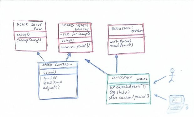

The Firmware
The Arduino UNO that's one of the parts for the challenge has the control duty. The motor control and sensor capture blocks were already written for  the UNO.
In the final firmware design, they appear as the two top blocks. That shouldn't be a surprise, because they are the main touchpoints with the table's mechanics.
And it's those mechanics that we want to control.
The Feedback And Control Block
To make this design do something real, we'll have to tie the two blocks together.
We need feedback from the speed sensor to know how we have to adjust the motor.
We tell the speed control how fast our motor should spin.
The control block has the single duty to learn from the sensor block how fast the actual speed is, and adjust that speed via the motor drive block if necessary.
The control block does that in a neternal control loop.

Supporting Modules
There are two modules to support the turntable drive mechanism:
A user interface, where you can adapt the behavior and ask statistics. This simple serial monitor based front end has only three functions.
  • You can set the desired speed. When you enter a speed, the info is sent to the controller. From now on, the table will aim to stay on that new speed until it is power cycled (you could call this a calibration).
  • You can store the current speed in EEPROM. Once you've set the correct speed and the table is stable, you can tell it to save this setting. This is persistent. When you power up the table the next time, it will read back your stored setting at start-up.
  • There is a status function. The firmware tells the status of the three main blocks: the desired speed of the control block, the measured speed of the sensor, and the current PWM duty cycle of the motor drive block.
The second utility module is the persistence interface. It communicates with the ATMega EEPROM. It stores and reads the desired speed value. Without this tiny block you would have to set the desired speed each time.

Because this is the end of a chapter, and a whole functional block is finished, I'm publishing the full firmware code.
It isn't hard to recognize the blocks and methods from the architectural drawing at the start of this article.

Enough practical design. The table is spinning as it should now. From now on I'll focus on enchantement.
I'm also leaving my own comfort zone behind now. For the next steps I have no clue yet what they will be and how I'm going to build things.
