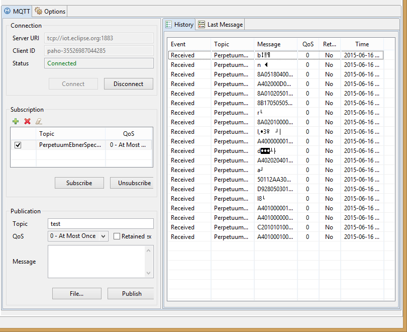

My first bonus design is a remote light organ. I've built it with an Arduino Yún, the Infineon RGB Led Shield and a bunch of LEDs.
Part 1 was my log on the build, and trying out if the Arduino-to-Infineon-toLEDs works.
In part 2, I'm showing off the completed design.
It Didn't Work Just Like That
I had issues getting it to work with a 64 char payload. I have some candidate root causes for that, but it's hard to get to the bottom without debugger (I think it is my mechanism to use a char array as payload).
I spent some time riddling my code with println()s and stared at it for a long time, to no avail. So I took the easy way out.
I've reduced my frequency spectrum bucket array from 64 to 32 buckets. That's enough for my purpose - I want to drive a 16*2 LCD in Bonus 2, and 32 data points will be enough..
This video shows the action. Appreciate the huge delay that I have image This is nowhere near to real time light effects.
The next design challenge I promise to spend more time in sound programming and performance. This time I only spent time in getting things working somehow.
Why don't you improve my code? It's all here.
I bet I'm off where I'm reverting the 64 bucket list to smaller on the server, and again when I'm reading that same bucket list on the client.
Go ahead and slam those bugs in my face. That's how I learn.
