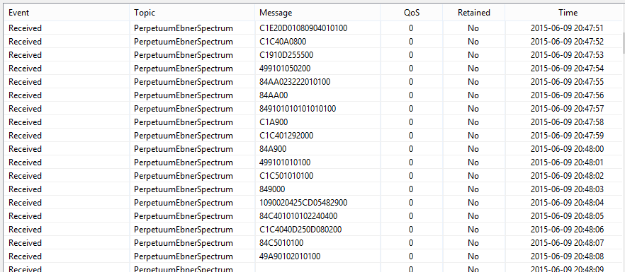

And now that the table is publishing data to the cloud, it's officially a Thing.

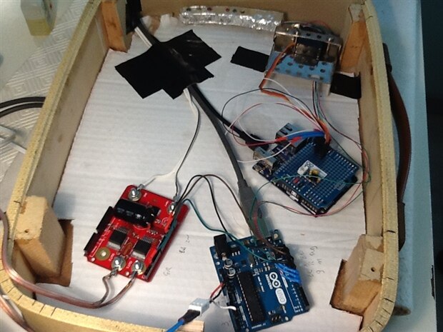

What's Built into the Table
There are two Arduinos -Yún and UNO, the Infineon Motor Shield and various electronics.

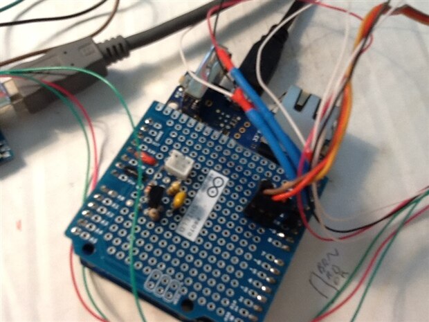

The Yún has audio sample, light organ+servo lift, and MQTT publishing duty.
The protoboard on top of the Yún has a one transistor pre-amplifier + DC biaser. The duty of that little circuit is to push the AC audio into the 0->5V range of the Arduino ADC.
It also holds the connectors for the stepper motor and the light organ LEDs.

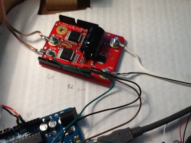

The UNO serves as motor speed controller. It measures the speed from the IR optocoupler that I've built for this project.
The UNO uses the Infineon Motor Shield to control the motor, and also shows what's happening on 3 LEDs (fast - on speed -slow).
Everything runs now, and the Perpetuum Ebner is happily sharing the spectrum analysis on the internet.

And I can also spend a sunny warm evening outside to finalize the mounting of the devices on the sub-chassis.
As you can see on the photo below, there's room for (invisible) improvement there.

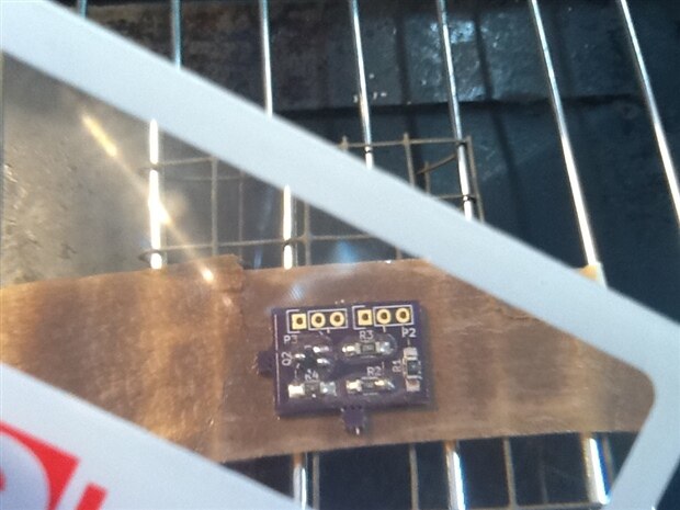

    Back to 80's through hole soldering with the iron from my schooldays:
