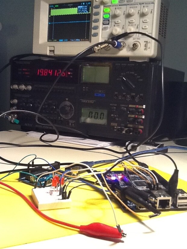

Now that I have my SAMA5D4 development chain under control, it's time to do something with it.
My first attempt is to move the Genuino sketch made for my light organ to the SAMA5D4.
The design has 4 main steps: sampling, applying a Hamming window function, performing a FFT, drive leds
Moving C++ code from one environment to another is straightforward. In essence, the only thing I had to do is switch out the Arduino analogread() and digitalwrite() functions for the SAMA5D4 counterparts.
This is such a boring exercise that I'm not going to blog about it.
Partly Success
The porting exercise went really smooth. My code passed the build in less than an hour. When I ran it on the board, the results were promising.
The sampling worked, and the LEDS were flashing.
But the code failed in a part that I didn't expect: the signal processing part.
I did not get a led pattern that was consistent with the Arduino. Even if I applied a single sinus, all 3 leds were flashing.
With a light organ,you expect that the high led is dim when you apply a low frequency input. On my SAMA5D4, the 3 leds were flashing in a pattern, whatever frequency I applied to the input.

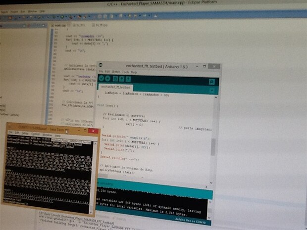

Debug Time
So it's time to debug. The symptoms point to an issue with the signal processing. So I created a testbed on both systems that just do that.
I give the program a fixed array with samples (the same array on both boards).
Then I check the output after the Hamming function and after the FFT.
Here's a subset of the SAMA5D4 output:
samada fixed sample string:
samples :
0,7,14,21,28,35,42,49,56,63,70,77,84,91,98,105,112,119,126,-123,-116,-109,-102,-95,-88,-81,-74,-67,...
window :
0,0,0,0,0,0,0,1,2,3,4,5,7,9,11,13,16,19,23,-25,-26,-26,-27,-27,-27,-27,-26,-25,-24,-22,-20,-18,-16,-13,-9,-6,-2...
fft :
1,1,1,1,1,1,1,1,1,1,1,1,1,1,1,1,1,1,1,1,1,1,1,1,1,1,1,1,1,1,1,1,1,1,1,1,1,1,1,1,1,1,1,1,1,1,1,1,1,1,1,1,1,1,1,1,1,1,1,1,1,1,1,1,
And this is the known good result from the Arduino:
Arduino fixed sample string
samples
window
fft
9,1,17,226,34,1,26,82,16,9,17,49,2,10,17,5,5,5,13,2,4,13,5,2,2,9,2,1,4,5,1,4,4,1,1,5,1,2,0,5,5,1,2,1,2,1,4,0,4,1,1,5,1,4,1,4,13,2,0,1,5,1,1,1,
It's obvious, isn't it? My port from the FFT lib from Arduino to SAMA5D4 has issues.
I'll spend some quality time to see where I made mistakes in the port of that FFT lib. I'll post my findings in a next blog.

      cout << salida[i] << ","; // this was the biggest mistake. I had a '1' where I should have put an 'i', hard to spot the difference
    cout << "\n";
    break;  // this MUST be removed!!!!!!!!!!!!!!!!!!!!!!!!!!!

    Jan Cumps over 11 years ago in reply to Workshopshed +2
    My biggest mistake was an extremely silly one: I had cout << salida[ 1 ] instead of cout << salida[i] . So the console always showed the second element of the array. And that's a one. 4 hours of debugging…
    Jan Cumps over 11 years ago in reply to Workshopshed +1
    I'm a little closer. I know that my lookups are good. The FFT does the same calcs and lookups in Arduino and SAMA5D4. It seems that the issue is with returning the resulting array:

    THe original source for the Light Organ is an Arduino sketch that I used unchanged in my project: 1958 Turntable from the Black Forest - 8: Digital Light Organ Enchantment
    Now that I'm porting it to the SAMA5D4, I leave as much of the code untouched.
    That makes it easier to compare the working Arduino version and the WIP SAMA... Version.
    ANd I can read Spanish image, so no issue for @self.
    I had cout << salida[1]  instead of cout << salida[i]. So the console always showed the second element of the array. And that's a one.
    4 hours of debugging before I spotted it.
    I found some other smaller issues - related to switching from char to int - while digging deep inside the fft lib. So it was not for nothing.
    Jan Cumps over 11 years ago in reply to Jan Cumps
    Success !!
